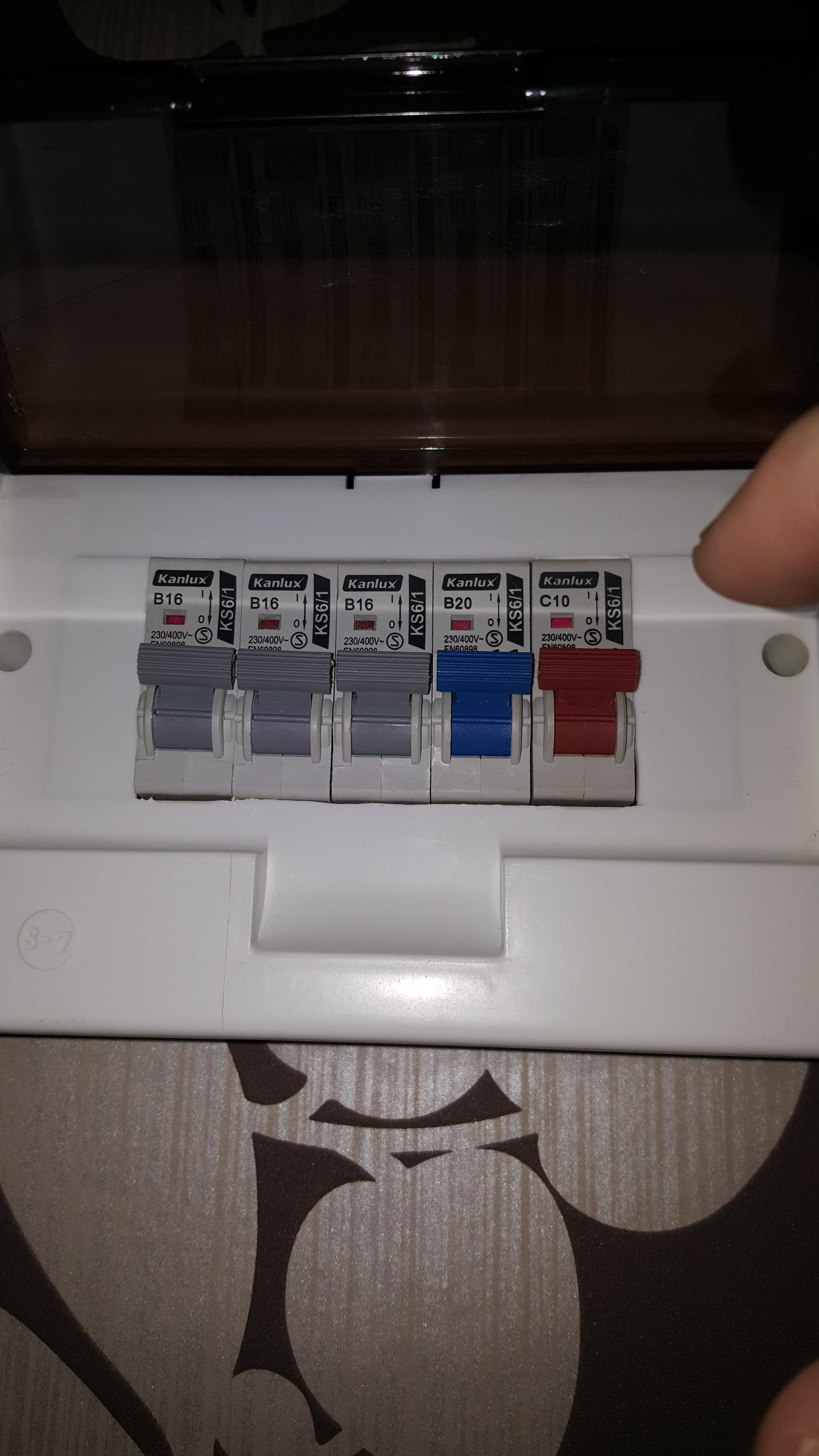

    Hello, I have such a can at home.
    Probably this is one phase and I would like to connect the induction to an ordinary socket if it is possible. Connecting Induction Hob to a 230V Single Phase Outlet: Steps and Compatibility20170321_1..643.jpg (1.01 MB)You must be logged in to download this attachment.

    Not enough data. What power allocation, What board power, what is the installation made of (Cu, Al)?
    The board should have a separate circuit.

    Total connected load: 7.4 kW
    2 years ago, a new installation in the block was made, all cables were pulled new, so CU

    With these safeguards, absolutely not.

    For single-phase power, let go of the induction.
    Get interested in gas, but not necessarily the stove you have proposed.
    I propose to find out more in the household appliances section, because from what I read this company does not enjoy a good reputation among installers.

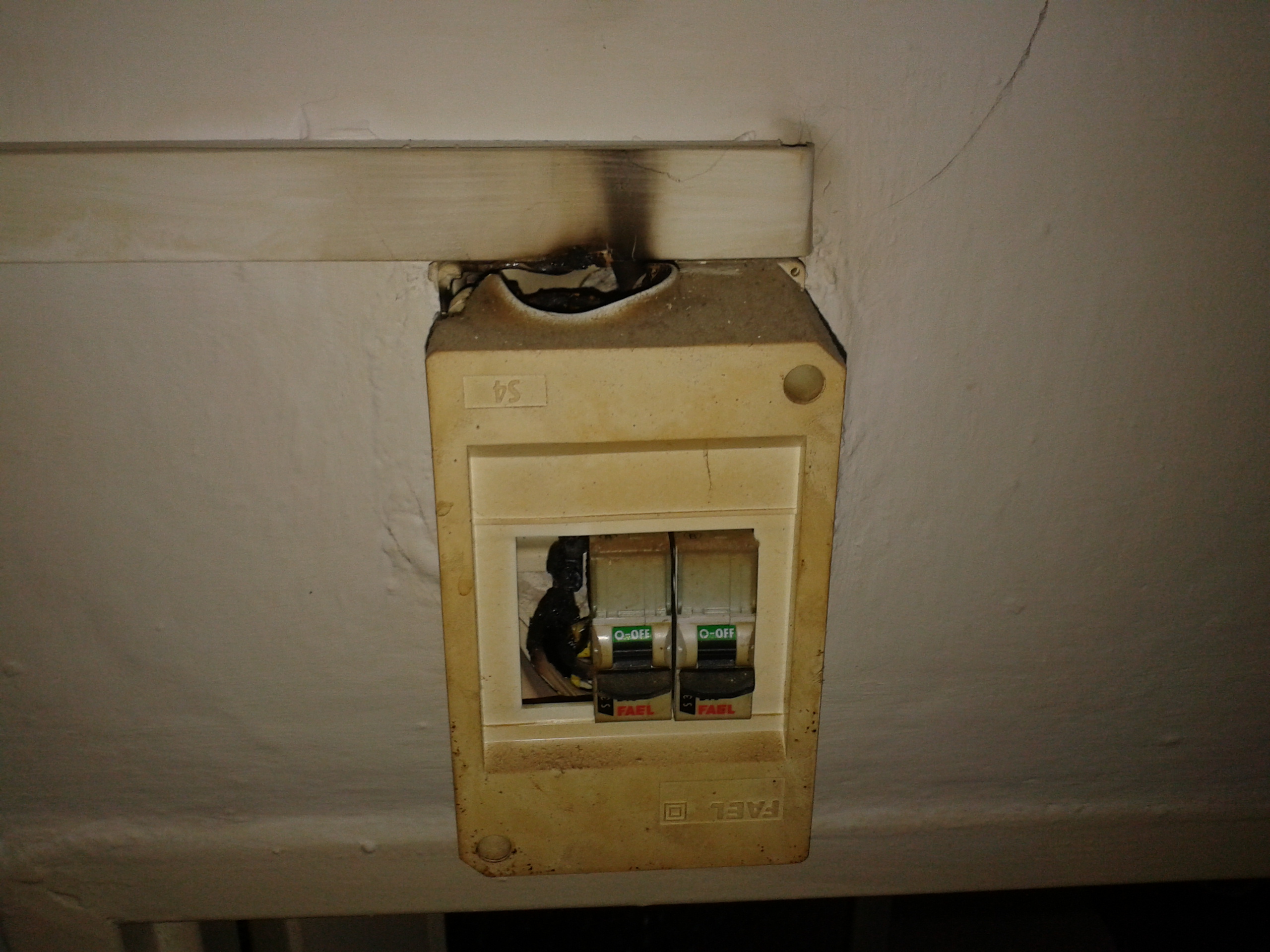

    Then you go to breakdowns, where sockets and switchgear housings drip onto the floor.
    Connecting Induction Hob to a 230V Single Phase Outlet: Steps and Compatibility Connecting Induction Hob to a 230V Single Phase Outlet: Steps and Compatibility Connecting Induction Hob to a 230V Single Phase Outlet: Steps and Compatibility Connecting Induction Hob to a 230V Single Phase Outlet: Steps and Compatibility
