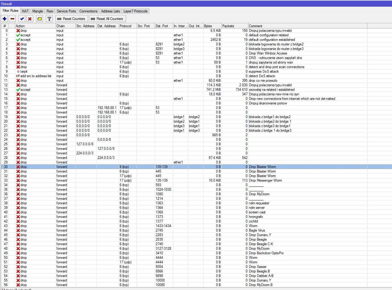

    I warmly welcome,
    A few months ago I bought a Mikrotik router, it took some time for me before I could even make the internet work.
    I want to know if I did everything right to secure the router (Firewall), if there are any errors, etc.
    In the skin:
    I have 3 networks: the first 192.168.88.1 (my network, it includes a cast or ether1,2,3,4,5), the second is a wifi network for parents 192.168.2.1 and the third one also for them 192.168.3.1
    Nowadays, in the era of all bactracków, kali linuxów, metasploitów, it may be relatively easy to get the password despite WPA2 encryption with the 60th aes password if you are not attentive.
    Legend:
    Ether1 = WAN port
    Bridge1 = ether2,3,4,5
    Bridge 2 = wlan1,2
    Bridge3 = wlan3
    Firewall appearance in the attachment:
    https://obrazki.elektroda.pl/6331470700_1490190537.jpg
    I have everything disconnected from IP services except for winbox, in services ports everything is also disconnected.
    In general, I care about network security so that no one can overhear it, check even if computers are working, etc.
    And finally the question is, is it wise to turn off ping-pong reply?
    /ip firewall filter add chain=input protocol=icmp action=drop in-interface=ether1

    mikrotik wrote:
    is it wise to turn off the ping answer?
    Wisely - from a security point
    Unwise - for diagnostics
    Bet winbox on another high port, e.g. 46831, the default rule is DROP, all other port / protocols should be allowed in writing.
    How do you have access to MT from winbox z z neta to
    - cut ip-blocks from outside PL
    - password: 18 characters,
  • High Winbox port does not prevent port scanning

    mikrotik
    Could you develop this? What diagnostics?
    And what will it give me? It's easy to get around this by scanning the ports. In the firewall I have DropWanWinboxAccess on port 8291 from WAN and I already had a dozen or so attempts detected and it was not a bot, now is the peace of mind for how long.
    I do not have access to the net, at least it seems to me that if I added 5 rule to Firewall (see photo), I turned off the possibility of logging in. Yes? Currently, I can log into mikrotika only with a cable, at least I think so that I managed to do it and there is no gap.
    I have a 8-character password, I will change it for longer.
    And adding this rule with ping I will be deprived of the possibility to log into the router?

    Ping to ICMP proto, login is tcp, so ping does not affect services like ssh / www / winbox.
    It depends on what you will be hosting in MT, it is easy to check the ping - i.e. there is an IP overhead than the www / winbox service.
    Input chain; too much drop; there should be many allow first and then one at the end of 'drop everything'
    for example, INPUT, in order
    - allow all established
    - allow all related
    - allow new winbox eth1
    - allow DNS from ether *
    - allow DHCP from ether *
    - drop everything

    mikrotik
    It depends on what you'll be hosting in MT
    I do not know if I completely understand the question, but when it comes to some ftp or sharing files with other household members, it's absolutely NOTHING of these things.
    - allow all related
    - drop everything
    Why, in this case, I can log in to mikrotik at all, since before the rule 11 "drop everything" there is nowhere to allow access to router from ether2 etc.?
    From what I see, you let go, you block everything else, and I think I have the opposite, blocks selected ones, I release everything else ... and I do not want to ...
    A colleague from another forum wrote a firewall for me, for my needs.
    Ja bym to widział tak:
    /ip firewall filter
    # najpierw INPUTy.
    add chain=input comment="Zezwalaj na established i related" connection-state=established,related
    add action=drop chain=input comment="Dropuj polaczenia typu invalid" connection-state=invalid
    add action=drop chain=input comment="Dropuj zapytania DNS od strony WAN" dst-port=53 in-interface=ether1 protocol=udp //Chociaż u Ciebie jest zbędne, bo z tego co widzę nie używasz DNS-Cache.
    add action=drop chain=input in-interface=ether1 // ja bym tego nie stosował, bo pozbawisz się możliwości pingowania na zew z routera, traceroutów, pobierania aktualizacji MT itd. Jeżeli wszystkie usługi masz wyłączone, to nie widzę sensu robienia blokady na inpucie na wszystko.

    W IP->Services widzę masz wyłączone wszystko poza winboxem. W ustawieniach tego wpisu ustal sobie z jakich adresów IP możesz mieć dostęp.
    Upewnij się jeszcze, że SNMP masz wyłączone jeżeli nie potrzebujesz (IP->SNMP)
    And I have a question about what he wrote here "add action = drop chain = input in-interface = ether1 // I would not use it, because you will not be able to ping from the router, tracerouts, download MT updates, etc. If you have all the services turned off, I do not see the point of making a lock on an injection for everything. "
    Why in this case, having this rule as 11, I can still download the update, etc.
