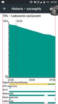

    My phone does not charge, but rather charges, but at completely random moments, usually not when it should.
    For example, at night from Tuesday to Wednesday, it did not charge, the battery level dropped (same from Wednesday to Thursday, but less drastically, I attach a screen). On Wednesday at school, I plugged into every outlet and the phone was charging at absolutely random times. In one lesson, the battery level increased by as much as 27%, and in the next two lessons it fell again (unfortunately I do not have skrins from that day, but the chart was top and bottom).
    It is not the charger's fault, another phone has charged very quickly, and other chargers have no effect.
    What can cause a problem? Battery, usb socket, phone itself?

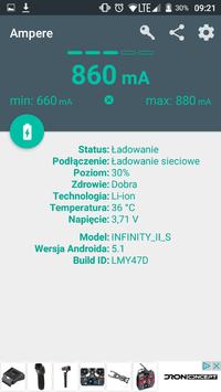

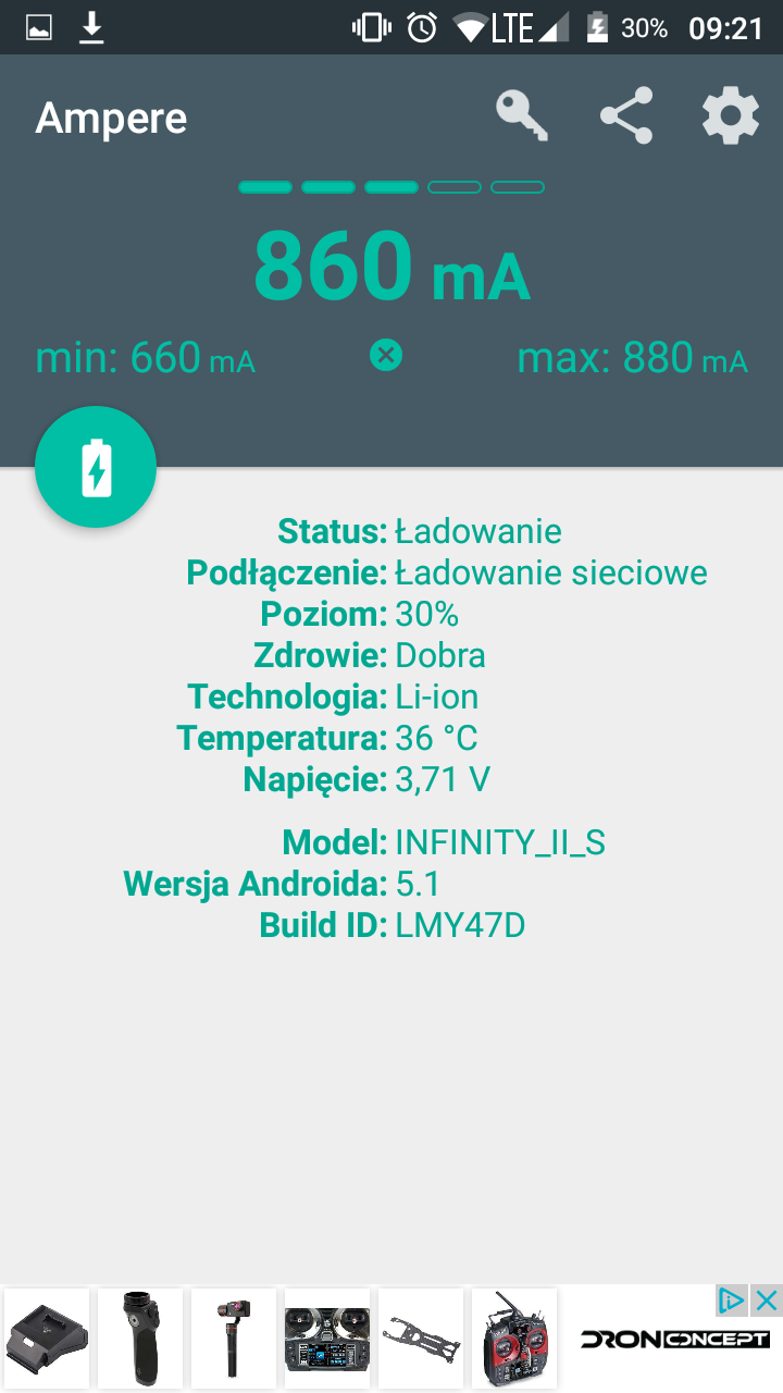

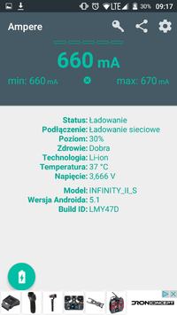

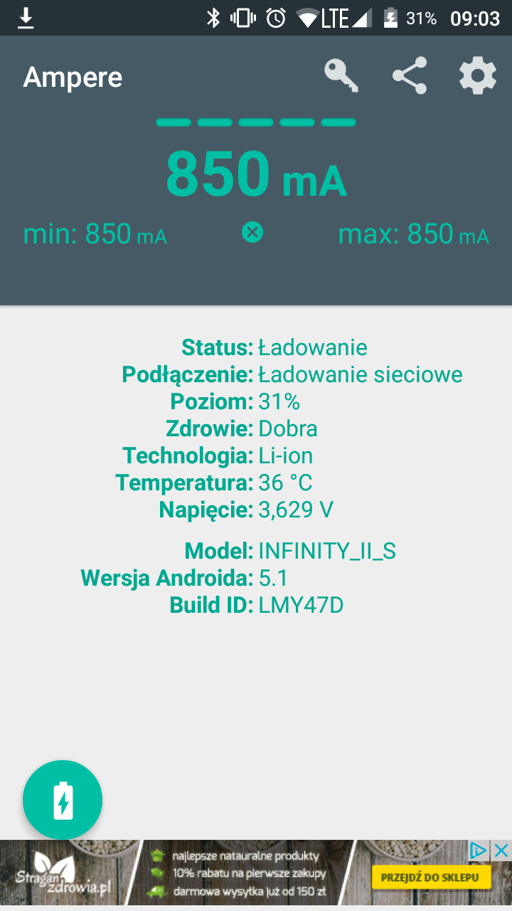

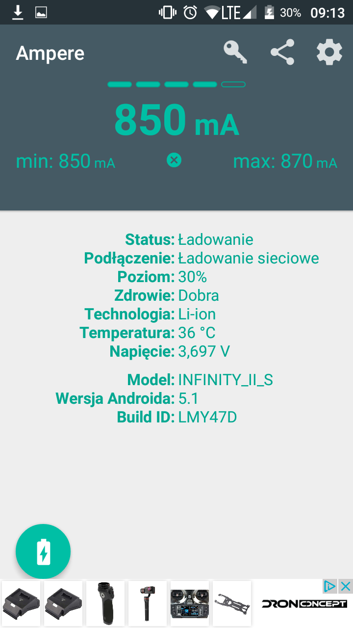

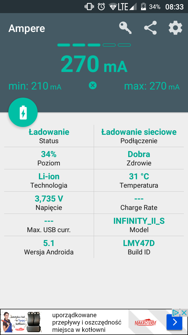

    Actually, I forgot to add skrins (I hope it will come out now, because it will be a little bit, I have a lot of cables and adapters, of course I will not test everything because it is senseless, millions of combinations come out).
    This is a "loading" screen
    MyPhone INFINITY IIS Charging Issues: Random Charging Moments, Battery Level Fluctuations
    After downloading ampere, I tested the factory charger first (1A)
    Then I used an old Nokia charger that has no split between cable and adapter (1.2A)
    Combination of the original adapter + unspecified cable
    Combination of unspecified adapter (1.1A) + original cable
    Combination of unspecified adapter + unspecified cable
    Out of curiosity, I checked the same on another phone - in the case of the Nokia charger and the factory set, the results were completely different, while the rest rather coincided.
    Of course, I do not need to add that the battery did not charge at all during these tests.

    Where you had over 800mA there is no whip the phone is charging. It is clear that there is something wrong with the factory, I suspect the cable. 270mA is not enough and over 600mA I think it can also be on the border, so if you don't use it, it should slowly charge.
  • #5 16370057
    Niemampomyslunanazwe
    Well, here is the problem, because I use this set which gives me over 800 and so from about 10.00 is 41% and does not go up (I did not use the phone).

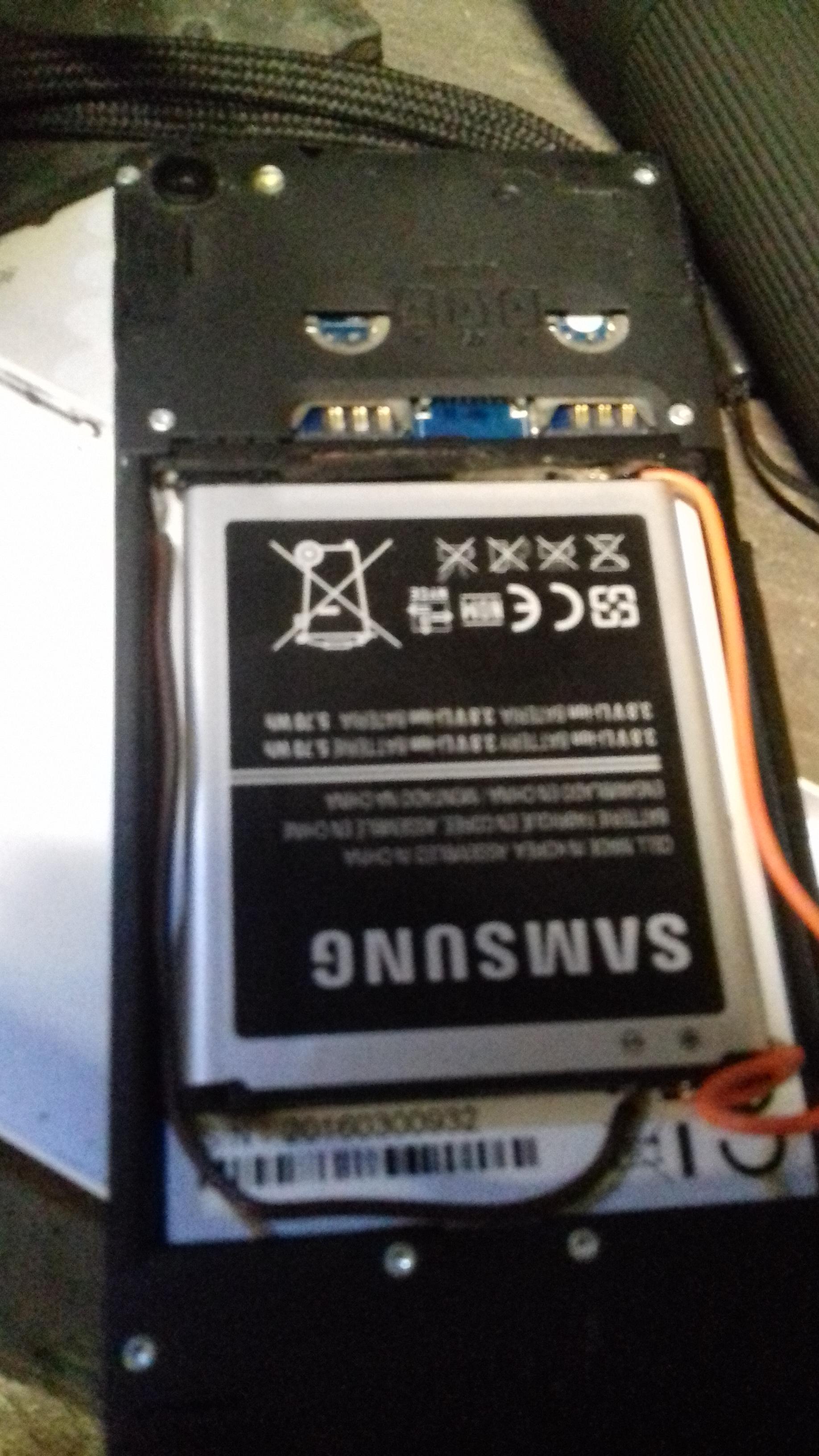

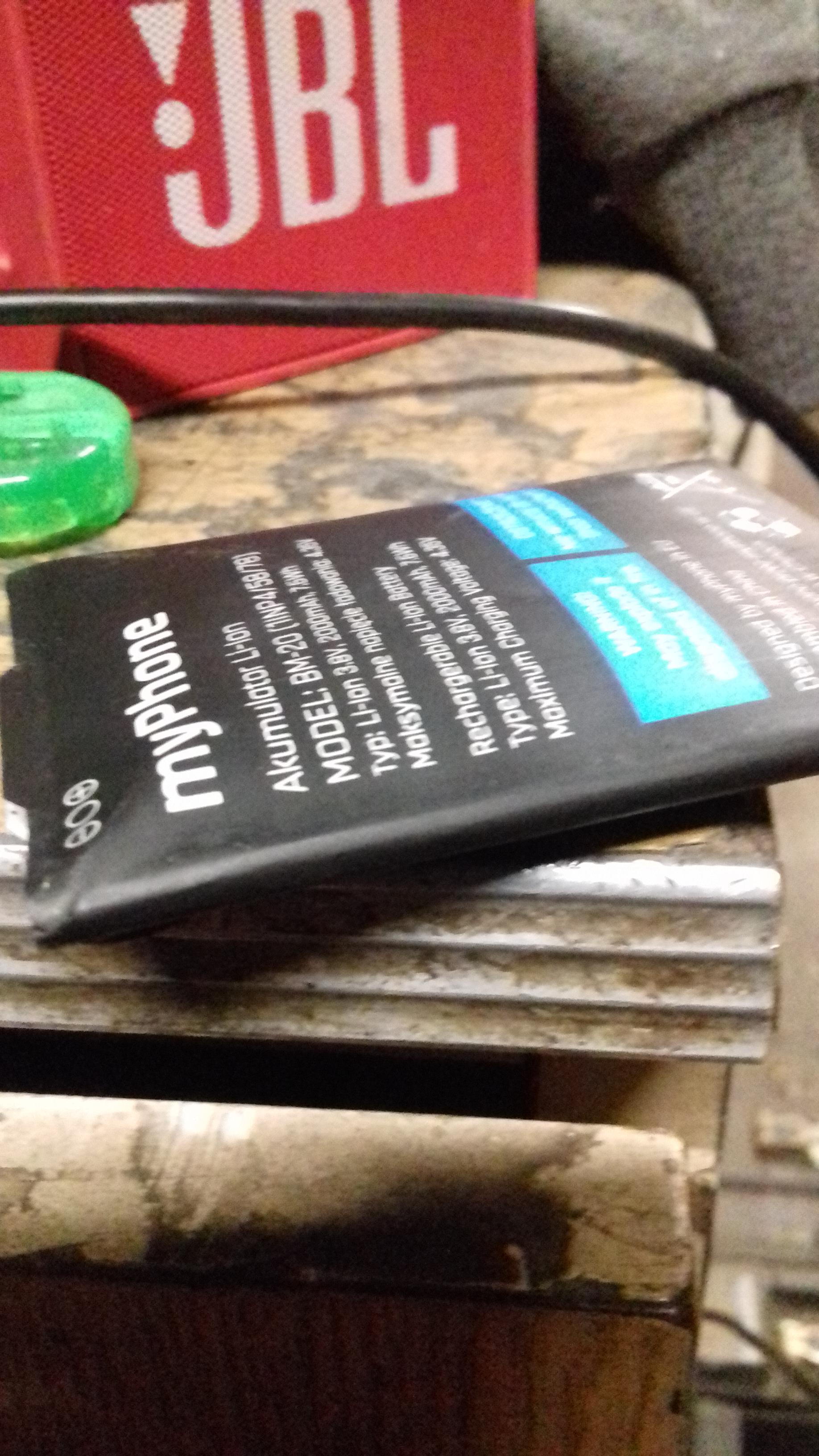

    One hundred percent faulty battery. The best part is that you won't buy it anywhere at the moment. I combined with a battery from some Samsung as in the attachment. At the beginning the original battery gave similar symptoms and later it swelled like a balloon.
    • MyPhone INFINITY IIS Charging Issues: Random Charging Moments, Battery Level Fluctuations 15129363629821417893604.jpg (653.25 KB) You must be logged in to download this attachment.
    • MyPhone INFINITY IIS Charging Issues: Random Charging Moments, Battery Level Fluctuations 1512936313195444221377.jpg (609.68 KB) You must be logged in to download this attachment.
