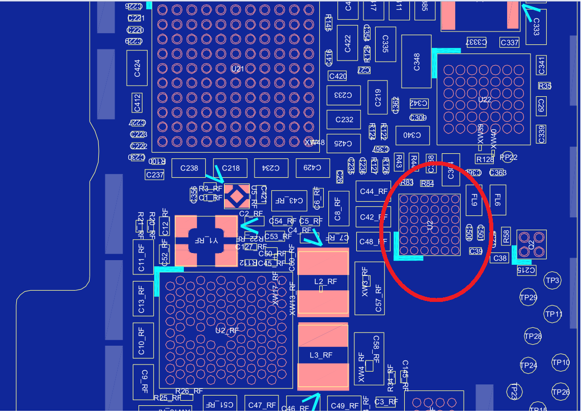

    I have a problem with my iphone 5s, when I connect it to the charger, lightning appears for 3 seconds, then it disappears, when it discharges to the end, it charges when turned off, and when it is automatically turned on, it stops again and again.
    And now the question is, is there an option to charge this iPhone to 100% on a turned off phone? Will the phone turn on every time the battery reaches a certain limit?

    Eureka, I plugged in the cable and charger from a friend, and he whizzes. it just seems a little slower to load. Would you recommend a store with ORIGINAL cables?

    As for the Magboss store. As for your phone's condition, clean the charging port properly or replace it.

    Iphone 5s - Iphone 5s stopped charging, charging only off to 1-3%
    Niewiemsry wrote:
    Eureka, I plugged in the cable and charger from a friend, and he swims. it just seems a little slower to load.
    The problem may lie in the "u2" charging circuit. It is damaged when connecting the phone to a poor-quality wall charger or a Chinese car charger. I encountered a situation where the phone did not charge on the original cable and it charged without any problems on the cable for PLN 2, the problems were of a different nature but the charging system was to be replaced.
    Your description perfectly matches the failure of this chip.
