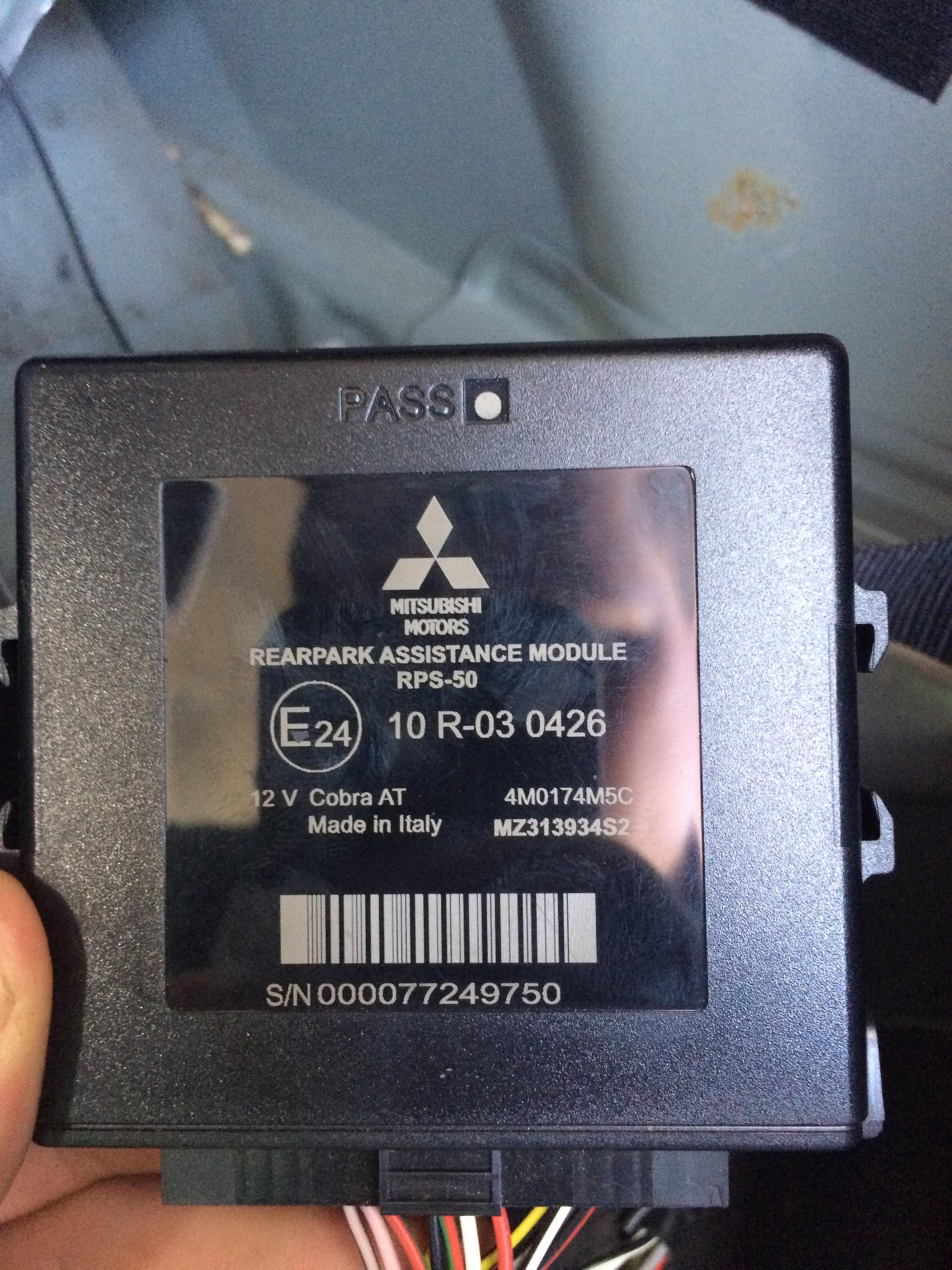

    I bought a Mitsubishi Outlander II i
    I have a problem with the reverse sensor.
    The sensors in the rear bumper are mounted and all wires are connected and the wiring harness is connected to the switchboard shown in the photo. One black wire is connected to ground (car body)
    And wire # 1 with fuse and # 2 black and red wires are disconnected.
    I am asking for help how and where to connect these sensors to make them work.

    It is rather not original but made with a logo.
    Fuse for reverse light and these two for buzzer / loudspeaker.

    Thanks a lot.
    IT WORKS
