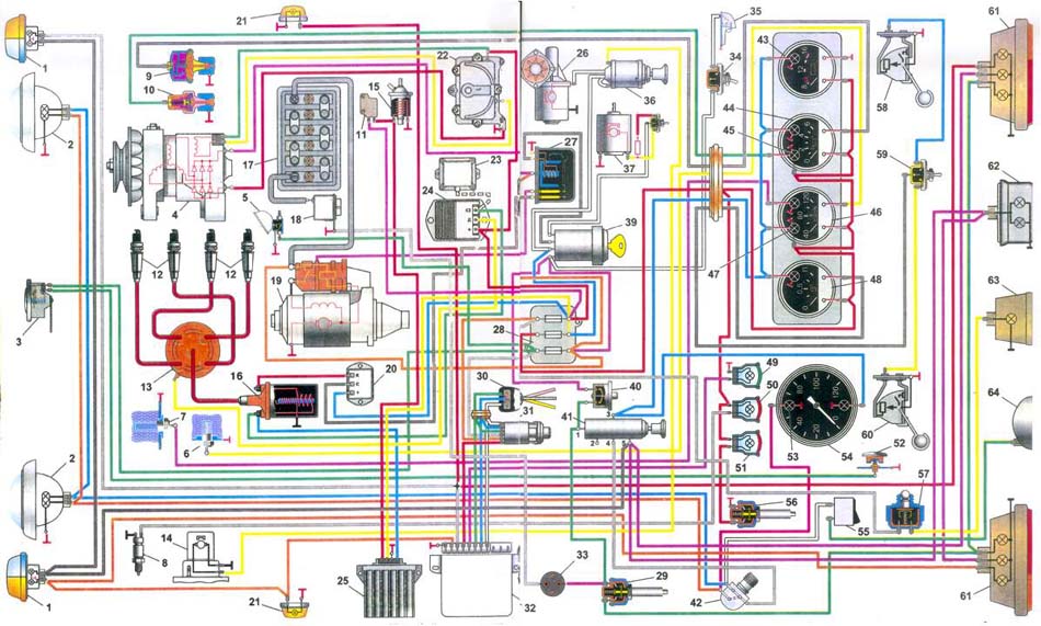

    I am looking for a graphic diagram of the electrical installation {could be a drawing, photo etc.} for the Nissan Terrano II.
    I need to fix a few things in the car, above all: lights, horn, radio.
    Unfortunately, two left hands were burying by the car before, making a revolution.
    I kindly ask you to share or direct where and how to get such a scheme.
    I attach, for example, the Uaza installation scheme, Something very helpful once broke the working hour scheme and the problem was solved.
