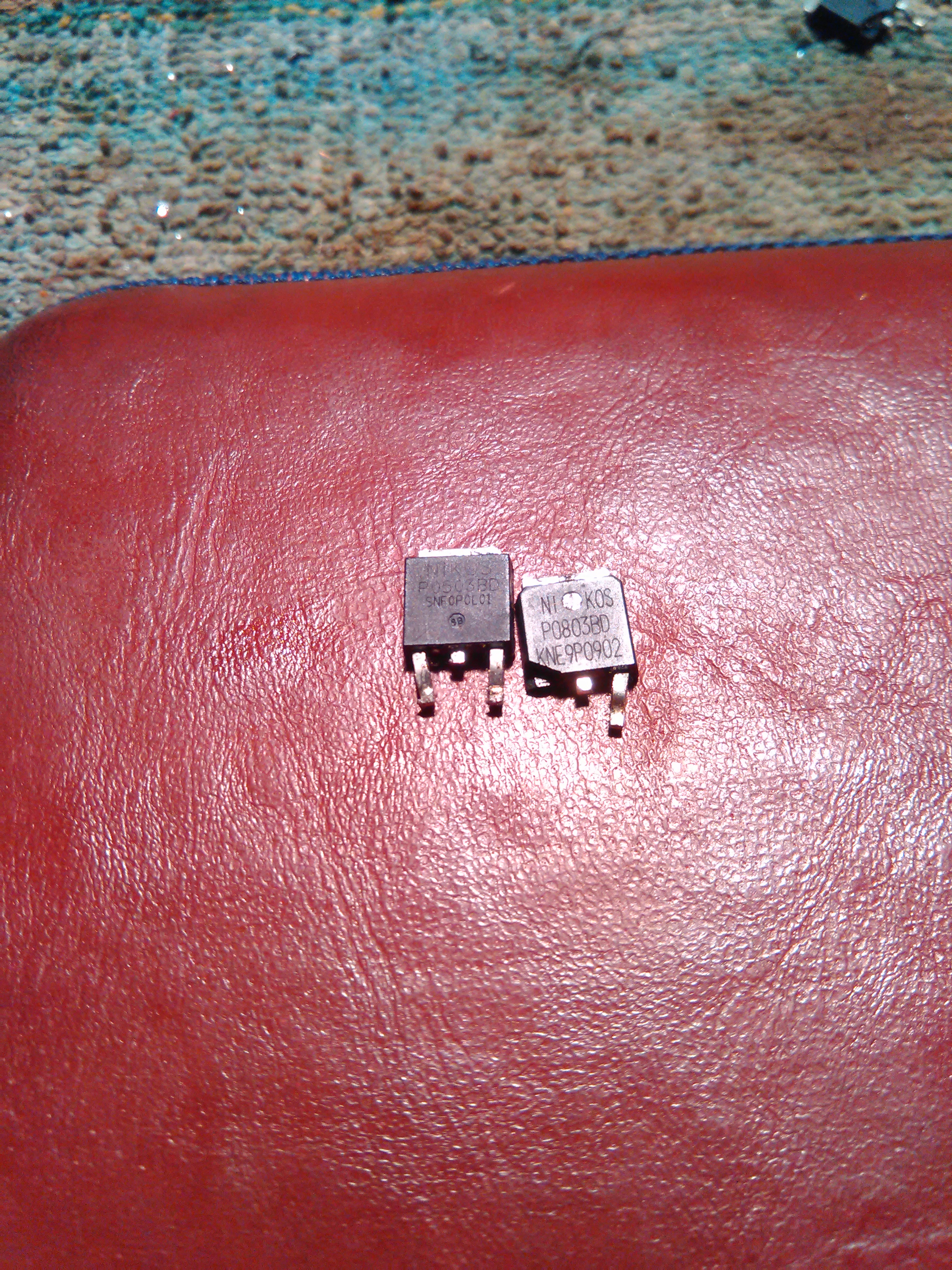

    Hello. I have a motherboard from a MSI Z77-G43 desktop computer with short-circuited NIKOS transistors:
    P0803BD
    P0503BD

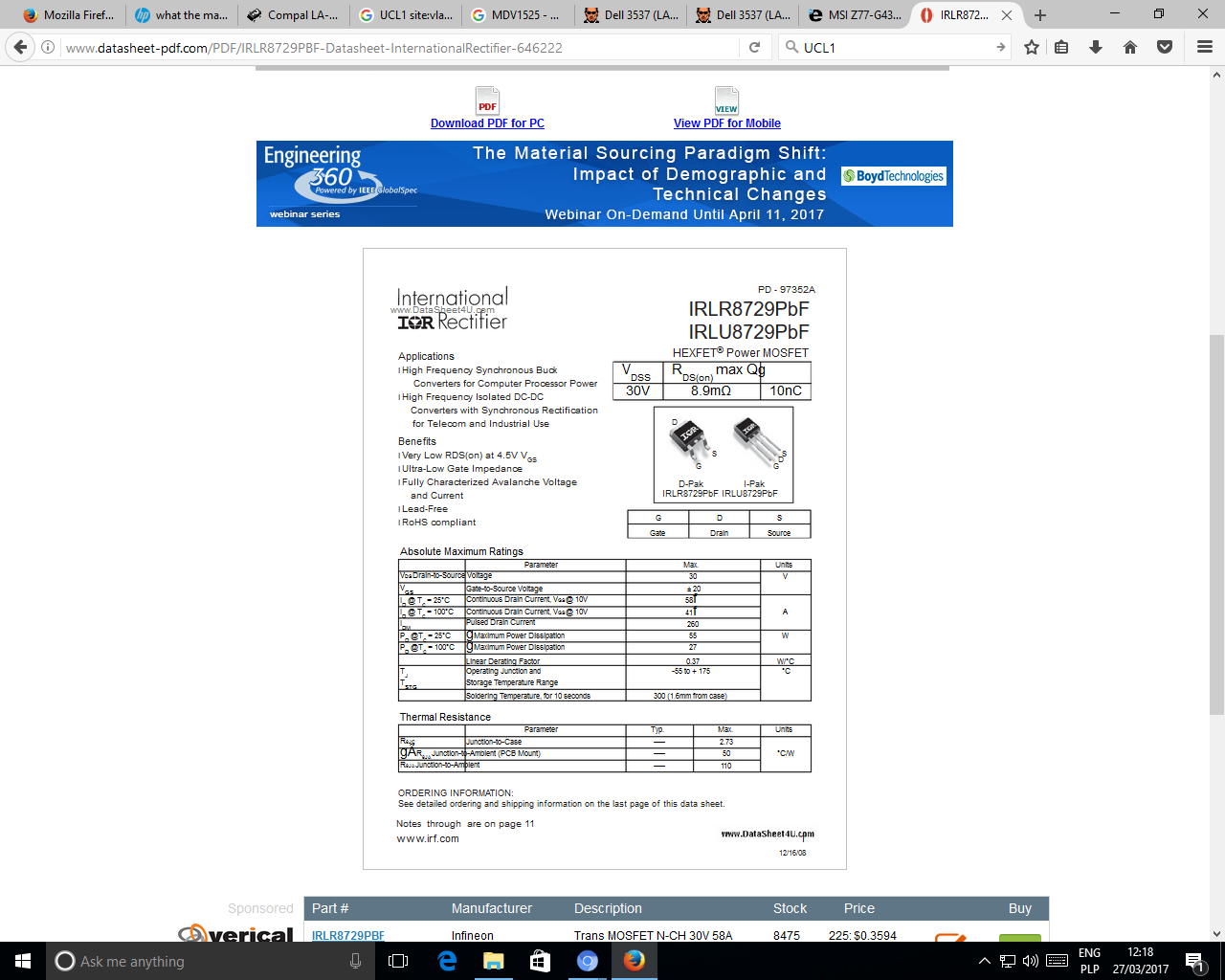

    I found a counterpart to the first one
    IRFR 3707Z or IRLR 8729PBF, unfortunately, it is difficult to find a datasheet for the second (P0503BD). I found a description like this:
    VDS (V) 30V
    VGS (+ -) 20V
    ID (A) 55
    RDS (on) 5.8 m?
    VGS (th) max 7.8
    Qg (nC) 3
    Qgd (nC) 1780
    I found as a replacement:
    JPB055N03LG but I don't know if it would be appropriate. I am asking for any suggestions or proposals for another replacement.
    I have one more question, while desoldering (then I have a hot aira with an ordinary soldering iron) I damaged the legs on four transistors and I do not know whether to replace only these or the entire section (the rest in the transistors section).
    Thank you in advance for each answer.

    For the latter, in my opinion, a good IRFR3707ZPBF would be

    IRFR3707ZPBF No >> Has too much Rds, almost 2x as the original.
    * "works as" heater "
    For example datasheet of the popular 50N03, 55N03 Link
    - good RDS and other parameters
    - an important field parameter taken into account when replacing it
    Input Capacitance Ciss
    Output Capacitance Coss
    These field Nikos stand on MSI plates

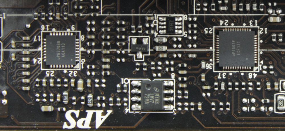

    -or in a dc-dc converter (4 + 1 phase) on the UT501, UT501p CPU power driver
    * UP1625P chip (uP1625P) / for 2 phases UP6282
    * 2x P0503BD in the upper branch and 1x ?0803BD in the lower branch

    As you mention in the field phase> change all: 2x P0503BD and ?0803BD
    - so that there are no "surprises"
    -measure half of the remaining phases

    Important RDS parameter, from datashhet IRL8729
    MSI Z77-G43 - Request to identify and replace MOSFET transistors.
    May be.

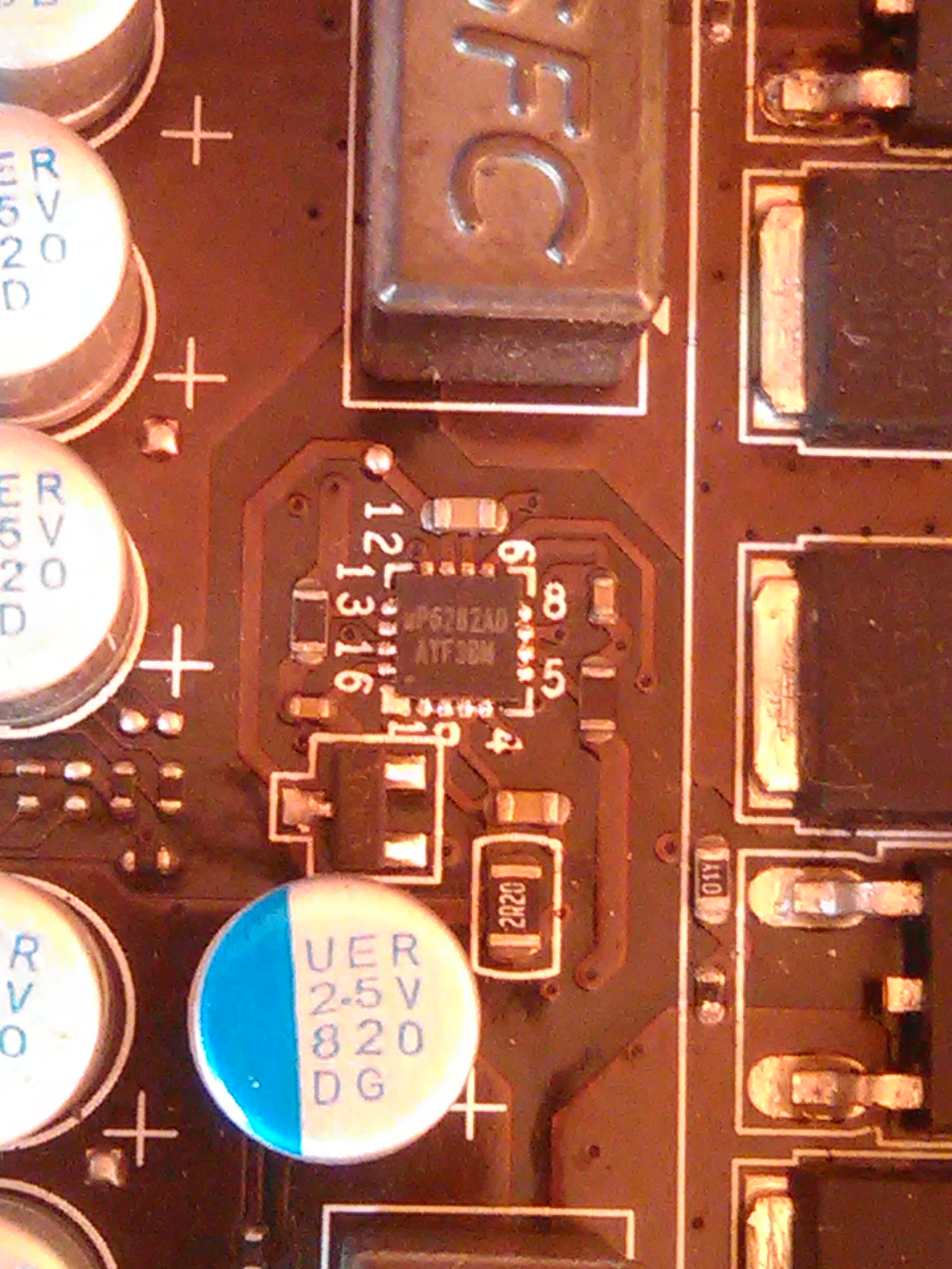

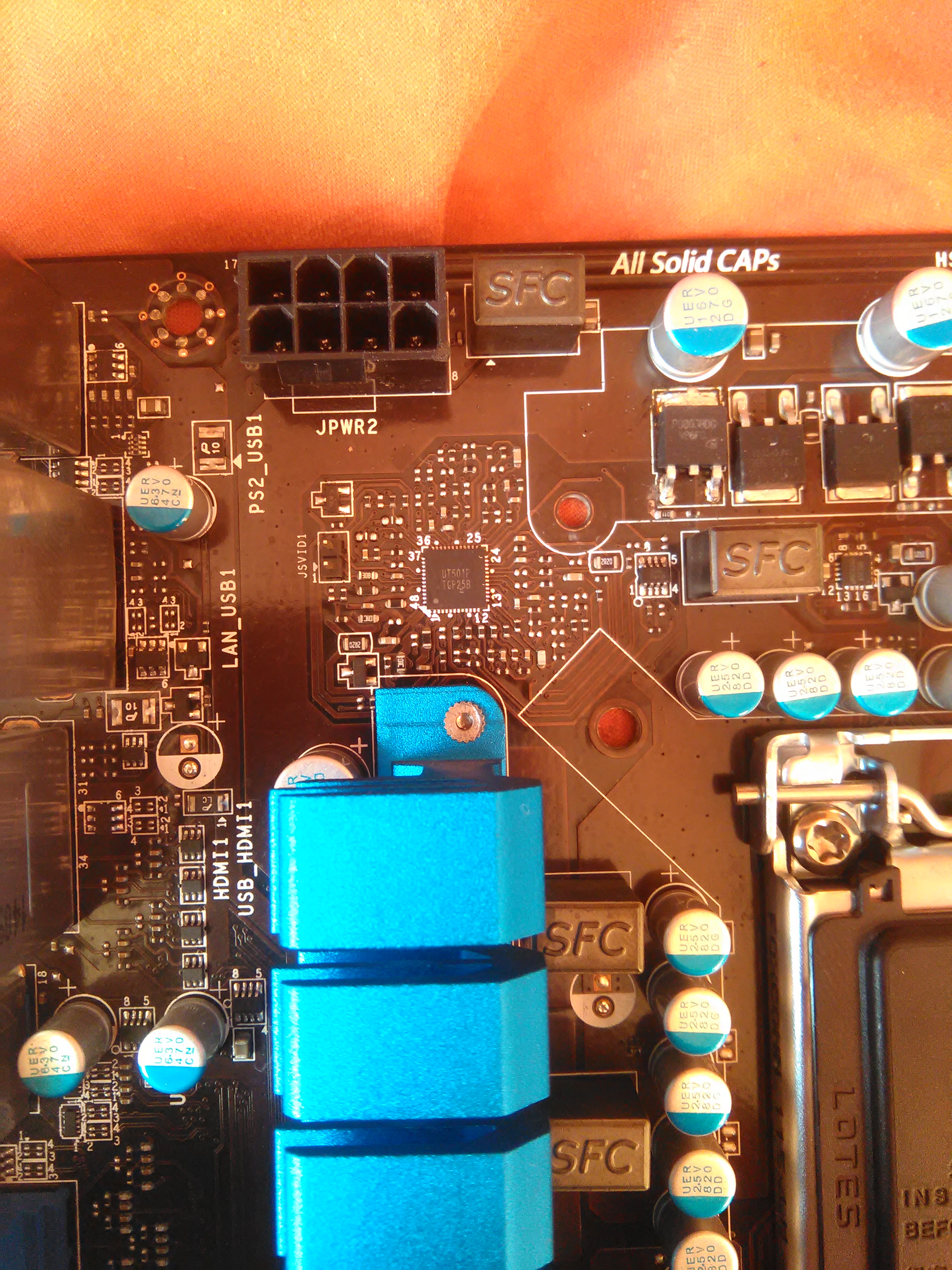

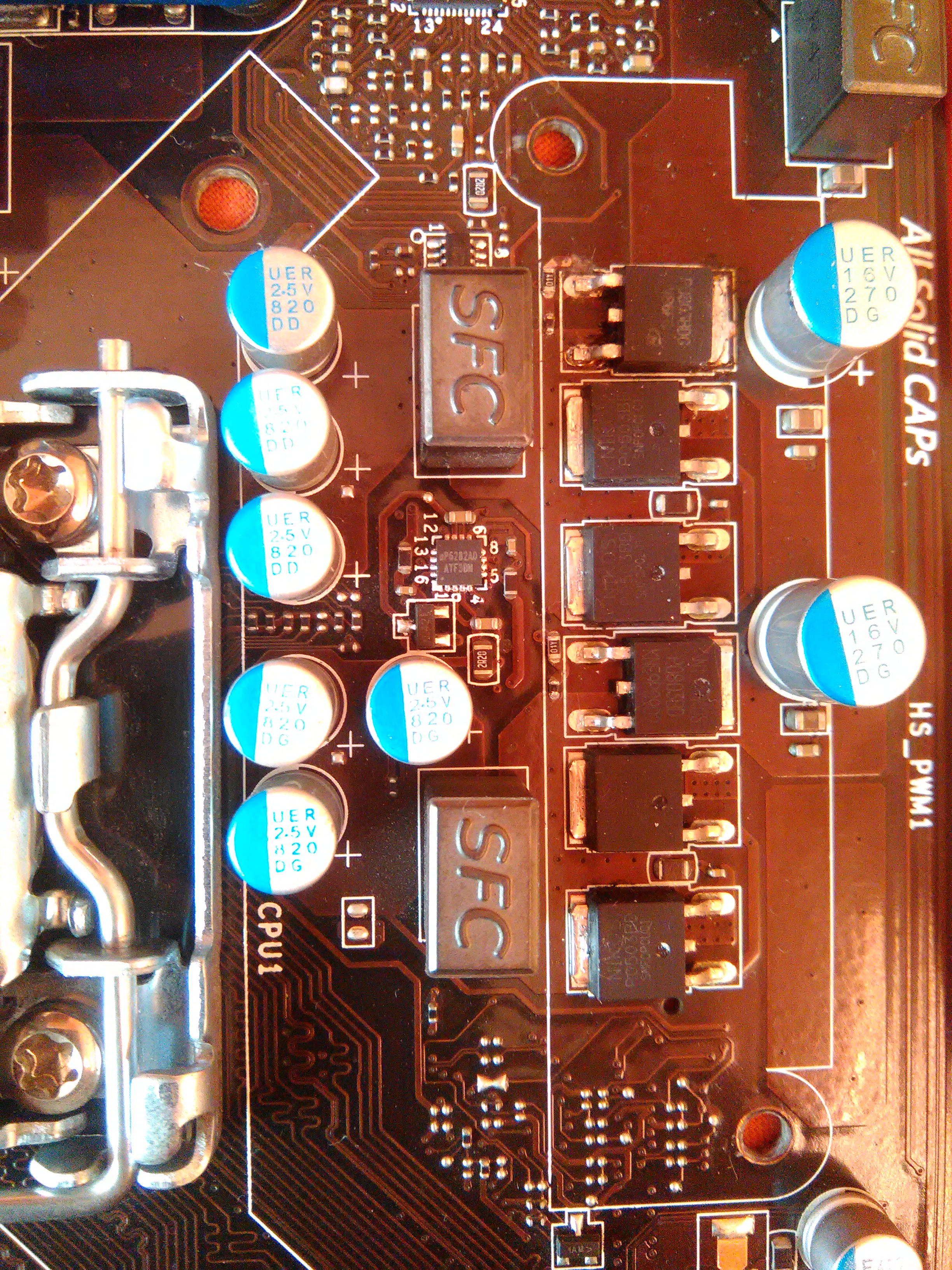

    Hello, after a long break. I replaced the transistors in the PWM 2 section (P0803BD and P0503BD) and one in the PWM 1 section, which showed a short circuit (first from the left in the photo below), the board starts, but after about five minutes the replaced transistor (P0803BD) gets a short circuit again. I replaced it with a new one, but the situation repeated, only the one in the PWM1 section gets a short circuit, I will add that the transistor does not even show increased temperature. Something causes a short circuit, but I don't know what?

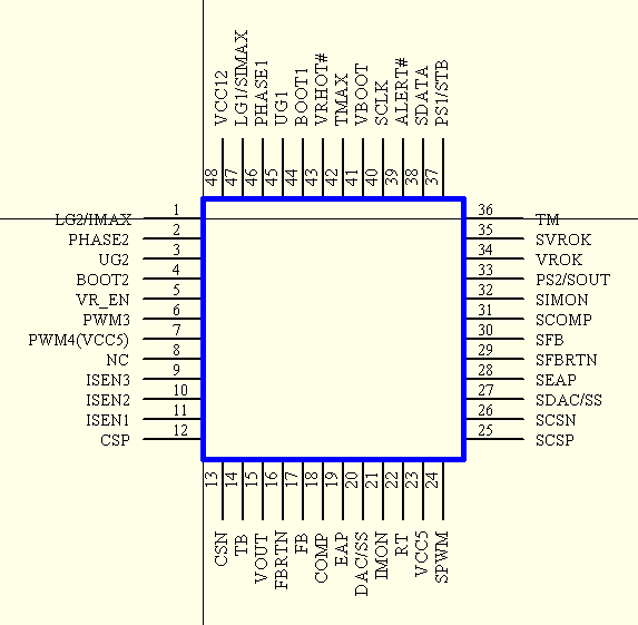

    The signal from the transistor goes to the uP6282AD to the 14th and 15th pin. I don't know if this is the system that controls the entire section, or if I try to resuscitate the record or let go. What can cause a short circuit on the above-mentioned transistor, what else to check. Thank you in advance for your answer.

    I suspect you have something to do with the control of the owgo damaging field
    -needed oscilloscope, waveforms on the input
    - or general cargo in its vicinity
    The CPU VRM is composed of:
    -4 phases for the CPU (cores) (4 coils + 8 mosfets)
    -1 phase for the memory controller embedded into the cpu (1 coil + 2 mosfets)

  • P6282 as likely fault area to inspect

    Hello. Unfortunately, I do not have an oscilloscope, my knowledge is rather not advanced. If I understood this section correctly, the P6282 controls and in its environment I should look for any damage. Can the P6282 chip itself cause a short circuit in this transistor?
    Please tell in simple words where would you look for damage.
    I would have one more question where to find the schematic of this album. Thank you in advance for your answer. Best regards.
