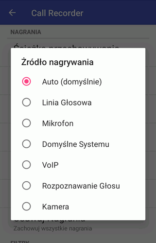

    Hello, in the phone Samsung Galaxy S7 (Android 7.0) I do not work properly for any phone recording program. What can be a problem that only records my voice and I can't hear the caller's voice?
    Earlier on the phone Sony Xperia Z (android 6.0) I did not have this problem and everything worked as it should.
    Do I have to turn on anything else on this phone for it to record properly?

    Change the recording source in the program to 'Voice Call', probably the default is the microphone.

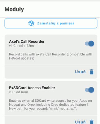

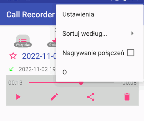

    dj-raszit wrote:
    In the case of CAT S61, the advice from @plustek, unfortunately, did not work for me.
    Now a question for those who know: Will rooting the phone help in this matter?
    You can't do it without root.
    I don't know how in this phone model - it helped me:
    Root > Magisk Manager > Call Recorder
    https://gitlab.com/axet/android-call-recorder
