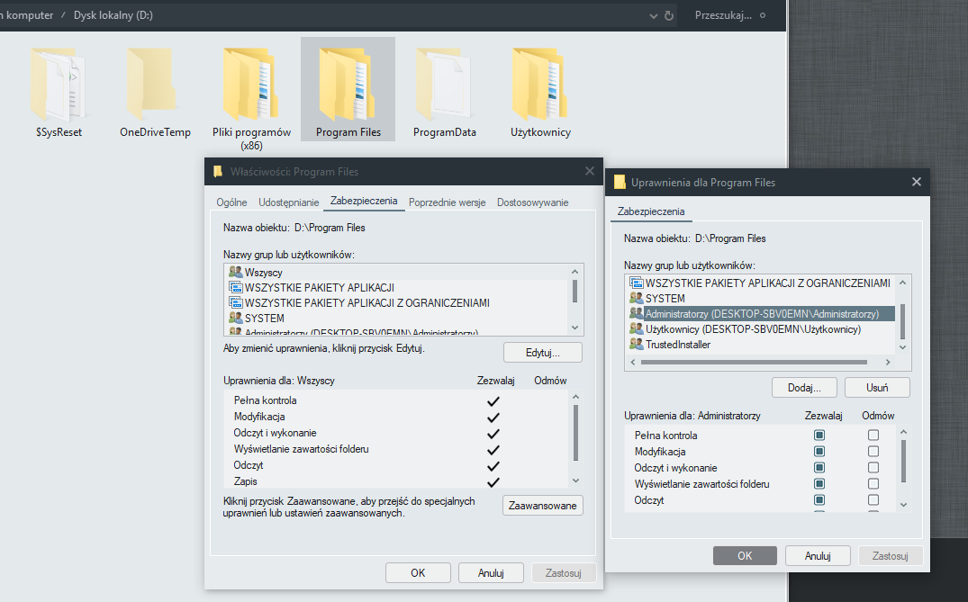

    I also have a problem with removing the remnants of the old Windows 10 system on another drive and I do not want to format it completely, I changed the "Windows" folder to "Windows.old" and I managed to get rid of it quite quickly, but I have a problem with two folders "Program Files "because I take full control over them and you can't remove them anyway. I already gave full permission to the group "Everyone" but when I try to delete it still gets a message that I need permission for the group "Everyone". Something is clearly misunderstanding.
    DroidCam - A phone with "DroidCam" app as a camera for Skype on PC
    I would be grateful for any idea of any problem.
    Thank you in advance.

    You have several options regarding rights.
    - Remove permissions other than yours from the list.
    - Change drive letter and check again.
    - Check with another program (Unlocker, Total Commander etc).
    - Perform the above-mentioned in emergency mode.
