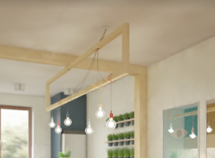

    I have a lamp to construct:
    Connecting 6 Cables/Bulbs (2x0.75) to One Three-Wire Ceiling Cable: Lamp Construction Guide
    So 6 cables coming from one headliner. How to connect these 6 cables (these are 2x0.75 cables) to one three-wire cable coming from the ceiling? What must be the cube diagram? Or maybe it's better to do it with a quick coupler?
    If you need more information, let me know, because I am a beginner in these matters :)
    Thanks!

    So, for example, yes?

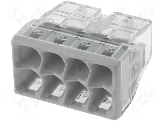

    It may be so, but it is better to press the ends and use WAGO single-potential connectors ;) L to one cube, N to the other cube
