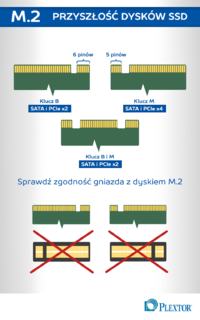

    Dear friends, I would like to know what SSD for M.2 socket I can mount - M.2 SATA or M.2 PCIe. Asus ROG GL552VW laptop. The information available on the network is not precise. The specification on the Asus website is supposedly written PCIe, while on the internet users also mount M.2 SATA.

    If the manufacturer says that the slot supports PCIe, and the SATA drives also work, it means that you can install both types of disks.
    Check also the physical construction of the socket, so that there are no surprises. Open the laptop and look carefully at the socket. Then compare with the drawing:
    Asus ROG GL552VW: M.2 SSD Compatibility - SATA vs PCIe, Choosing the Right SSD for Your Laptop
    The problem is still different: whether the disk will work after the NVMe or AHCI protocol, because the fact that it is a PCIe M.2 drive does not mean that the socket supports the NVMe protocol. Then there are no profits compared to M.2 SATA.
    The problem with this series of laptops is that from what I've read, newer ones support the NVMe protocol, and older ones do not.

    I have no way of knowing what the socket looks like - I do not have a laptop physically. I read the NVMe protocol that it is not supported. The problem for me is the choice of the disk. Should it be with two gaps in the rail or with one (please forgive this simplification).
