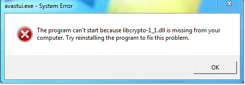

    I get an error on the desktop after turning on the computer, since then FS has not worked.

    I uninstalled avast, the error is gone but it didn't help :(

    The game still starts with an error? Where did you get it from

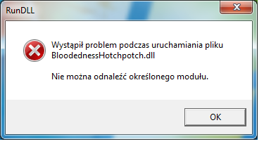

    The error was after firing the computer. after restart, there is no error. I also have a second mistake but the game started so that's not it.
    What?
    It started, but now it won't start.
