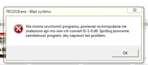

    Unable to install Pro Evolution Soccer 2018 - the program has stopped working.
    I am sending a picture, I wanted to install the game, but I have a big problem, what could it be, prose for a signpost.
    It's about the Pro Evolution Soccer 2018 game

    Are you running the installer with Administrator privileges?
    The computer and system meet the minimum game requirements?

    Yes, the game is installed on Steam, I gave it a go. You should go at least to settings and change the settings to weaker or stronger, but this message is and I don't know why, Windows 7.

    I did a consistency check.
    something pops up when I turn on the pes 2018 apps

    unfortunately they still don't work

    of course, I made a mistake in the title, because it's 2018 and not 2017 PEs. Other games like Pes 2017 are no problem. I tried many things. I installed the framework, WMP, nothing helps. Today I intend to install the new system on the C drive, then I will see what happens. If it does not go then the computer is too weak. But in this case there should be no message

    You haven't entered the PC configuration.
    What's in the REDIST folder where it plays? Try to install everything from there manually.
