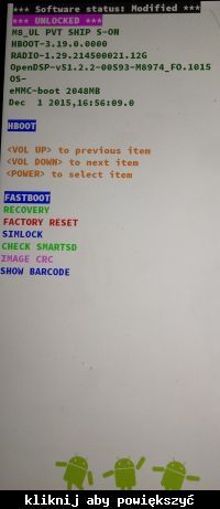

    I had to buy a new motherboard for the HTC One M8. I bought one that I can afford and I need to upload a new soft.
    I don't know how to go about it, I tried a bit but nothing. Photos from bootlader and recowery mode.

    1. Lock the Bootloader. To do this, run the command: fastboot oem lock
    2. Drop the file Nutegsm gave you to the memory stick and rename it to 0P6BIMG.zip, the zip extension may be hidden.
    3. Insert the card with the soft into the phone and turn on the Bootloader.
    4. Follow the instructions on the phone screen.
    5. If it fails, give more data, such as: MID, CID etc.

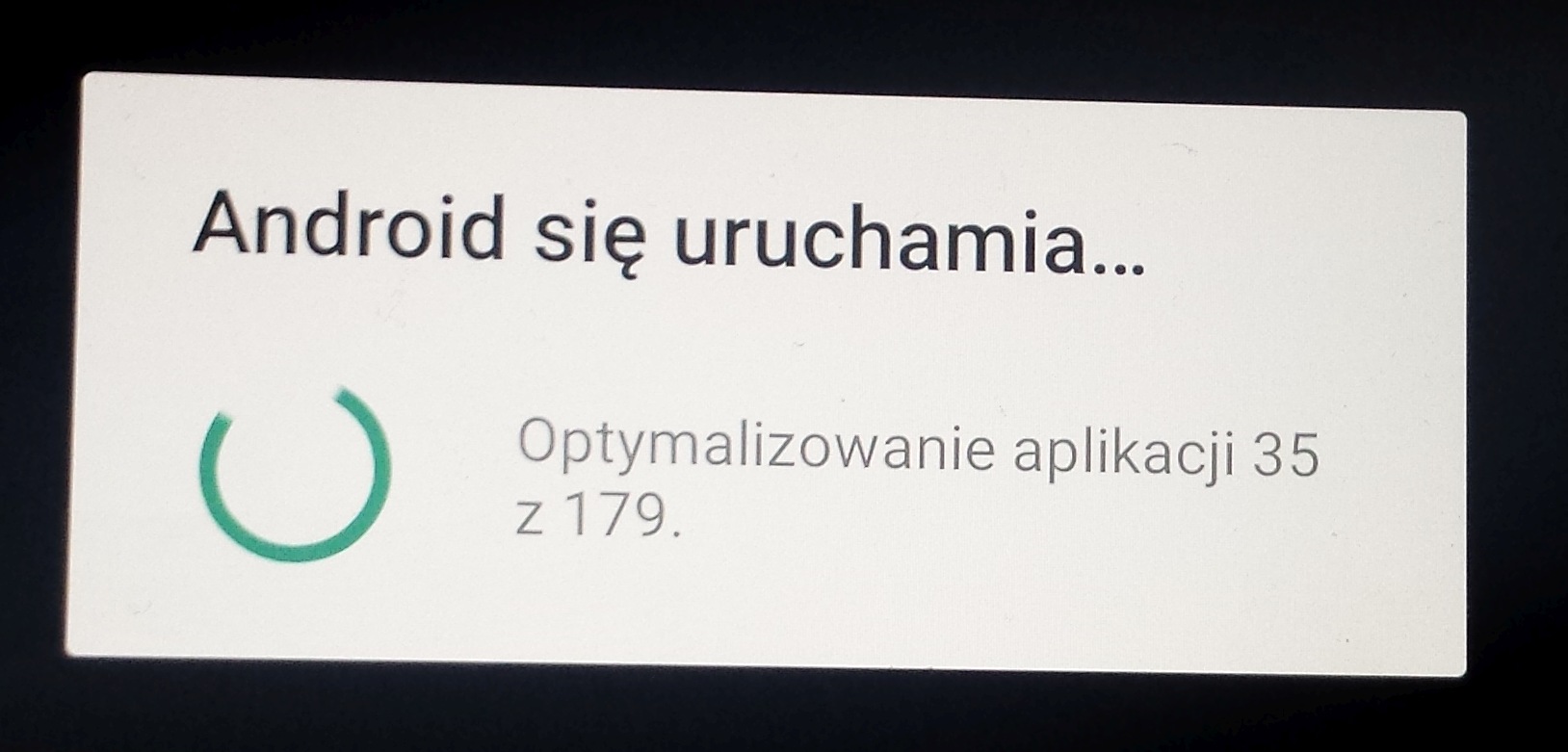

    Something strange happened, I recharged my phone, I turned it on, I waited a while and the android started. I turned off and turned on, waited a bit and the android fired. It came a week later, a message was displayed that a system file was missing and would not turn on. It looks like there is android on the phone but there is something wrong with it because today it turned on but google play does not work. A message appears when switching on

    Perform a hard reset or reload the firmware.

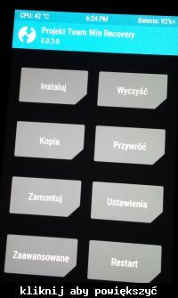

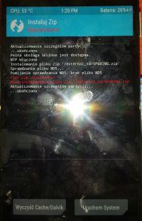

    I put the memory card with the ROM into the phone and something like this pops up
    HTC One M8 New Motherboard: Guide to Upload New Software and Navigate Bootloader, Recovery Mode HTC One M8 New Motherboard: Guide to Upload New Software and Navigate Bootloader, Recovery Mode
    When I go to TWRP and want to install it shows something like this

    Since the above methods do not help, go to the website where they will upload the new firmware.
