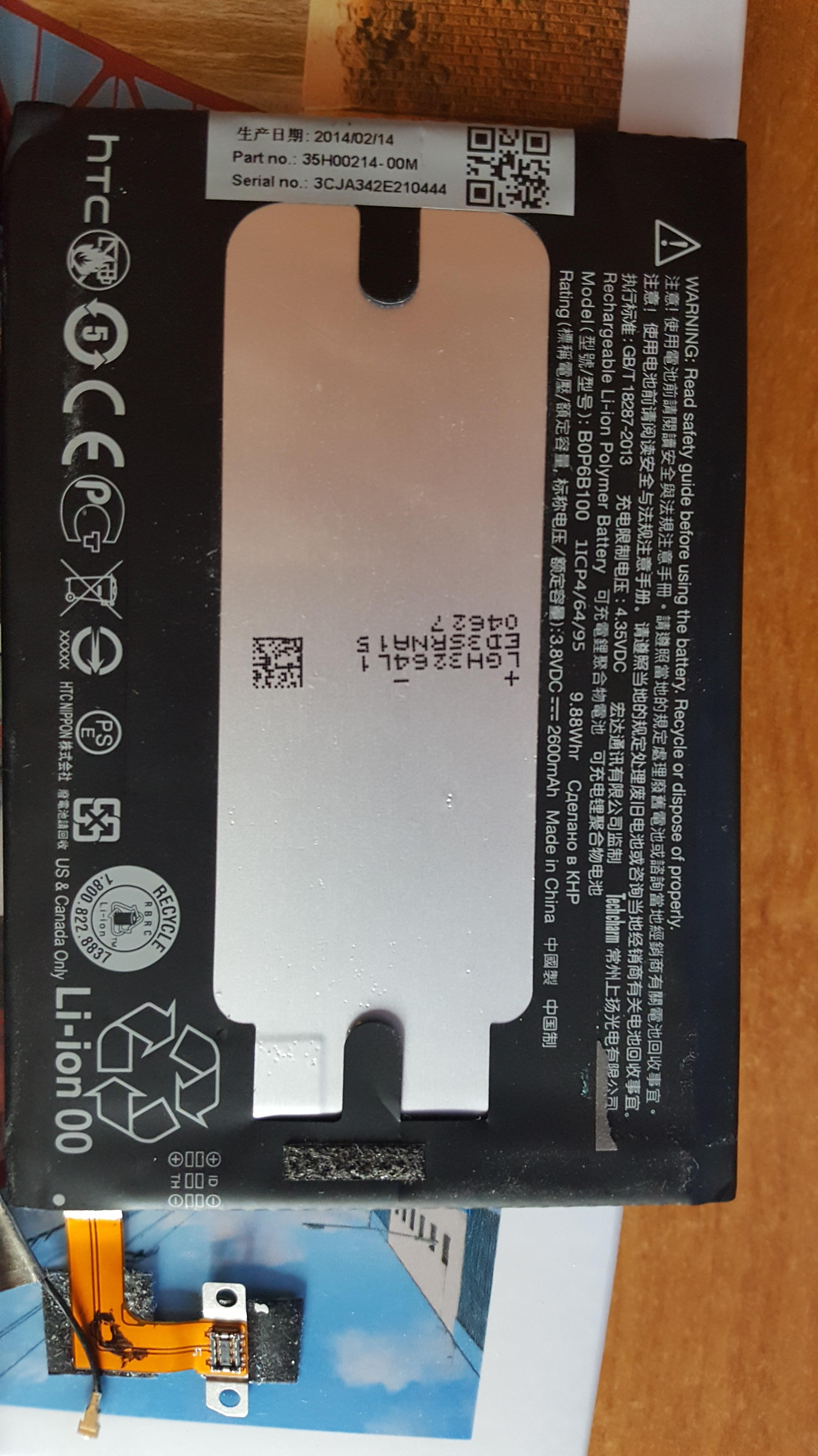

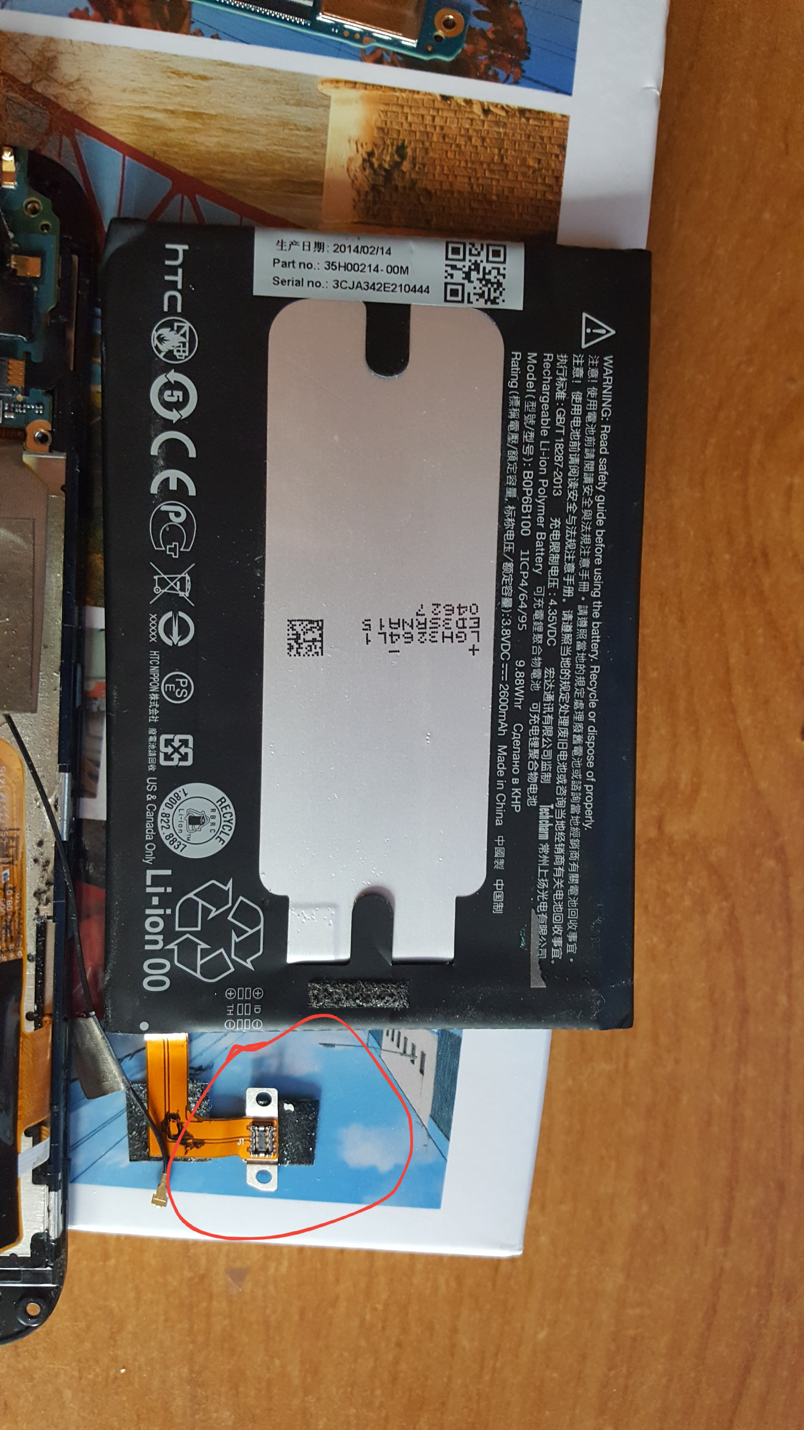

    I bought a bargain battery that is supposed to be good. When I start the phone on this new battery the motherboard heats up but the picture is not displayed. Htc one m8 - does not start - When connected to the charger, the LED lights up.1507104781...288225.jpg (1.15 MB)You must be logged in to download this attachment.
    • Htc one m8 - does not start - When connected to the charger, the LED lights up. 1507104761998378990031.jpg (1.28 MB) You must be logged in to download this attachment.
    • Htc one m8 - does not start - When connected to the charger, the LED lights up. 15071047383911338846553.jpg (1.47 MB) You must be logged in to download this attachment.

    Mike20122 wrote:
    I was charging with a 5V 2A charger.
    An example of a meter electrode for these battery meshes and shows 0.
    Mark on the picture which eyelets you applied the meter to ?? A new or used battery does not mean that it is fully charged.
  • #13 16738014
    Mike20122
    Posts: 127
    I applied to these holes.

    The question was rather to which pins in this connector because there are 4 and to measure the battery voltage you need to measure two specific.
    However, looking at the photo of the disc and the remains of the seals on it, I can tell you that there are already some yellow handles rummaging hard and the phone is some refurbish-folding, probably on non-original parts, which on some auction sites can be bought as 'nówki' for a few hundred zlotys from delivery time 2 months. Investing in it rather doesn't make sense.
