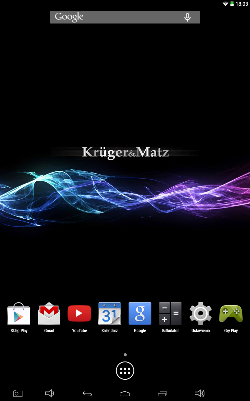

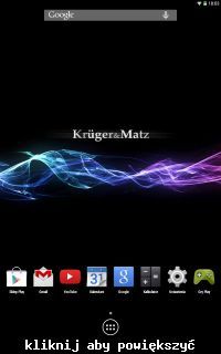

    Well, on the way, I found a damaged charger plug :P Now it is 4.2V (without batteries). After removing the charging fault, it turned out that the flashing carried out earlier had a positive effect. The tablet is alive :)
    Kruger & Matz Eagle 777 (KM-0777) Tablet Stuck at Startup Screen: Recovery & Software Uploader
    Thanks to everyone for your help
