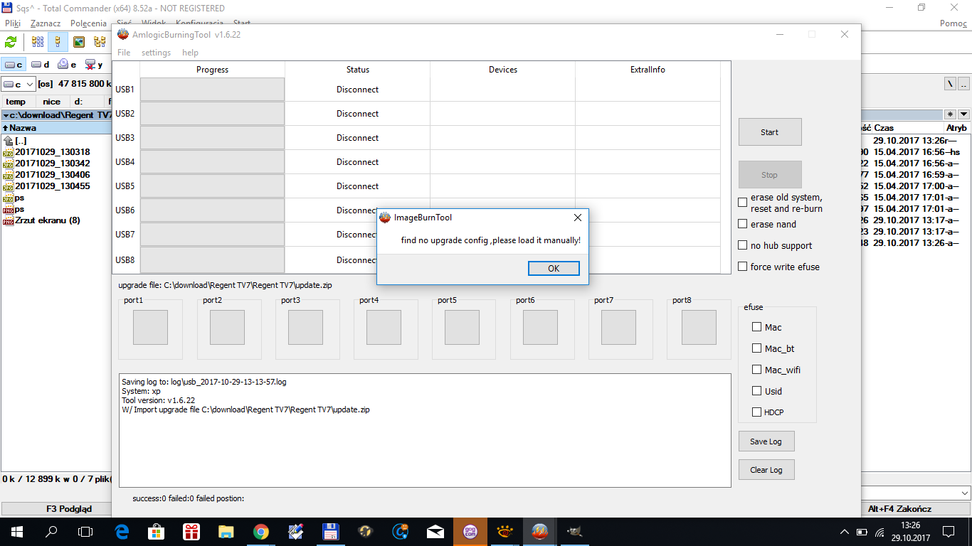

    Unfortunately, nothing comes of it. I don't know if I'm doing it right.
    I fire up AmlogicBurningTool
    File -> Import Upgrade File indicates update.zip from the unpacked Regent TV7 archive
    and after about 20 seconds it receives the following message:
    "find no update config, please load it manually"
    The tablet is turned on (as much as it can) - i.e. it is hanging on the charging screen
    My system (Windows10) sees it as 2 USB drives that cannot be entered
    manually load the configuration file

    FILE -> Import Config file, enter the folder that appears and select the config_progress.xml file

    As you can see above - (sorry I changed the previous post a bit later than you wrote the answer) I did it but unfortunately it does not change anything :cry:

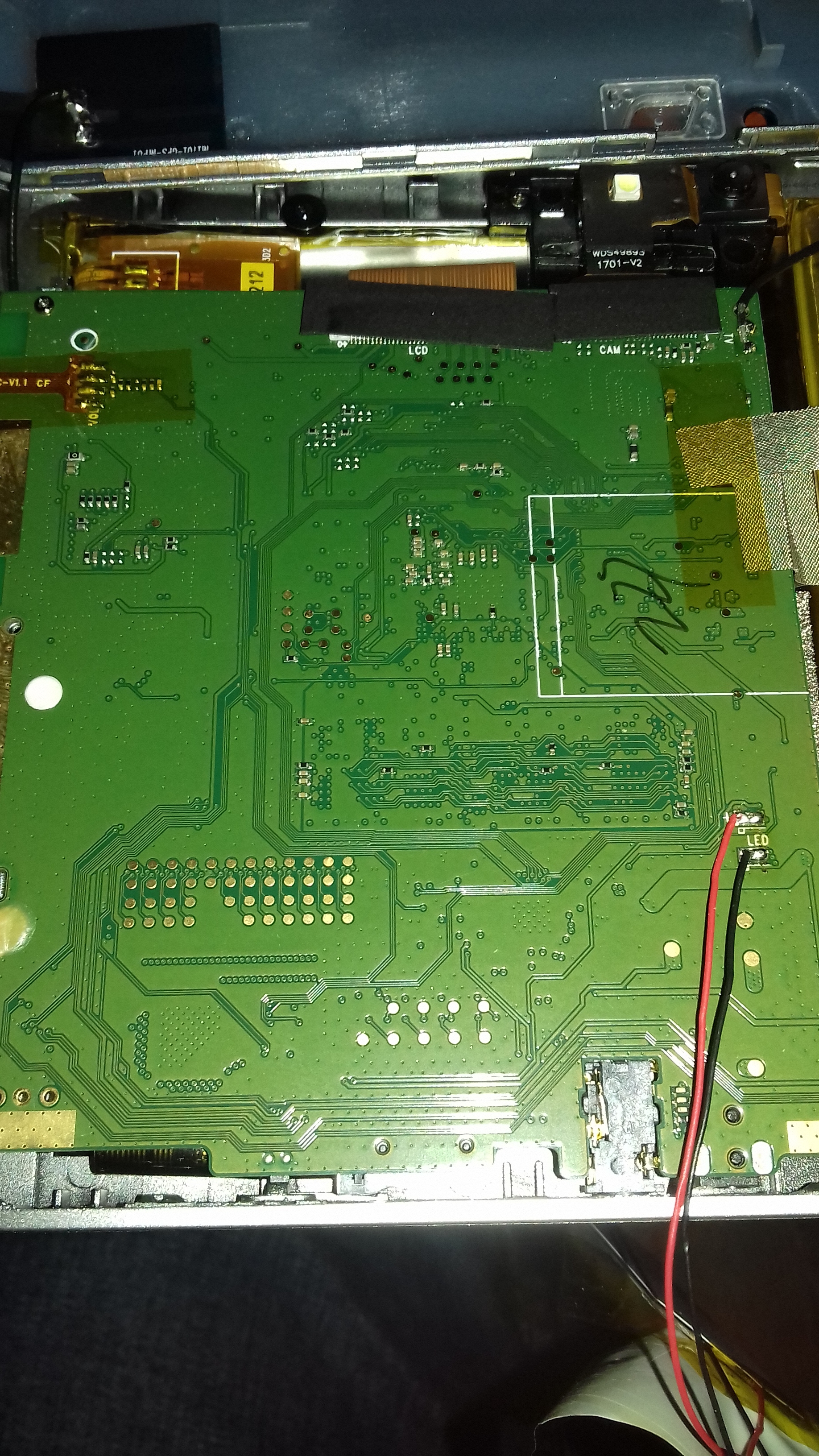

    I took the tablet apart
    Take a picture with no blur as clear from the center of the motherboard.

    Everything ok until point 3
    When I try to load update.zip after about 20 seconds, it pops up:
    Ferguson Regent TV7 Tablet - Red Screem, Freezing, Unresponsive Hard Reset & Wipe Data

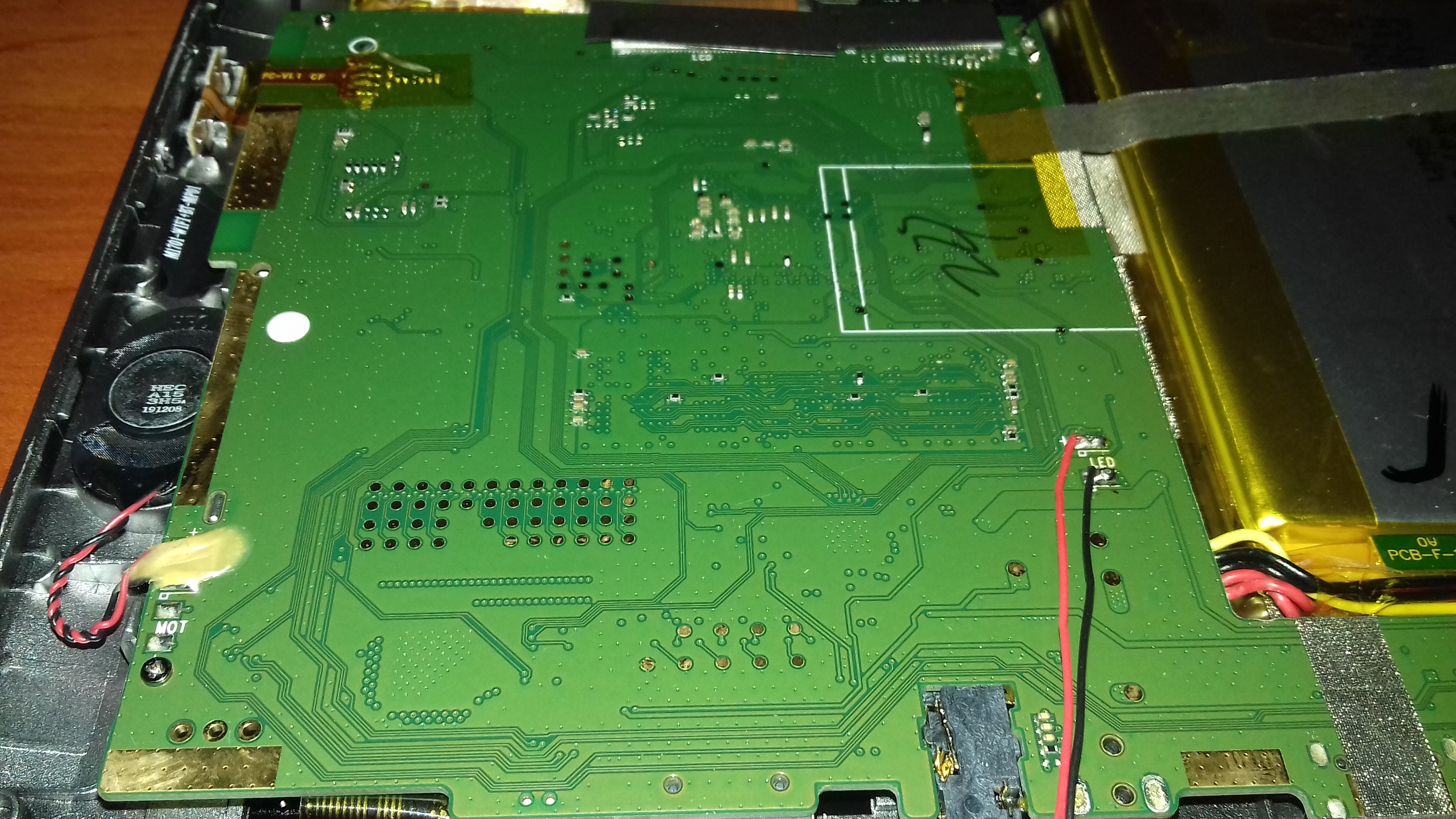

    motherboard pictures:
    I don't know if that was it, at least you don't see any overheating or discoloration

    Rather, I mean the view from the other side, where you can see the components.
