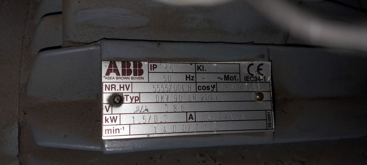

    I have a very similar engine according to the Y/YY plate.
    I added protection to it in the form of a motor thermal switch for the appropriate amperage.
    I bought a three-position 1-0-2 SPAMEL ŁK25R cam switch to start it, hoping that it would fit, but I can't find a clear answer anywhere how to connect this switch so that in the second gear it would supply me with a second set of terminals (U2, V2, W2) and short circuit first set of terminals (U1,V1,W1). Maybe someone will help.
    ABB motor nameplate with technical specifications.
    I know how to connect the motor itself, it's clear to me. I also found a description of how to switch it on with contactors, but I would like to avoid it, a simple cam switch is enough for me. The only question is what and how to connect it. On the internet you can find 0/D/YY or Dahlander couplers but is it the same as 0/Y/YY? I have big doubts. I will be grateful for your help.

    The switch you bought is not suitable for this motor. It's supposed to be Dahlander, markings 0-1-2 outside.
    The Y/YY and D/YY motors differ only in the internal connections of the windings.
    The switches are the same in both cases. The connections to the terminal board are also the same. It is important to correctly identify the motor pins 1U, 1V, 1W and 2U, 2V, 2W.

    WojtekDzi
    Thanks Krzysiek
    I'll be looking for a Dahlander, and for now it'll only run in one gear.
