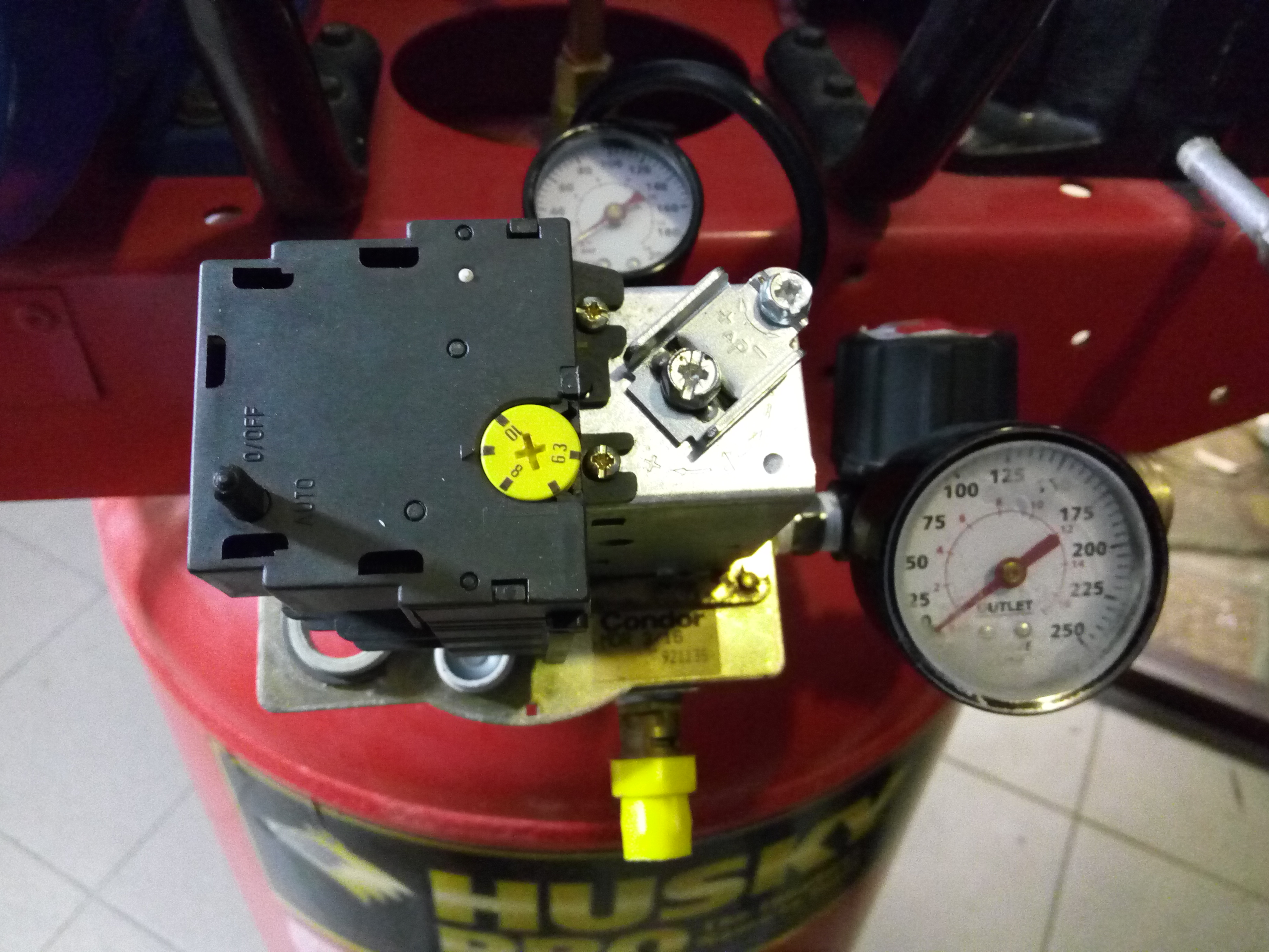

    Hello. I need help. I need to connect a new three-phase motor, to the compressor, the Condor MDR3-EA pressure switch. I am asking for help from professionals. How to pull cables? :)
    Connecting a Three-Phase Motor to a Condor MDR3-EA Compressor: Cable GuideIMG_201703...155623.jpg (2.35 MB)You must be logged in to download this attachment. Connecting a Three-Phase Motor to a Condor MDR3-EA Compressor: Cable GuideIMG_201703...154559.jpg (5.29 MB)You must be logged in to download this attachment. Connecting a Three-Phase Motor to a Condor MDR3-EA Compressor: Cable GuideIMG_201703...155124.jpg (2.92 MB)You must be logged in to download this attachment. Connecting a Three-Phase Motor to a Condor MDR3-EA Compressor: Cable GuideIMG_201703...154804.jpg (3.66 MB)You must be logged in to download this attachment. Connecting a Three-Phase Motor to a Condor MDR3-EA Compressor: Cable GuideIMG_201703...154540.jpg (3.41 MB)You must be logged in to download this attachment.

    I do not know what your pressure switch is showing the photo

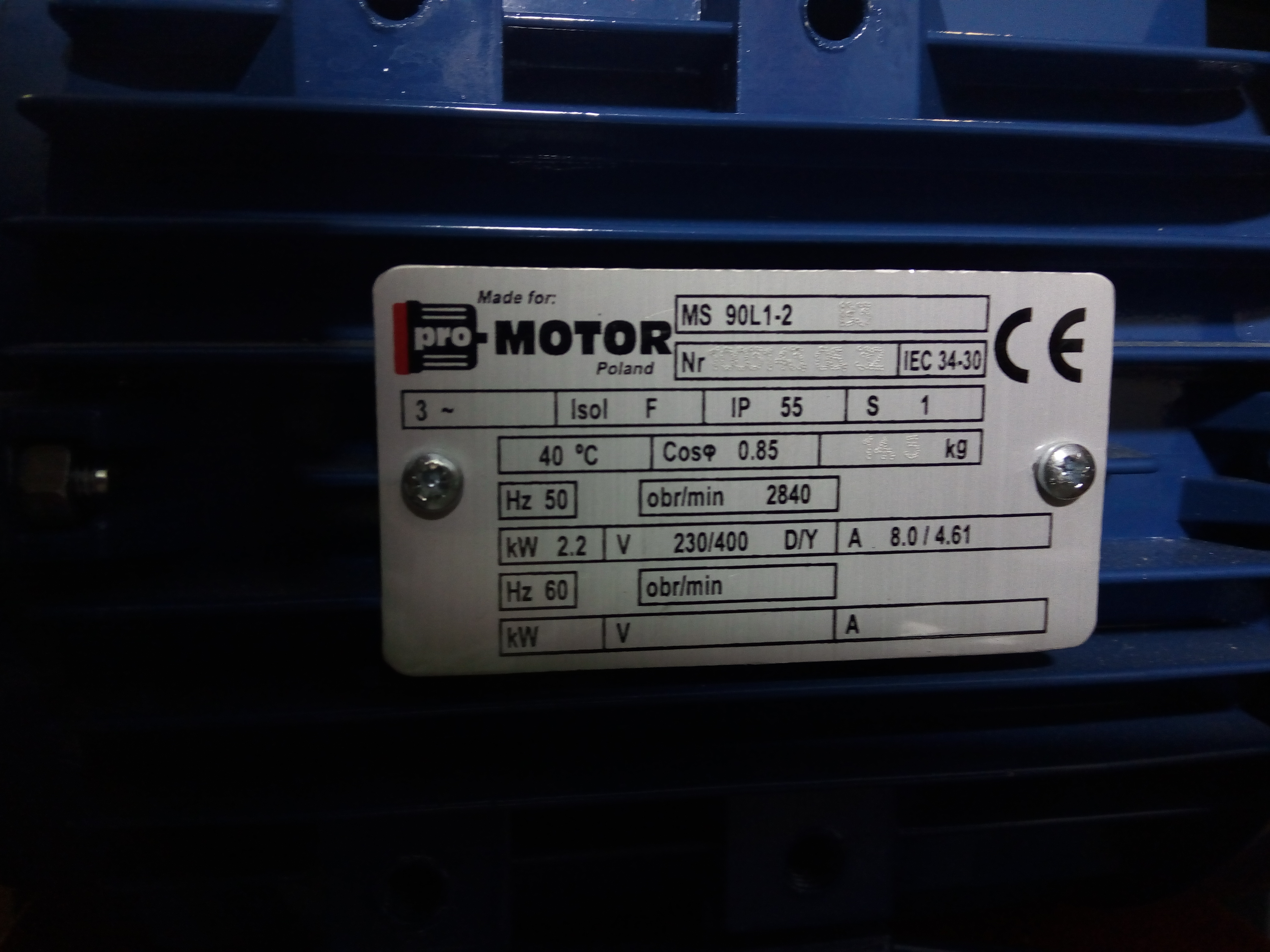

    The motor has a rated current of 4.61A for work in a star, so even 1.5mm2 would be enough.
    For greater mechanical resistance, you can use 2.5mm2.
    The pressure switch has 3 paths as well as you have 3 power phases (but I do not see the terminal markings).
    L1, L2, L3 conductors of the power cable are connected to terminals 1, 3 and 5 of the circuit breaker - conventionally from the left.
    The wires L1, L2, L3 of the cable to the motor are connected to terminals 2, 4, 6 of the circuit breaker - on the right side.
    The PE wires of both wires are connected using the connections at the bottom (these two screws on the brass plate).
    Remember about wire-end and eyelet terminals when connecting cables.

    A motor with no power turns the hand lightly. After connecting directly to the power spins., But I'm afraid to leave it for longer on. That it will not be damaged. The engine lay for a long time (about 5 years) in a tin garage in a cardboard box on the plot. But I've had it at home for a month. It was not flooded, but could it have been damp?
