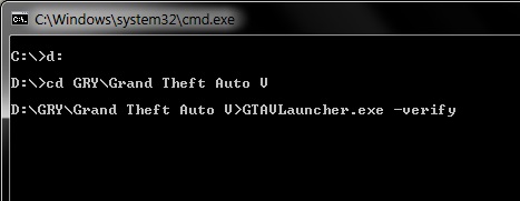

    From what you described is a game installed separately not through Steam, so try something like this:
    1. Run the "cmd" command line
    2. Enter the path where the game is installed (by default) "cd c: \ Program Files \ Rockstar Games \ Grand Theft Auto V"
    3. Now enter and run "GTAVLauncher.exe -verify", theoretically it should verify all files from the game and pull the missing ones.
  • #10 16426189
    Maksgtav
    Posts: 20
    Something like that pops up
    "The name GTAVLauncher.exe -verify is not recognized as an internal command or external executable program or batch file"

    atomic99
    Posts: 2760
    Help: 171
    Rate: 338
    Did you enter the game installation path correctly?

    Maksgtav
    Posts: 20
    Thanks, I actually made a mistake when typing I just don't have cmd experience. We've verified the game data and see if it works
    Added after 26 [minutes]:
    Unfortunately, the verification did not give the same thing
