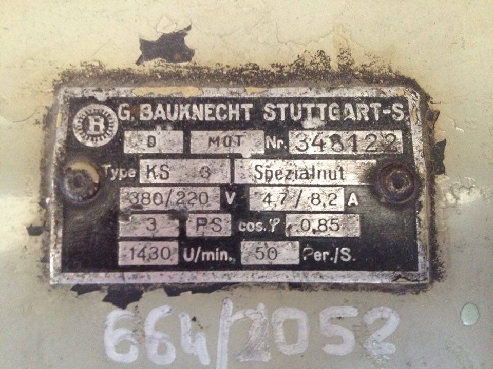

    I have a problem reading the information from the nameplate. What is the number of pole pairs of the magnetic field? Is this information on the plate at all ?? I am a layman and urgently need this information :) (I attach a photo of the plate)

    2 pairs.
    Synchronous speed 1500 rpm.
    Added after 34 [minutes]:
    The rated speed found on the nameplate is 1430.
    This is synchronous speed minus slip.
    And the formula for synchronous speed (ns) is: fx60 / p where f- frequency (here 50Hz) p- number of poles.
    Then you transform the formula and you have the number of pole pairs.
