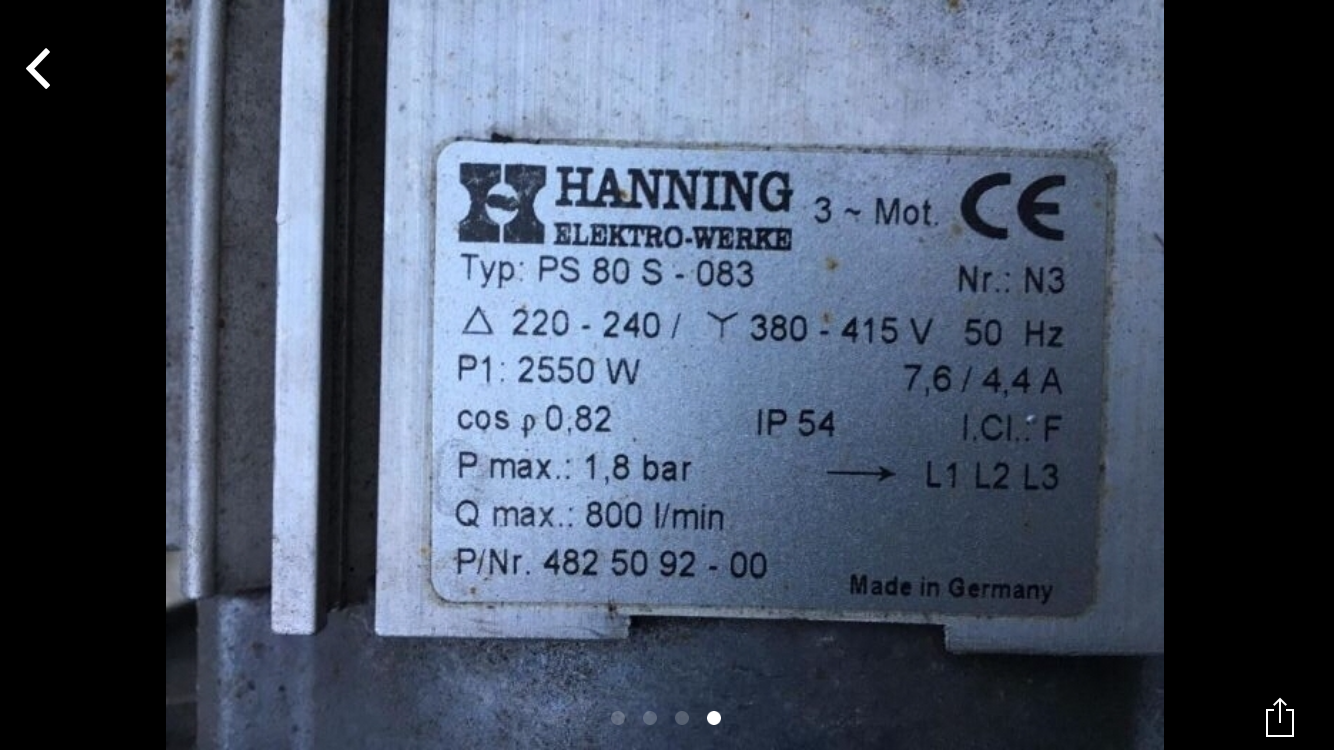

    I'm a new user on the forum so please bear with me. Can anyone from the table below read the number of pole pairs ?? Reading Nameplate: Identifying Number of Pole Pairs from Table - New User Inquiry

    I have not yet come across a sign with information about the number of pole pairs.
    You can calculate it, but you need to know the engine speed, but this information is missing on this plate.

    My colleague, the drill, probably saw little :) Although the number of poles is not given, the number of poles is the same, the Cantoni group, for example, and many other manufacturers give the number of poles in electric motors, this is usually given at the end of the motor type.
    It can also be calculated from the rotation and frequency.
    ps as for the topic, it will not be possible to calculate it from this plate because it is a pumping system plate / probably / because it gives the amount of fluid how much per minute it will pump and the maximum pressure.
