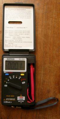

    yesterday - quite by accident - in one of the supermarkets I came across the Pocket Multipurpose Meter MU-06M with automatic range change.
    In the price below 35.- PLN -s, of course I liked this multimeter and I bought it.
    Below the scans of the carton of its packaging once the User's Manual:
    Seeking Recommendations for Auto-Ranging Multimeter Under 150 PLN Seeking Recommendations for Auto-Ranging Multimeter Under 150 PLN
    and photos of the meter itself (maybe not the best but done an hoc for the purpose of this post):
    It is worth noting that this meter, small size ("box" after closing has dimensions; 115mm by 80mm and 19mm thickness) has a LCD display 3 and 3/4 digits and alternating AC voltage - it measures True RMS, and in addition has an automatic change ranges, but does not have the ability to measure currents.
    In addition, this meter needs two AAA cells of 1.5V - relatively cheap compared to the Baby 9V battery, and used in most similar multimeters.

    Yes, it's a nice measurer, it can measure up to 10MHz and up to 2mF.
    For this automatic ranges, permanently connected wires and TrueRMS.
    If it was to measure the current, it would be an ideal.
