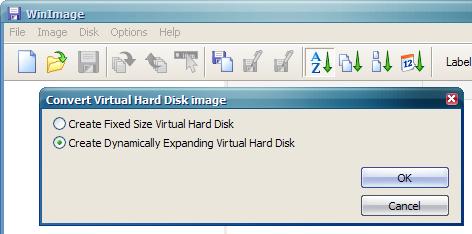

  • #14 16440409
    Gelip
    Level 36  
    Posts: 5250
    Help: 324
    Rate: 613
    chomikuj wrote:
    I mean oh to boot it from the virtual machine
    Convert yourself .img image to .vmdk e.g. with WinImage - Disk menu -> Convert Virtual Hard Disk image ... by selecting All files (*. *) - the image can be dynamic:
    Boot Virtual Machine from .img in VMware, QEMU, VirtualBox: Unpack & Use debian-for-alix-v3.img.bz2
    Then create a virtual machine eg Win95 with the amount of RAM eg 128MB and set the created .vmdk image in the machine configuration.
    Prot wrote:
    however, there is little chance of properly configuring the vmx virtual machine to make it compatible with the physical computer from which the img system image was taken
    In the case of Linux, eg Debian in the console version, there is no problem with that.

  • #16 16440725
    Gelip
    Level 36  
    Posts: 5250
    Help: 324
    Rate: 613
    Prot wrote:
    Maybe a disk image from an ext partition; fat and ntfs are the same? :D
    In my opinion, you need to run a "clean" machine for Linux, and on it, ie on a clean virtual disk install :idea: dream linux distribution. The author of the thread will waste many times more time searching for the "miracle" conversion method than it will take him to install and configure this Debian :D
    You can see that you have no experience, you just write down your guesses :-) First, check what I wrote and you will see that it is possible. Converting a file debian-for-alix-v3.img 1.75GB per .vmdk image using the above-mentioned program takes only about a minute (CPU C2D) and the system runs without any problems under VMware:
    In this case, you are absolutely wrong. It is much faster to upload a disk image to disk than to install a fresh system. As I wrote above - about a minute and I have a working system and the installation would take about 30 minutes if not more depending on the computer.
