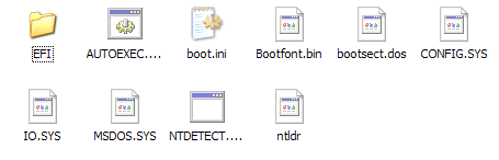

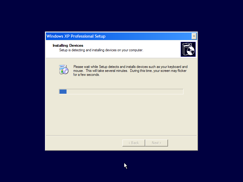

    The topic was originally about WinXP 64-bit but this post is about WinXP x86
    Test versions of Vista are practically improved WinXP and it turns out that WinXP SP3 can be launched from the EFI bios. It is possible thanks to two files from the test version of the system Vista (Longhorn 6.0.5219.0) (beta2) . These files must be extracted from the ISO image from the location:
    install.wim\Windows\System32\winload.efi
    install.wim\Boot\EFI\Microsoft\BootMgr\bootmgfw.efi
    Tested in VMware Workstation 8 - of course in EFI32 mode.
    [letter: bc67a9acf6] [*: bc67a9acf6] create a machine with a disk, e.g. 3GB
    [*: bc67a9acf6] we create two primary partitions on the disk - 100MB FAT32 active and the rest 2, something NTFS
    [*: bc67a9acf6] install WinXP SP3 in regular bios on partition 2, something GB
    [*: bc67a9acf6] after installation on a 100MB partition, create a folder EFI \ Boot and put the file there bootmgfw.efi changing its name to bootia32.efi
    [*: bc67a9acf6] file winload.efi copy to Windows \ System32 on the second partition
    [*: bc67a9acf6] on a 100MB partition we have a file boot.ini and edit it to look like this:

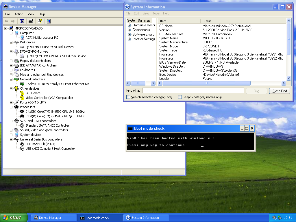

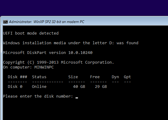

    However, you can boot like WinXP in EFI. Here is my post on another forum:
    Does Windows XP have EFI?
    I was able to run Windows Server 2003 R2 SP2 x86 in VMware Workstation 7.1.4 with EFI32 bios. I used the same EFI files as for WinXP SP3, i.e. from Vista beta2. How we turn on the service Themes the system looks like WinXP :D :
    Windows XP 64-bit & 32-bit: EFI Compatibility, GPT Partitions, Booting & Dual Boot Guide
    I found out from an unofficial source that the w2k3R2 system has improved HAL drivers to work with EFI, i.e. files such as framebuf.dll, hal.dll, halmacpi.dll, ntoskrnl.exe e.t.c.
    Added after 10 [hours] 7 [minutes]:
    I did new tests. If the EFI32 firmware has an integrated NTFS driver (as in this case) then only one active MBR primary partition is enough to run Windows 2k3 in EFI32 mode:
    You don't need any EFI FAT32 partition or GPT disk as it needs Win7 and above. You can switch between EFI and BIOS at any time and the system will start up without a problem :D The best way to switch is in the machine's configuration file .vmx by adding or removing the comment, e.g. with a character # :
    To boot in EFI mode:
    firmware = "efi"
    efi32.filename = "6020_ntfs.bin"
    To boot in BIOS mode:
    #firmware = "efi"
    #efi32.filename = "6020_ntfs.bin"
    Oh. And that's it for VMware Workstation 8.0.2 build-591240 in mode Hardware Compatibility 8

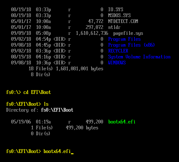

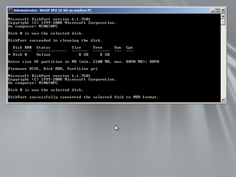

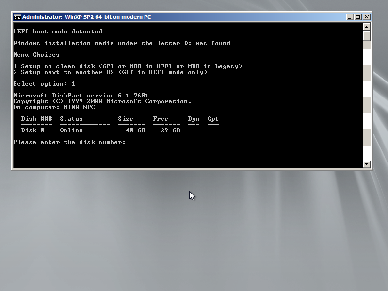

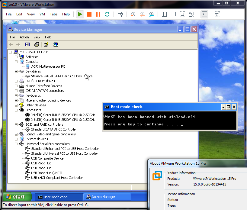

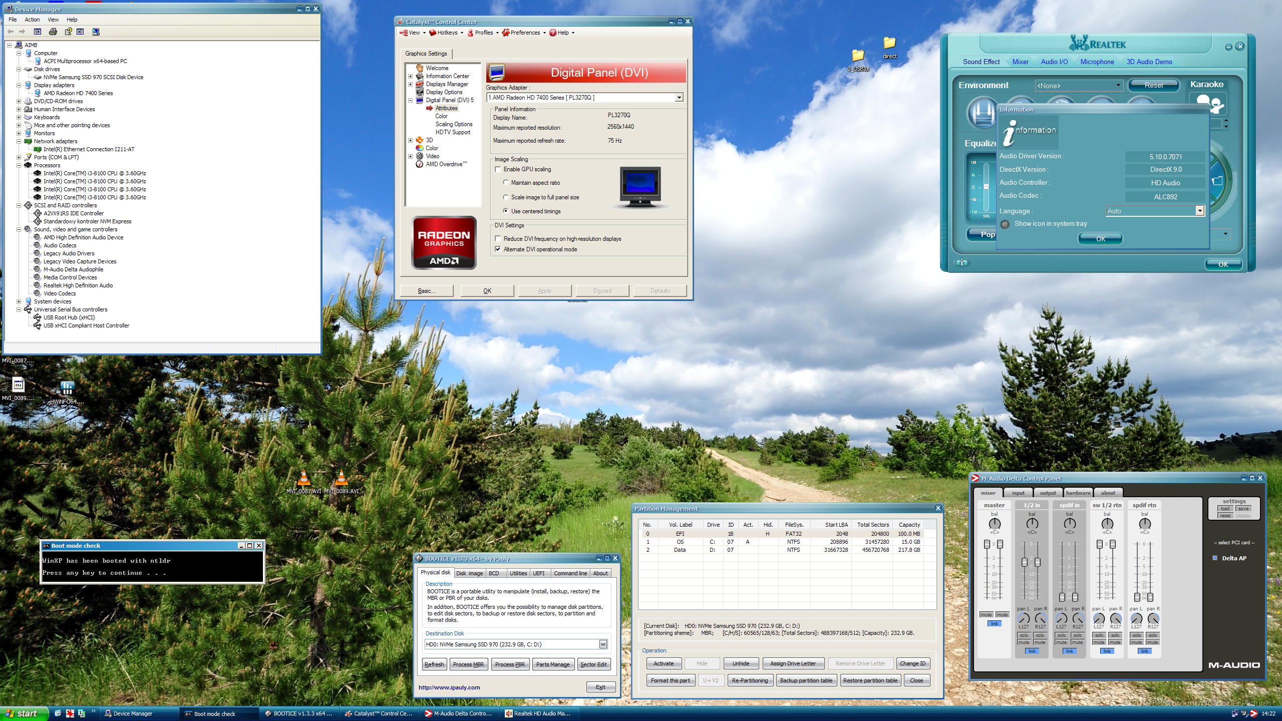

    Gelip wrote:
    No - I do not want to deny but find out where the limitation is because, for example, Windows 7 x64 can be installed in both BIOS and EFI mode and after the system starts it uses the same .dll or .exe files in both BIOS mode and EFI. Anyway, even WinXP doesn't use BIOS device drivers, only its own. I think it's just a matter of the bootloader because WinXP 64-bit for Itanium architecture supports booting from EFI using the IA64ldr.efi file:
    And I was right that it is just a matter of loader because you can run both WinXP x86 SP2 in EFI32 and WinXP x64 SP2 in EFI64. Of course, with the help of a few files from the test versions of Vista Beta2 (Longhorn). Tests were done in VMware Workstation 8. Everything is described in detail in the topic Does Windows XP have EFI? from the post https://www.betaarchive.com/forum/viewtopic.php?p=433345#p433345 " target="_blank" rel="nofollow noopener ugc" class="postlink inline" title="" > https://www.betaarchive.com/forum/viewtopic.php?p=433345#p433345
    The startup works automatically, but you can also boot the system from EFI Shell :
    Windows XP 64-bit & 32-bit: EFI Compatibility, GPT Partitions, Booting & Dual Boot Guide Windows XP 64-bit & 32-bit: EFI Compatibility, GPT Partitions, Booting & Dual Boot Guide
    The test was also done with one laptop with EFI64 + WinXP x64 but WinXP has a problem with displaying the image. After disabling all graphics drivers, i.e. uninstalling graphics card drivers and disabling services in the registry vga ( vgapnp.sys ) and VgaSave ( vga.sys ) the system starts up and everything works except the screen - you can connect via RDP if you turn on the remote desktop first. Details on betaarchive.com

    PS Like something, here are EFI files for booting WinXP 32 or 64-bit: xp_efi.zip

    Having recently had a lot of free time, I managed to complete the hardware on which the 64-bit WinXP starts and works under UEFI + CSM with a set of drivers. The motherboard is from the era Sandy Bridge for which the manufacturer provided drivers for this system - ASUS P8H61-M_LE R2 with CPU Intel Core i3-2120 3.30GHz. Plus a graphics card AMD Radeon HD6450 with Legacy video ROM.
    Interestingly - they only need to run the system under UEFI four files from the 64-bit test version of Windows Server Longhorn 2008 16497. These files are the loader bootmgfw.efi (renamed to bootx64.efi) and winload.efi, the font file wgl4_boot.ttf, and a BCD file with a few options. As the UEFI bios usually only supports the FAT file system, we need a FAT / FAT32 partition. It can be a flash drive, but it's more convenient as we have a separate partition on the hard drive - I made 100MB without a letter at the beginning of the disk just like the newer Windows installers do, and the system is on the second NTFS partition under the letter C: The partition style is MBR.
    I tested various other disk configurations and it could be either MBR or GPT:
    [*: c6c5491776] MBR, one FAT32 partition e.g. 5GB
    [*: c6c5491776] MBR, one NTFS partition + NTFS driver loaded e.g. from EFI Shell
    [*: c6c5491776] GPT, 100 FAT + NTFS partition per system [/ list: u: c6c5491776]

    If someone is interested, WinXP SP2 64-bit can be run in pure UEFI class 3 without CSM using the UefiSeven loader: https://www.betaarchive.com/forum/viewtopic.php?p=456492#p456492 " target="_blank" rel="nofollow noopener ugc" class="postlink inline" title="" > https://www.betaarchive.com/forum/viewtopic.php?p=456492#p456492
    The loader does such a trick that at startup, it inserts an INT10 interrupt call emulator in RAM at C0000 so you can run Win7 64-bit in UEFI without CSM and as it turned out also WinXP 64-bit :D

    A lot of free time again and another success :-)
    Using the EXP GDC 8.5c ExpressCard adapter and the same AMD HD6450 graphics card as in ASUS, I was able to run WinXP 64-bit in UEFI + CSM mode on a ThinkPad X220 laptop: https://www.betaarchive.com/forum /viewtopic.php?p=457234#p457234 " target="_blank" rel="nofollow noopener ugc" class="postlink inline" title="" > https://www.betaarchive.com/forum /viewtopic.php?p=457234#p457234

    I have written a tutorial on how to build a WinXP SP2 64-bit ISO that works on modern PCs with SATA or NVMe drives in UEFI or Legacy (in Legacy only on MBR):
    WinXP 64-bit on a modern PC (ISO boot.wim + install.wim) .
    Tested on Intel Gen 1 to Intel Gen 12. On laptops where the touchpad (I don't know how the keyboard) is connected via I2C bus instead of USB the mouse and/or keyboard will not work - you have to use a USB keyboard and mouse. There is a ported HIDI2C driver for WinXP 64-bit but I have not tested it.

    Out of curiosity and boredom, I also made a tutorial for WinXP 32-bit on a modern PC:
    WinXP 32-bit on a modern PC (ISO boot.wim + install.wim) .
    Ideally there is a CSM option in the bios but it should also work under UEFI32 e.g. on computers with Bay Trail processors. Tests under UEFI32 in VMware ESXi, Workstation and QEMU positive :-) .
    Command prompt with messages about UEFI boot mode and disk management. Windows XP Device Manager on a VMware Workstation virtual machine with a boot mode check message. Screenshot of Device Manager and System Information on Windows XP on a modern computer. .
    And of course on a real PC with UEFI64 bios but in CSM mode - test on a mobo with Intel Gen 8 CPU:
    Terminal screen showing DiskPart usage on WinXP SP2 32-bit on a modern PC. Screenshot of Device Manager in Windows XP showing Intel Core i3-8100 processors. .
    Added after 37 [minutes]:
    In both 32-bit and 64-bit versions, I added support for IDE drives (driver pciide.sys ). - Thanks to this, the installers also work on older computers with some Intel IDE controllers
