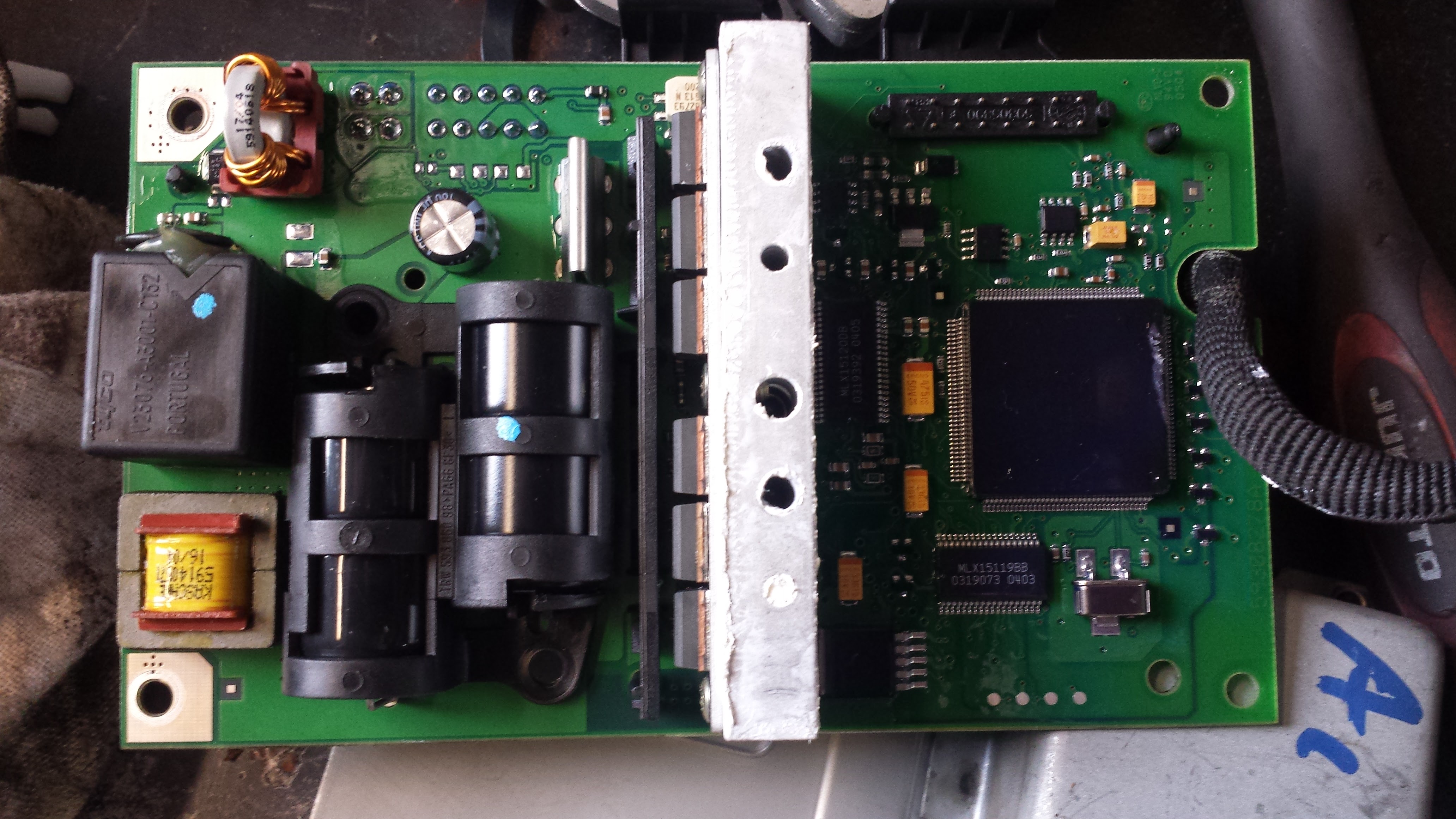

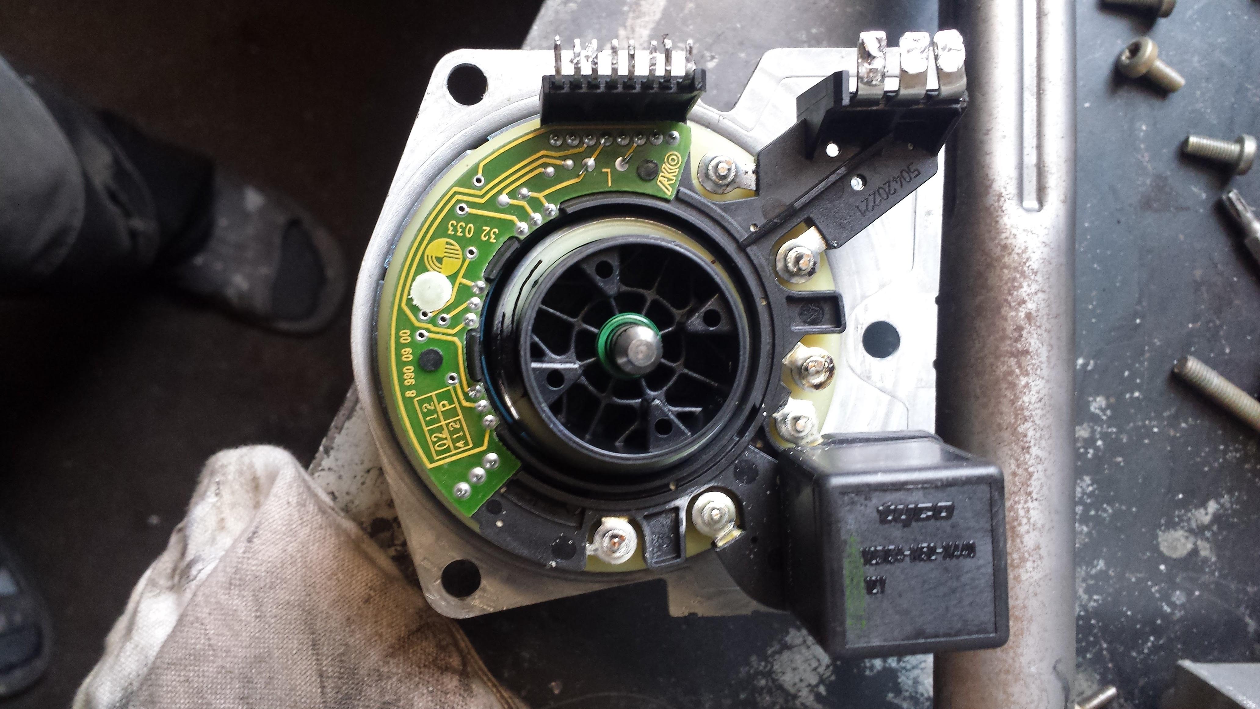

    Hello, I have a problem with Fiat Stilo 1.9 jtd 2004 with assistance.
    Of course, there is no support, and the errors are c1007 electrical motor and c1013 esp electric steering (NGE). Errors can be cleared, but c1007 returns. I noticed in the parameters that there is no indication of the steering angle and it cannot be calibrated. TRW support. I undressed because I thought the sensor was removable as in corsie but here it is quite different, pictures below. Colleagues, where to look for a problem?
    Regards

    good brushes in the motor? How do you replace the power support, possibly cables to check

    it seems to me that this is not a brush motor ...

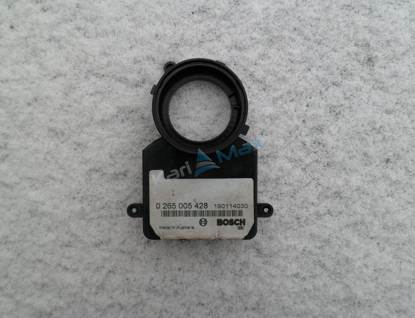

  • #4 16437472
    KarizmoGSM
    Level 28  
    Posts: 1151
    Help: 95
    Rate: 292
    The steering angle sensor is on the combined switch.
    I don't know why you did extra work for yourself.
    If you want, I have lots of parts for stilo!

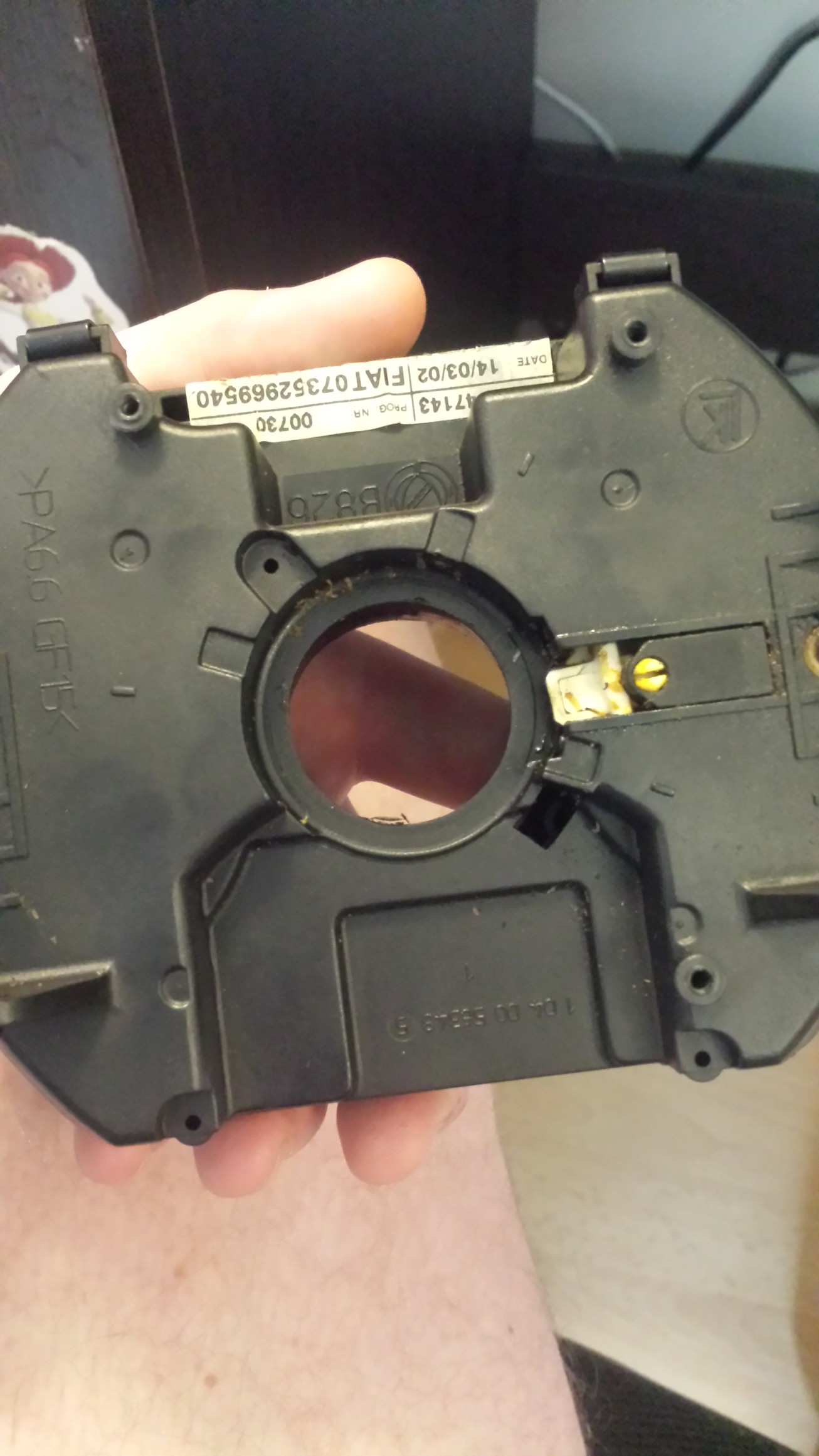

    where is this sensor? Fiat Stilo 1.9 JTD 2004: Power Steering Issues, C1007 Electrical Motor & C1013 ESP Errors
    my version doesn't have it:

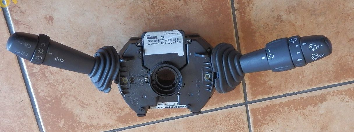

    Hehehe, because you have it dismantled, so you didn't have it at all !!!
    This is how it looks combined with the sensor

    well, but the support worked, so in this version it is not the sensor that counts the angle for support, I think this one is for the version with traction control ...
