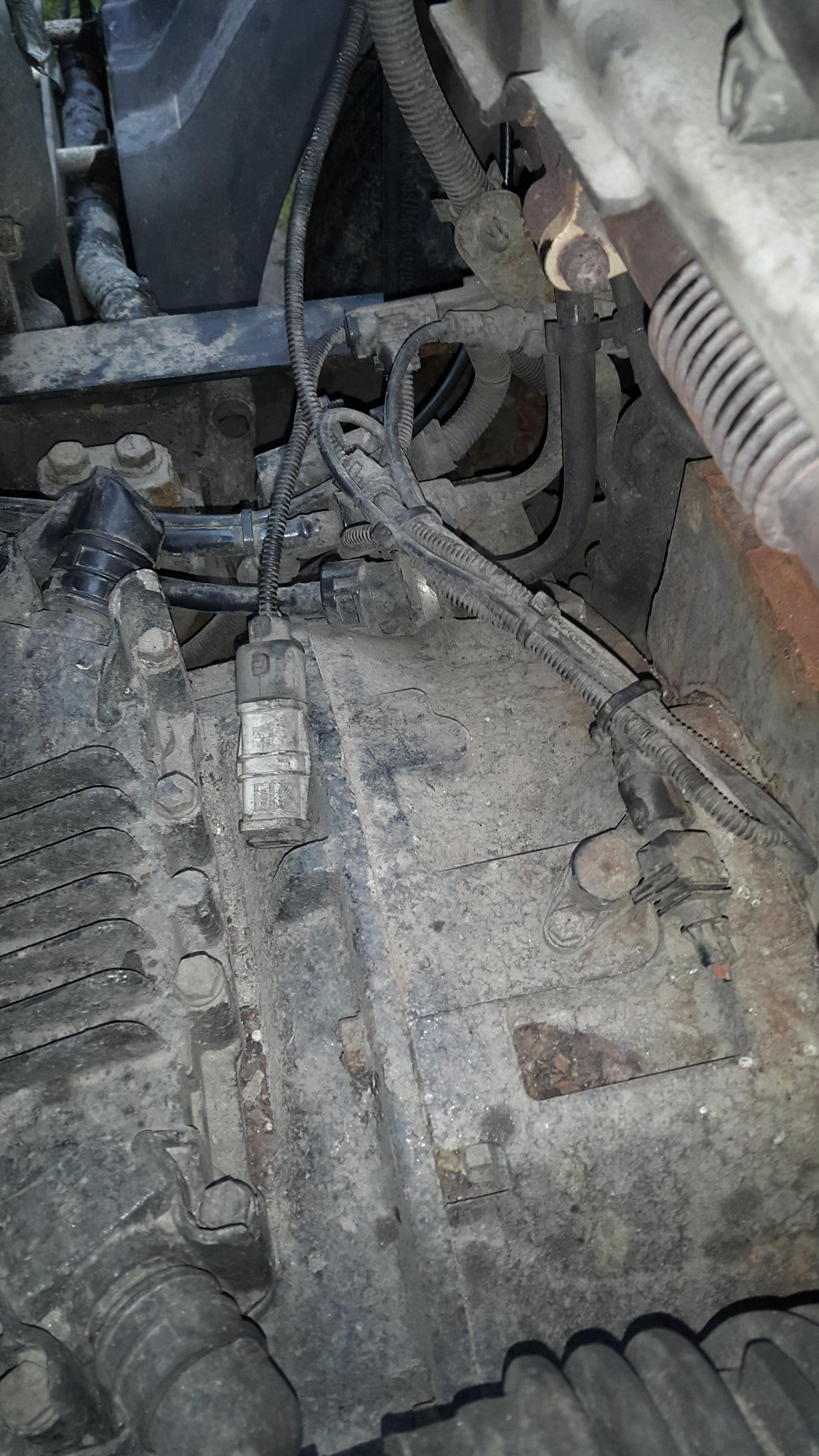

    Hello, man, the problem with tgl burns about 30 liters with normal driving. I went to the mechanic and he checked everything on the computer using the man cat program. No errors, there were 5.4 ms injections, all the same parameters. The revolutions of the 710 engine are the same all the time. The only problem was the combustion temperature because it showed 300 C. I will add that the car is loaded or empty, the same goes. It's going very well. On the road I caught 2 errors 03779-01 and 03785-01. Burning on the computer shows 20 l. But I suspect the wine was fueled until I refueled at another station and it was OK. What's up where to check. How do you have any ideas what to check. Under it tells me where to find the lambda probe, I would try to disconnect it. best regards

    Both bugs were in EDC. Can you tell us where the exhaust gas temperature sensor is? And what are these cut wires for? Man Tgl 12.240 2007 - High Fuel Consumption Issues, Engine Revolutions

    EDC 3785 is associated with the catalytic converter, which can also be associated with increased fuel consumption. The diagnostician should do a test drive with ManCat connected and the exhaust pressure monitoring before CAT. This signal is not specifically monitored for a fault by the EDC so no error will occur. Any pressures above 0.2 bar indicate a plugged catalyst.

    often in this model the lambda probe or a bent socket around it in which it is installed for repair.

    I also think that the lambda probe may be damaged. Maybe someone knows where this probe is?
  • #16 16446954
    kakibara
    Level 35  
    Posts: 2379
    Help: 202
    Rate: 1284
    On the silencer in front of the harmonica - flexible, only as I wrote to you above, the probe will generate an error, cracked, broken, damaged cable, disconnected plug, internal error in the computer - so it's probably a waste of a thousand for a change if it's ok?
