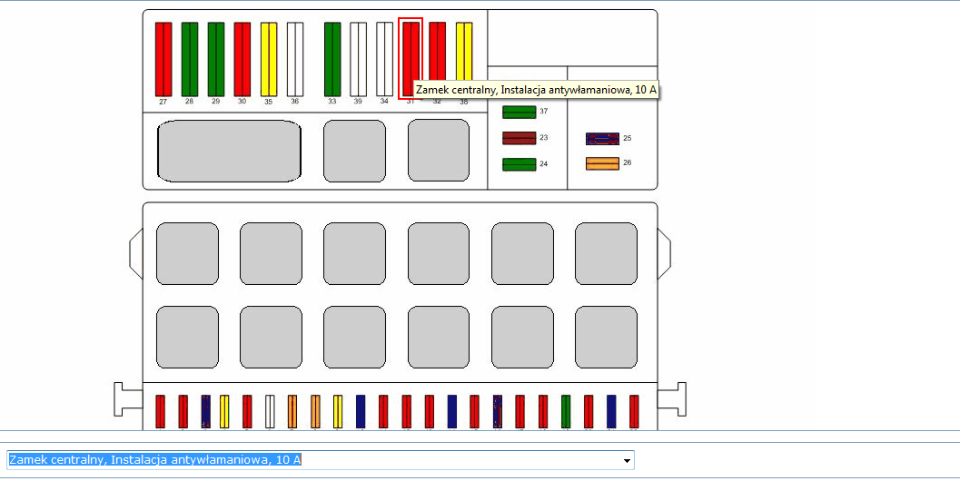

    Hello. I have a fuse scheme for the Ford Galaxy (supposedly for my type and vintage) but in my car it looks a bit different. Specifically, I wanted to find out where the fuse is, possibly a relay from the central lock, fog lights and reversing lights. I would like to add that everywhere I was looking I found nothing specific about this topic. I found the most answers regarding the switch - the reversing light sensor and I mean the fuse and not the sensor or the switch. My car is Ford Galaxy 2.3 DOHC 1997. (B + G). I greet all forum members and ask for some hints.

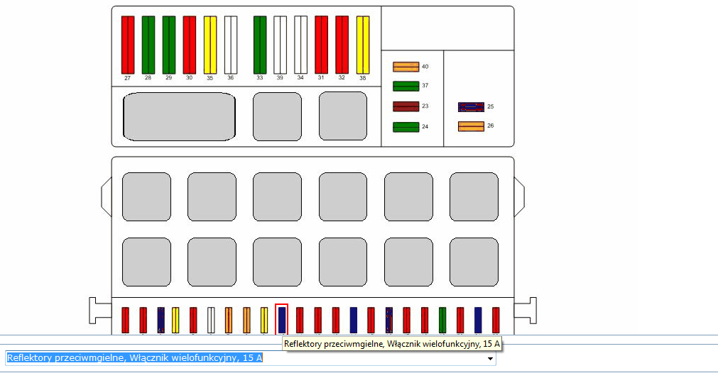

    Reverse headlamp 15A fuse No. 5 or 14, depending on the fuse box inside the car.

    You have such a box

    The box looks the same as in my Ford.

    I am still looking (in the fuse box) of a fuse or relay from the central lock.

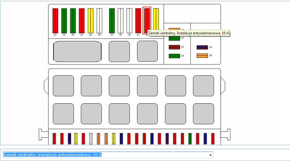

    I've found it yet

    Thanks for these box schemes. After the May Day, I check and let you know what the effect is.

    Welcome back. Yesterday I checked places indicated by colleagues "mirekfm" and "paper clip" but nothing changed. The fuses are good, the wires connecting the tailgate I connected (those interrupted) and the fog is still missing. The reversing lights have already sensed that the sensor will be replaced. I thought that these schematic boxes from my friend "mirekfm" are the same as mine but there is a small difference in the upper part, my box looks like this Ford Galaxy 2.3 DOHC 1997: Locating Fuses for Central Lock, Fog Lights, Reversing Lights maybe someone has the same.
    Added after 3 [minutes]:
    Maybe this picture will be better visible. Ford Galaxy 2.3 DOHC 1997: Locating Fuses for Central Lock, Fog Lights, Reversing Lights
    still asking for a hint on how to match what is under these fuses. I tried but there is resistance and I do not want to break something.
