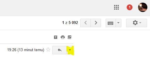

    At the stage of copying to the clipboard in the clipboard there is the content of the bottom window (below the blue key). This is the EML format.
    Maybe again with pictures:
    1. Click on the "More" icon:
    Gmail: Save Entire Email Content with Attachments to Disk using Mozilla (Drag/Drop Plugins)
