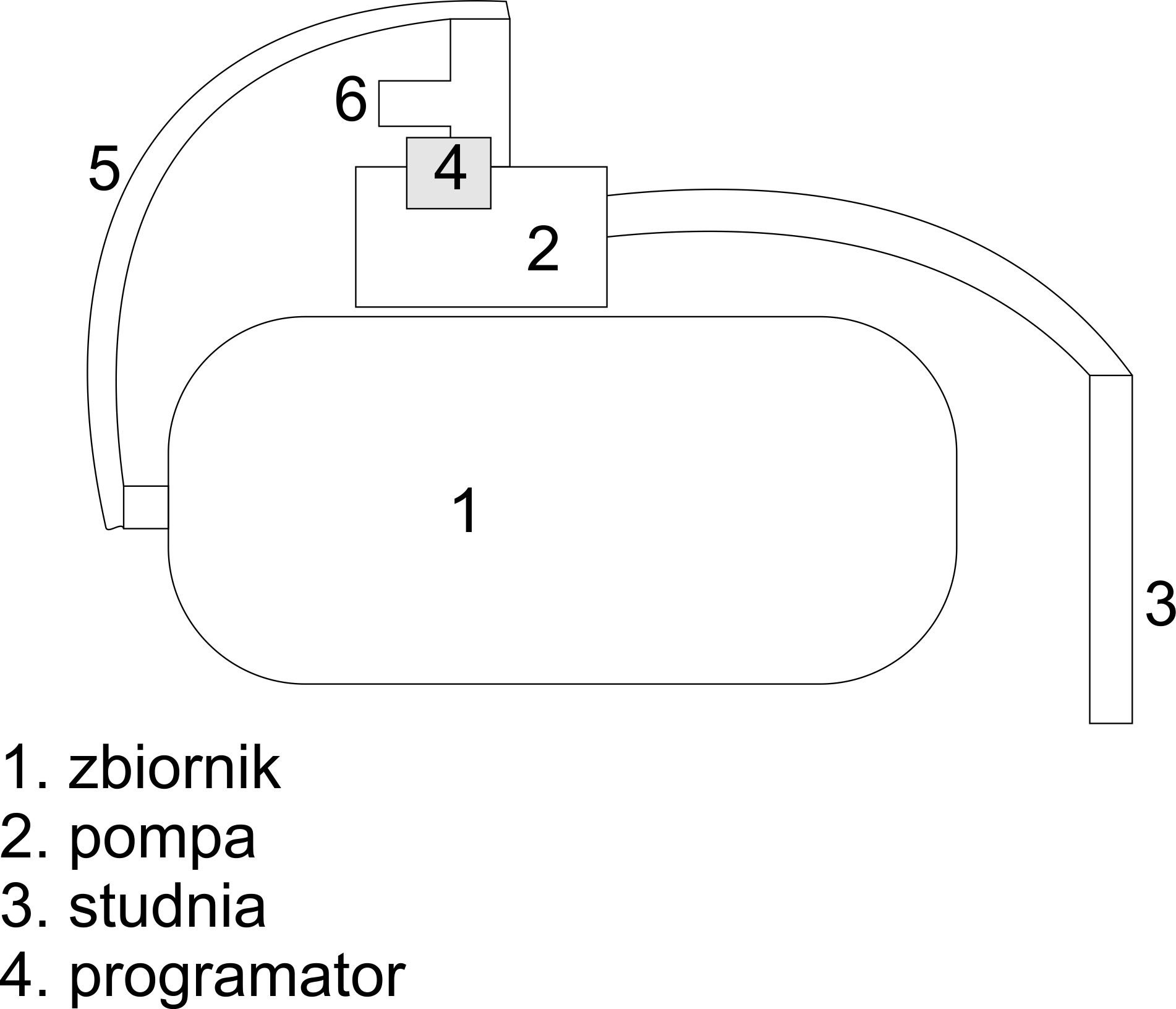

    Hello, I have an IBO jsw150 hydrophore. The pipe draining the water to the home installation broke off, after installing a new one, the hydrophore cannot reach the set pressure, the pointer swings at about 1 bar. I checked the pressure in the diaphragm (after draining the water) - there was nothing, I pumped up to 1.5 bar, unfortunately the hydrophore still does not reach the pressure. What could be the cause? Should the pipe leading from the tank not be connected to the place where I have a drain to the installation?

    Hello. At the beginning, it is necessary to check whether the pump is air-tight, possibly prime it and try to restart it.
    Is there a non-return valve in the pump section, well?
    We assume that there is water in the well.

    there is no check valve. sucks water into one bar and howls,. when I turn on the water in the garden, it is water because the pipes are more in a straight line from the hydrophore but there are no more at home because the pipe goes up and I have no strength. There are large air bubbles in the roses leading to the installation. the hydrophore is flooded when I unscrew the priming screw, it is water

    Check buddy the pipe from the well to the pump, there's probably a leak somewhere.
    Also the pump itself and the seals to be checked.
    This pump has been working until now?
    Is it the first start after the winter break?

    You have 100% no water in the supply pipe and no check valve is an error, unless it is fitted to the pump.

    Hello! Buddy, I need to verify that the pump is not damaged.
    To do this, you should close the outlet to the installation, connect the pump with a short pipe section with a water tank of about 30 liters, prime the pump and start it, if the pump is good, the pressure will increase very quickly. After such a procedure, we will know what could be the cause of this defect.

    I replaced the pump and everything works, thank you all for your help
