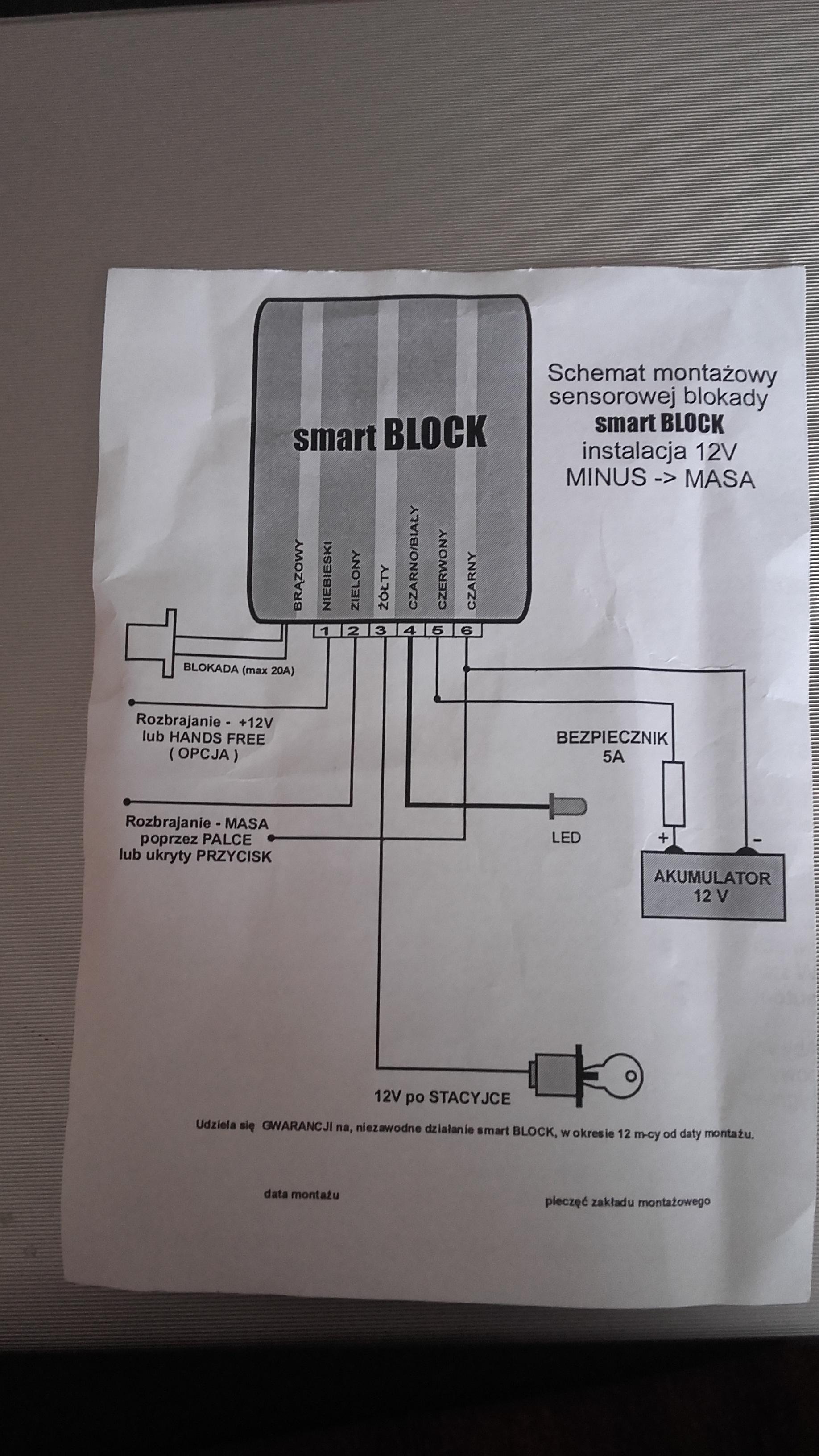

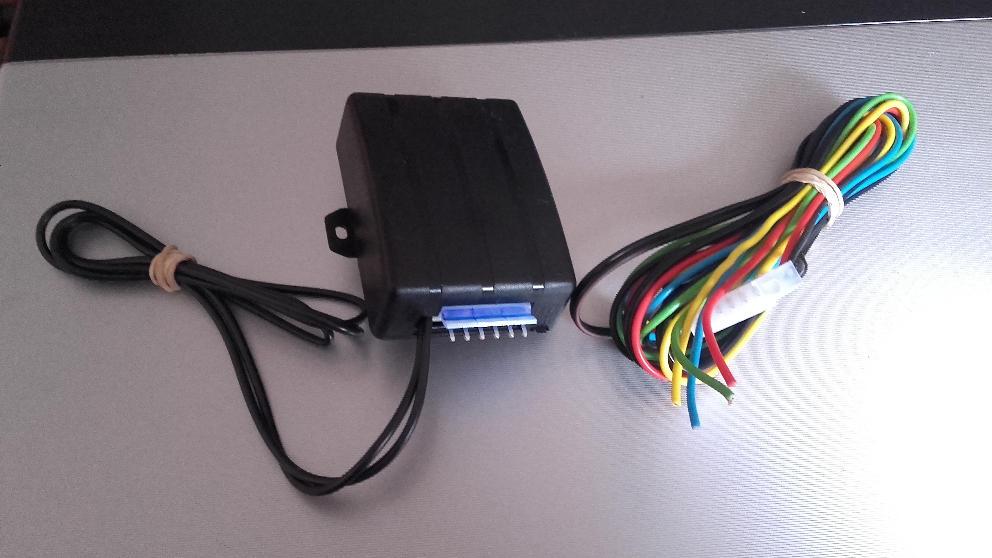

    Tomorrow I am assembling the ignition cut-off to my A6. Can anyone tell me where to connect exactly so that the cut-off module does not make errors in the computer?
    I'm going to plug in the ignition wire going to the starter and the wire going from the fuse to the fuel pump.
    Can someone else have installed something like this and can tell me how to do it better? Below is a diagram of the module.
    Audi A6 C6 - Installing Ignition Cut-off Assembly: Wiring Connections for Starter & Fuel Pump Audi A6 C6 - Installing Ignition Cut-off Assembly: Wiring Connections for Starter & Fuel Pump Audi A6 C6 - Installing Ignition Cut-off Assembly: Wiring Connections for Starter & Fuel Pump

    What's he so angry at? You are the first person to give me any answer about this device. I thought you didn't need some big electronics for this and the whole trick is a clever way of disarming.
    The car is petrol 2.4
    EDIT
    I'm already after. The assembly took about 4 hours. Everything works. It was a bit of a struggle to find the appropriate cables in bundles, but it worked. In about half a year I will try to add if I am satisfied
    and whether anything has fallen in the meantime.
    Edit2
    So, after 3 months of use, nothing happened. Cutting off works great. No CH errors in the computer. I would recommend.
