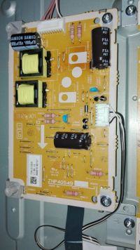

    I have a problem with the Panasonic TX-L42B6E LCD TV. When you try to start the TV, the matrix flashes (blinks) and turns off after a while.
    What I did: I replaced the electrolytic capacitors on the TNP4G549 board. Unfortunately, no effect.
    I would like to ask for any suggestions, advice what I could possibly check or replace in order to remove the fault.

    Leds to check.

    I checked the voltage on the connectors coming out to the LEDs.
    With the leds connected, the voltage on the first pair jumps from about 48 to 85VDC.
    However, on the second pair, the voltage fluctuates up to max .: 10VDC.
    After disconnecting the first pair of LEDs, the matrix continues to blink.
    After disconnecting the second pair of LEDs, the matrix does not display anything, it does not even start.

    LCD-LED-PDP wrote:
    Undress and measure the stripes.
    Thanks for targeting the source of the failure.
    You were right, the LED strips are broken ...

    Bieri13 wrote:
    The LED strips are broken ...
    Well, replace it with a functional one.
  • #9 16480330
    Bieri13
    Posts: 168
    Rate: 30
    There are too many of them to be replaced.
    There are 4 rows of stripes. Each row of LEDs consists of two modules, 5 LEDs each.
    For me, I have damaged single pieces and entire modules.
    For the inquisitive, he gives the designation of my belts: row2.1 rev 0.0 l1-type 6916l-1338a
