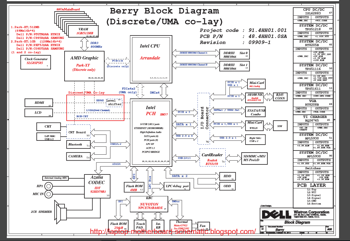

    You have an Intel or AMD CD M 5010?
    DELL N5010, Intel, MB 48.4HH01.011 (wistron)
    - gpu (216-0772000) / * (216-0774007) * (216-0729042)
    - HM57
    - NPCE781BA0DX

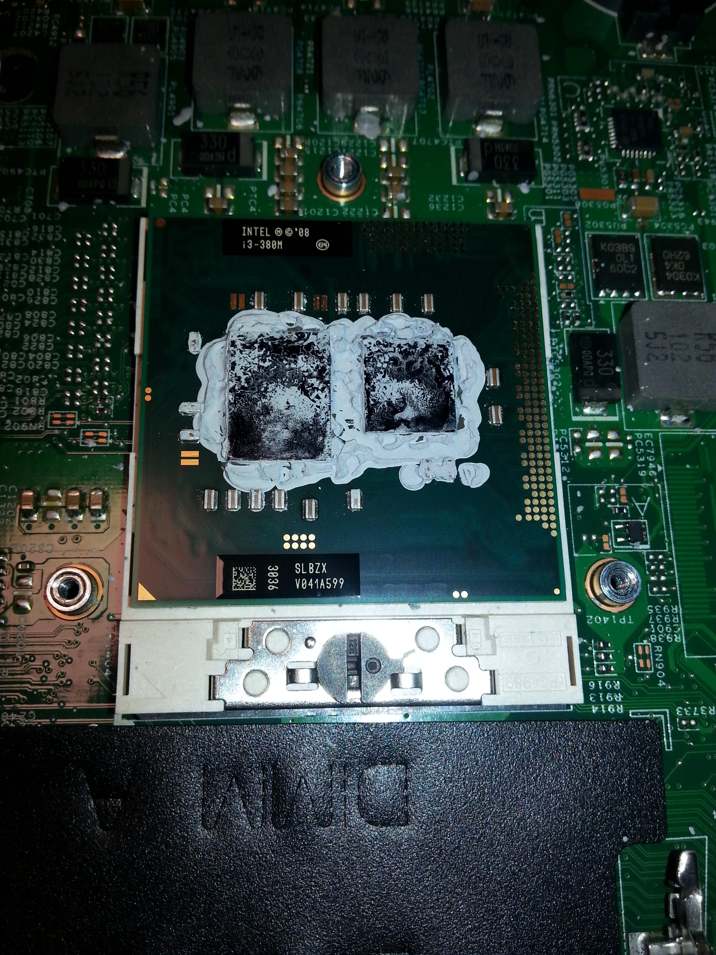

    So it's likely that something has fallen on the motherboard?

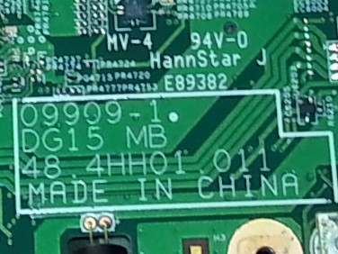

    Such markings are on the motherboard:
    Dell Inspiron 15R N5010 - When turning the peak on 4 times, no image.

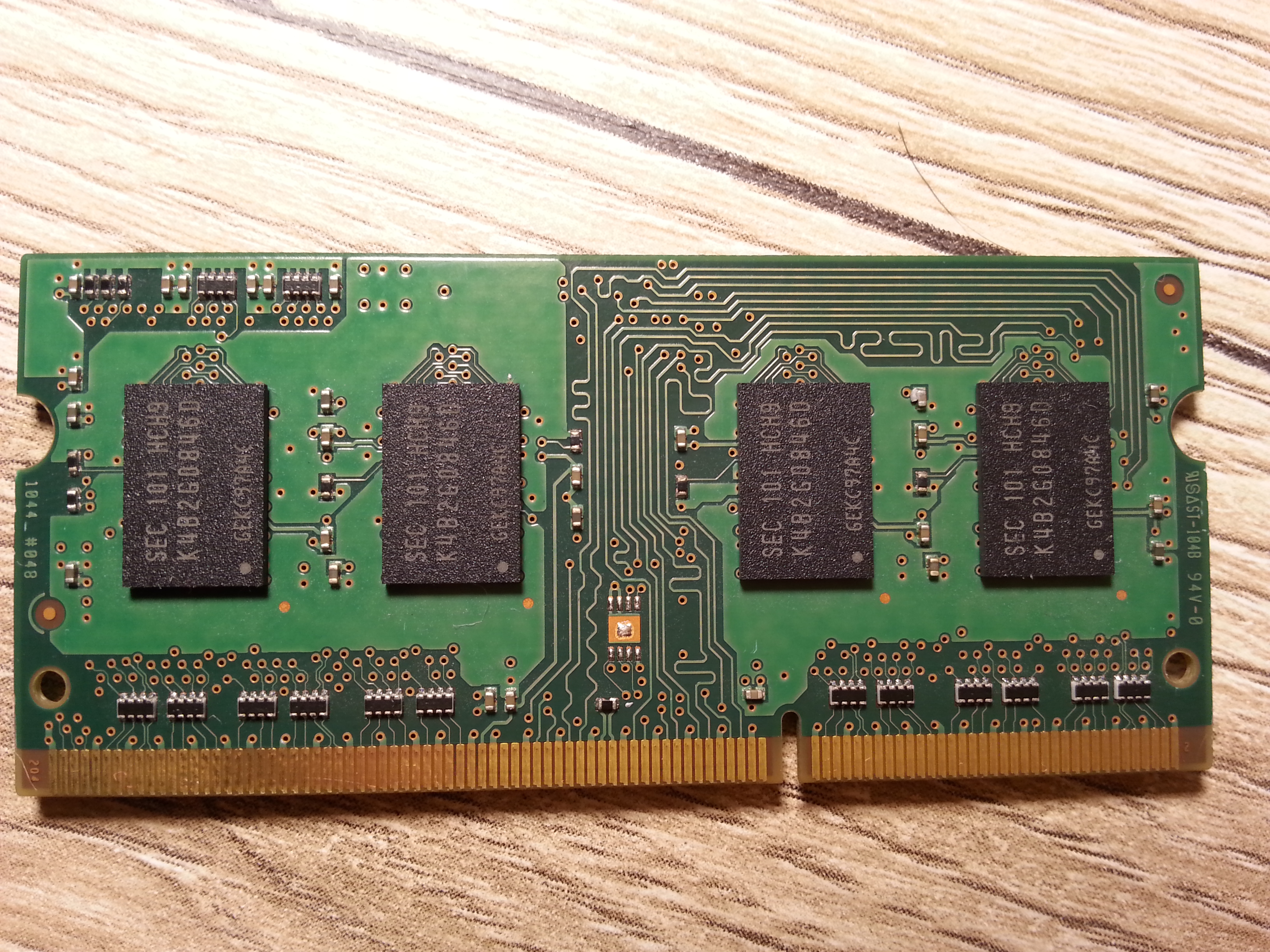

    All you have to do is "fall"!

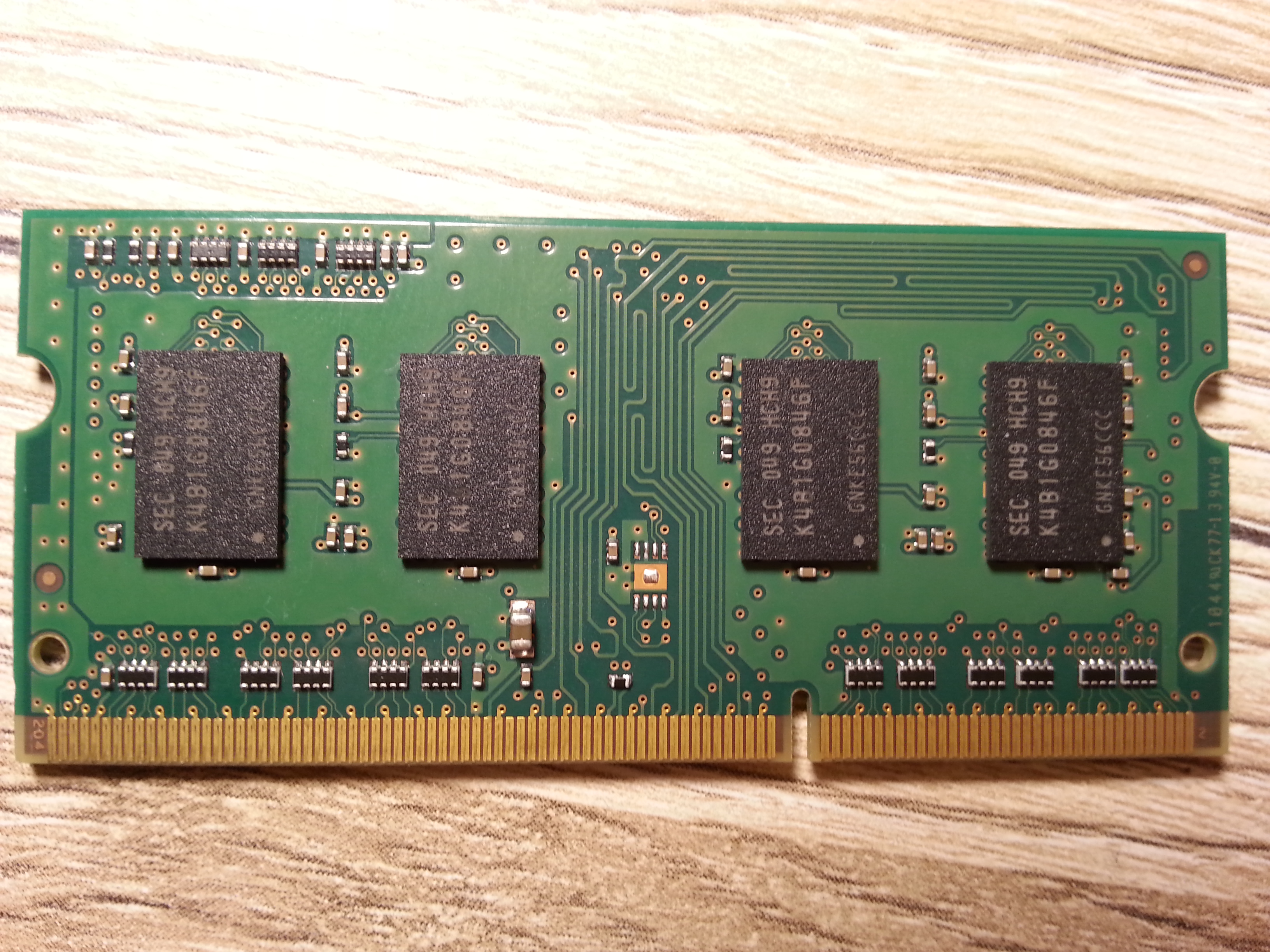

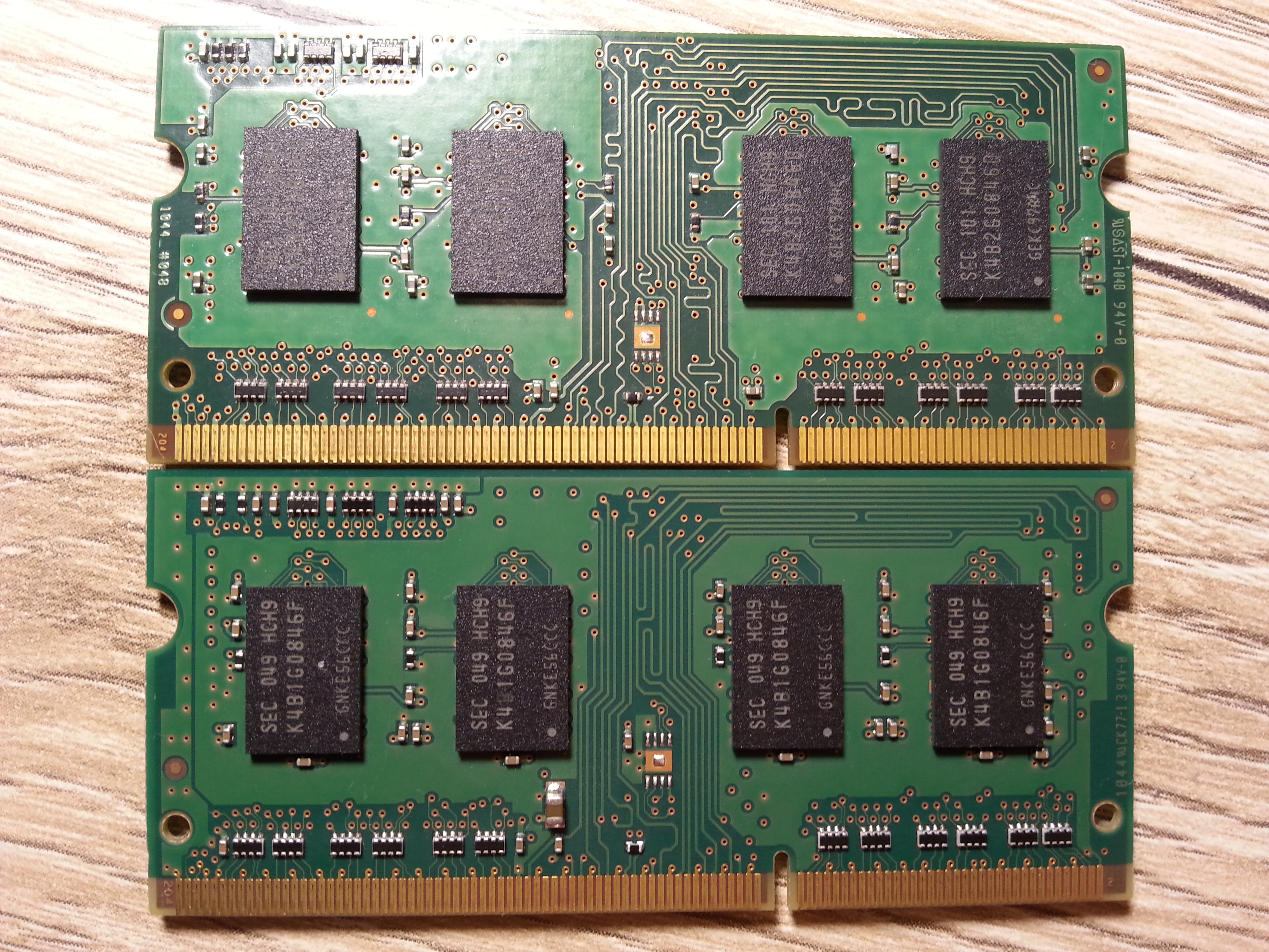

    Provide a photo. these RAMs.
    DDR3 PC3-10600, DDR3 PC3-12800 with a maximum of 4GB per slot.
    * 1.5V *
    As I wrote: check the RAM itself on another laptop that supports it or on a local PC site (town where you live)

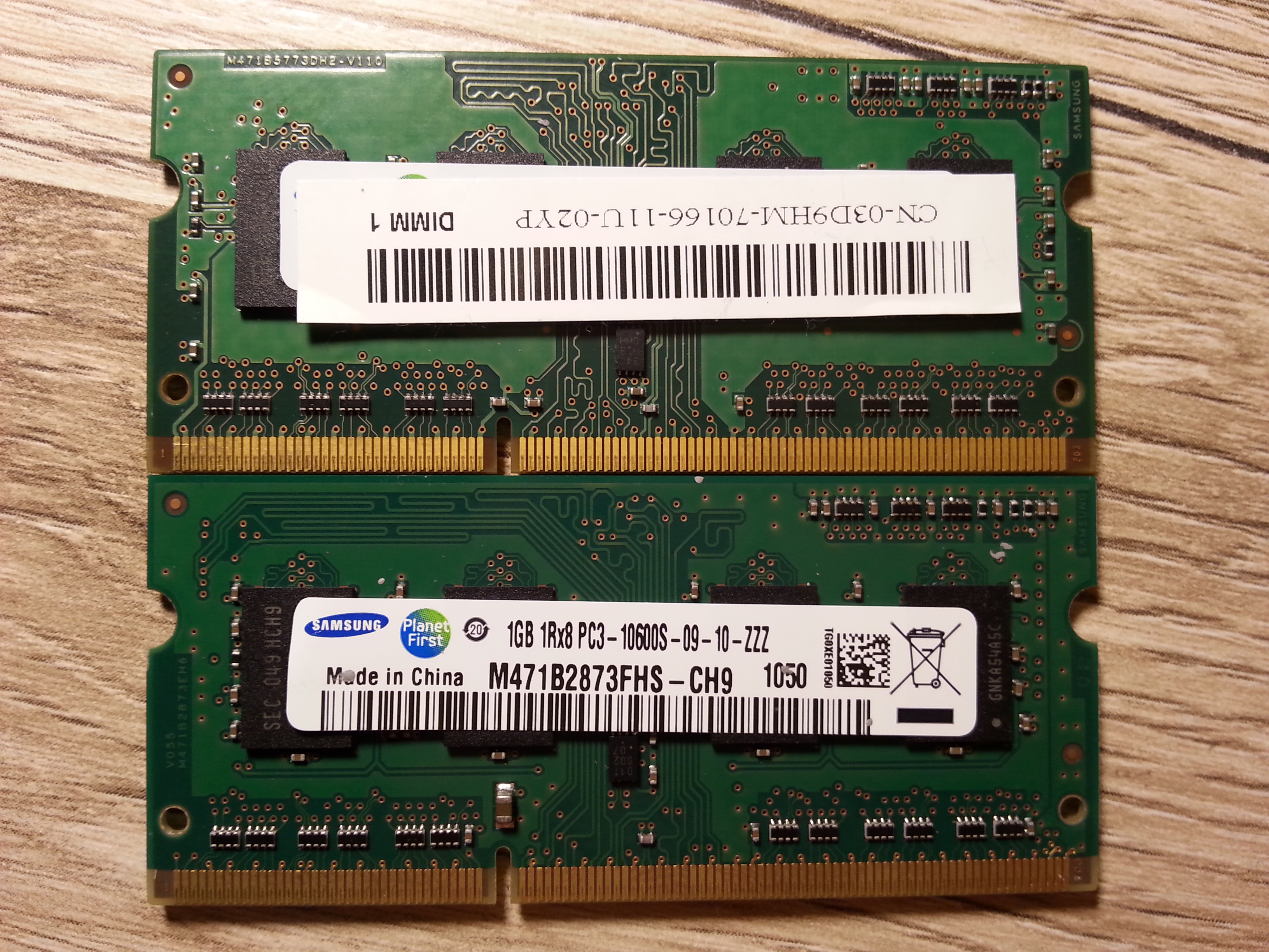

  • #7 16469000
    Kobey22
    Posts: 516
    Rate: 37

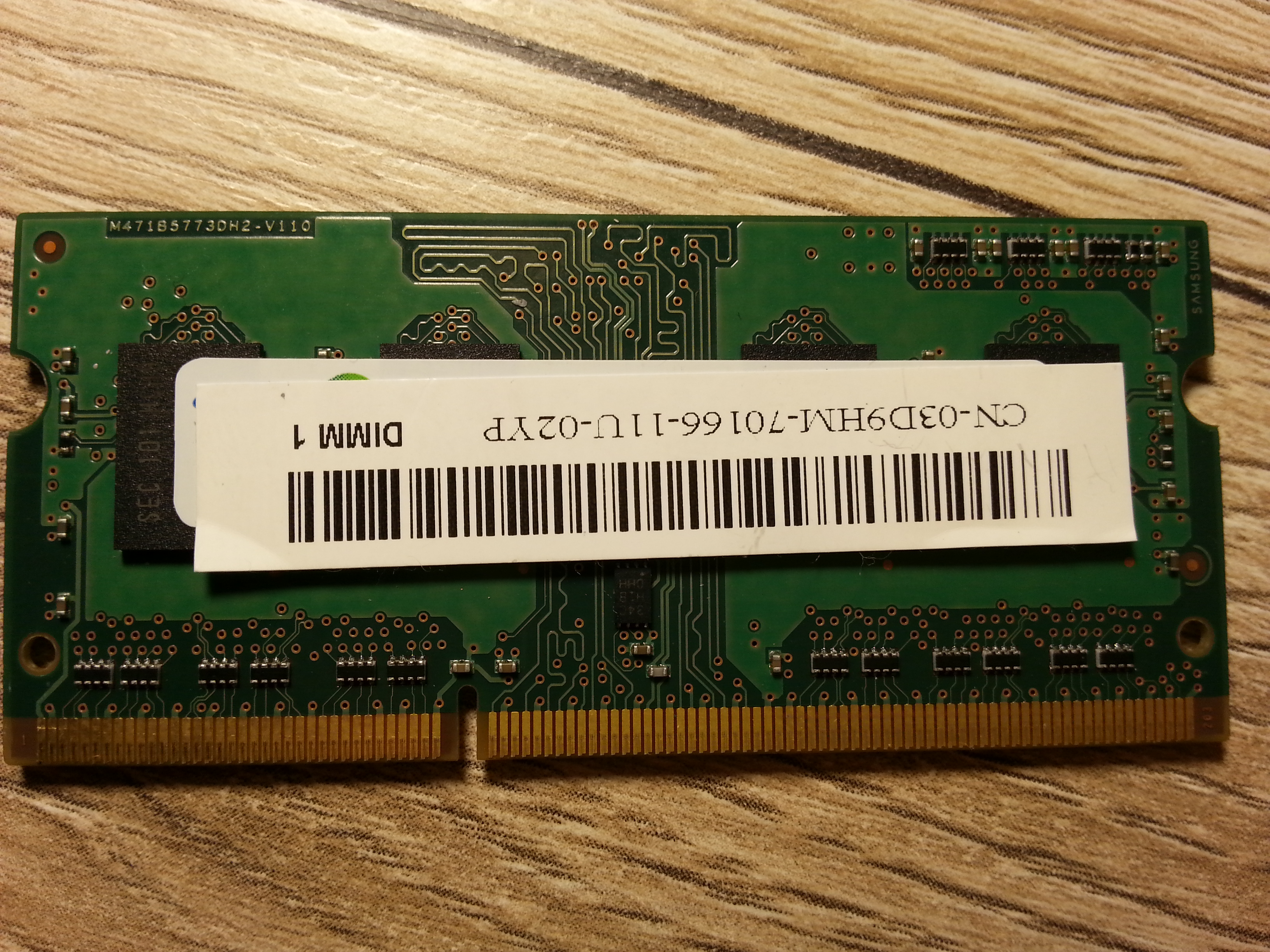

    I will have to give somewhere for testing because I have no way of checking.
    The laptop I have supports DDR4.
    As are the markings on the RAM: DIMM1 and DiMM2.
    I put DIMM1 in the 1-4 beep slot, black image.
    I put DIMM1 alone in the 2-4 beep slot, black image.
    I inserted DIMM2 myself into the 1- 4 beeps slot, the black image.
    I inserted DIMM2 myself into the 2-4 beep slot, the black image.
    DIMM1 in the slot 1-4 beeps, black image.
    DIMM2 in the slot 2-4 beeps, black image.
    DIMM1 in the slot 2-4 beeps, black image.
    DIMM2 in the slot 1-4 beeps, black image.
    Dell Inspiron 15R N5010 - When turning the peak on 4 times, no image. Dell Inspiron 15R N5010 - When turning the peak on 4 times, no image. Dell Inspiron 15R N5010 - When turning the peak on 4 times, no image. Dell Inspiron 15R N5010 - When turning the peak on 4 times, no image. Dell Inspiron 15R N5010 - When turning the peak on 4 times, no image. Dell Inspiron 15R N5010 - When turning the peak on 4 times, no image. Dell Inspiron 15R N5010 - When turning the peak on 4 times, no image. Dell Inspiron 15R N5010 - When turning the peak on 4 times, no image. Dell Inspiron 15R N5010 - When turning the peak on 4 times, no image. Dell Inspiron 15R N5010 - When turning the peak on 4 times, no image.

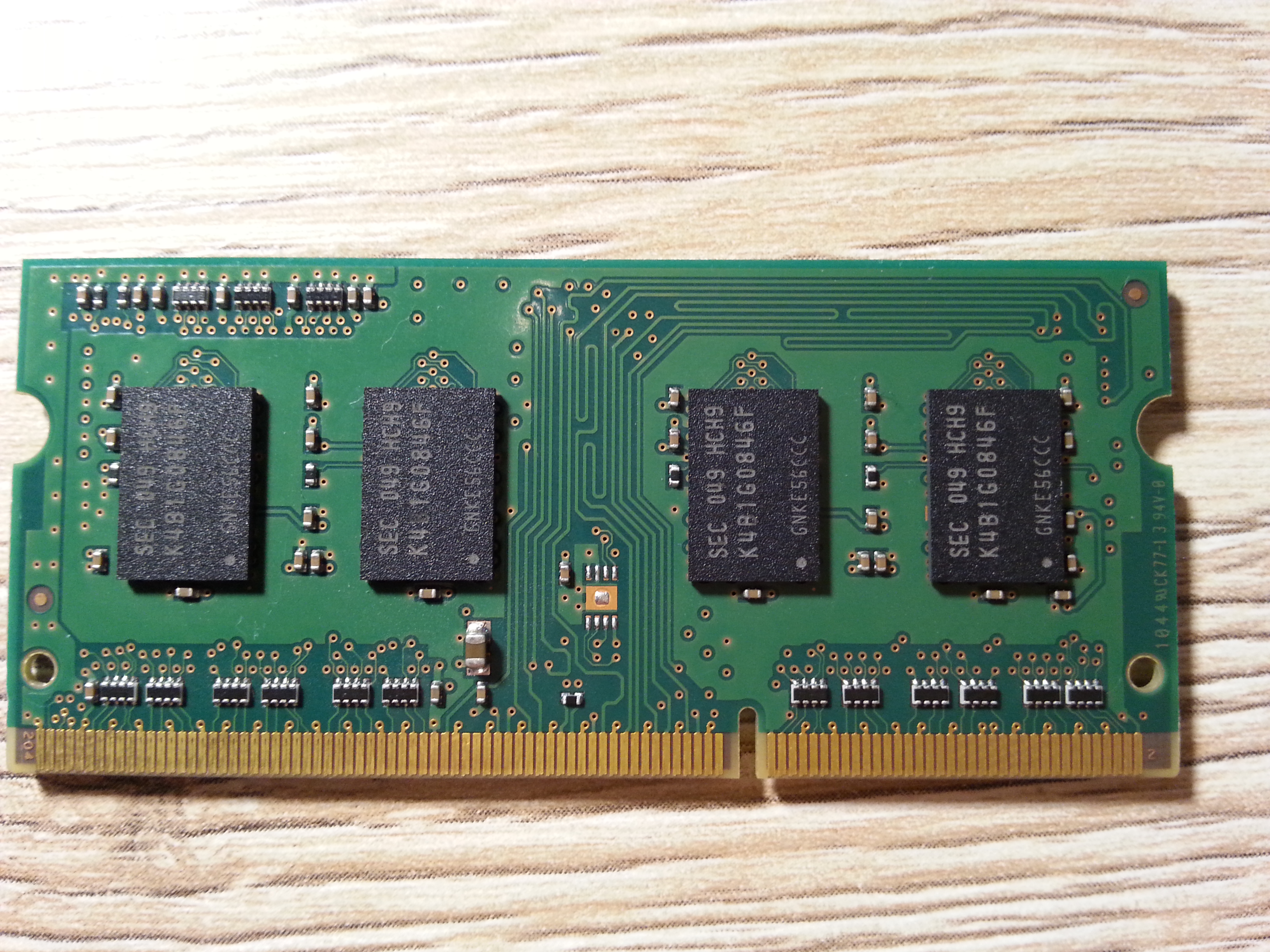

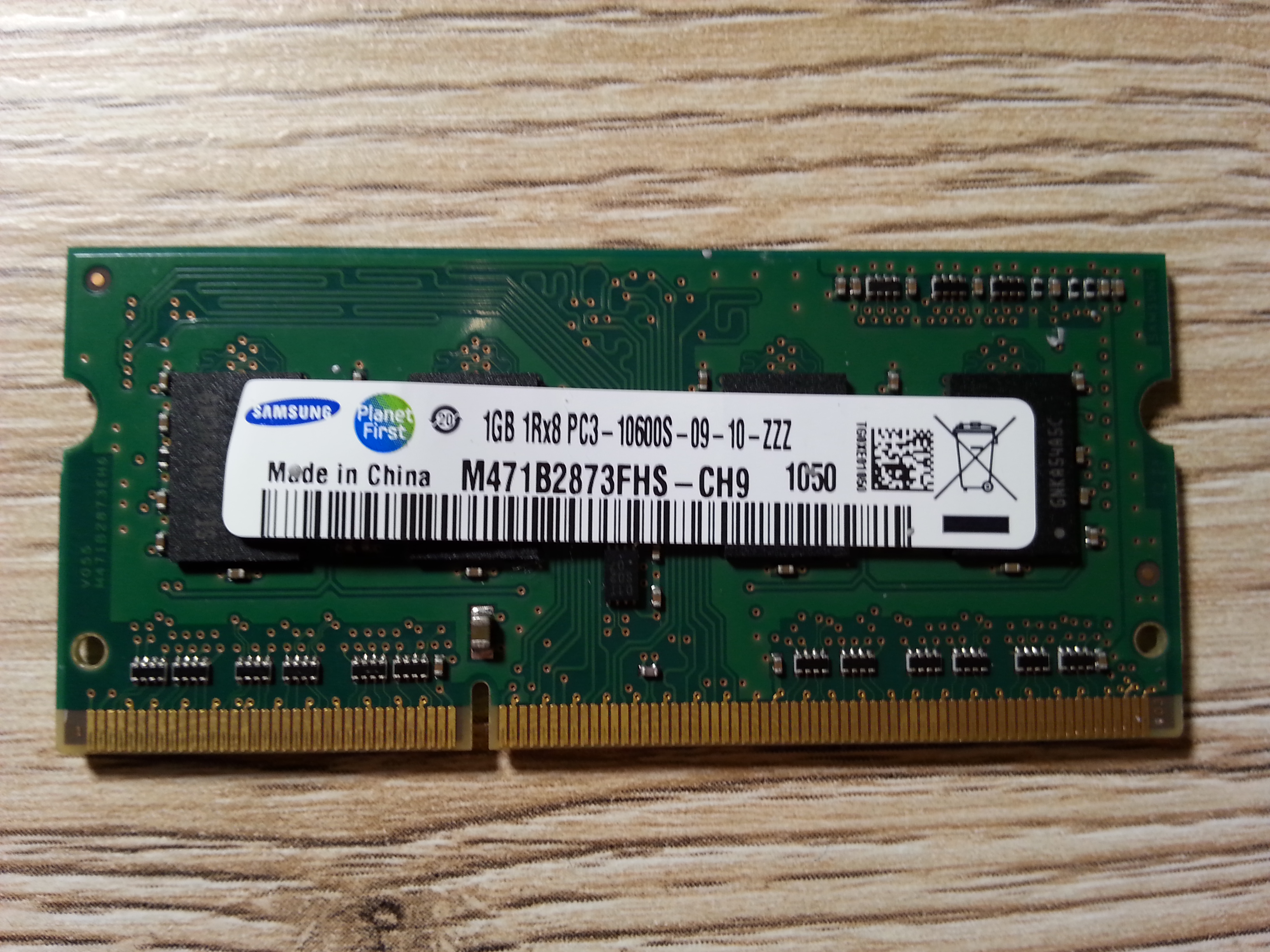

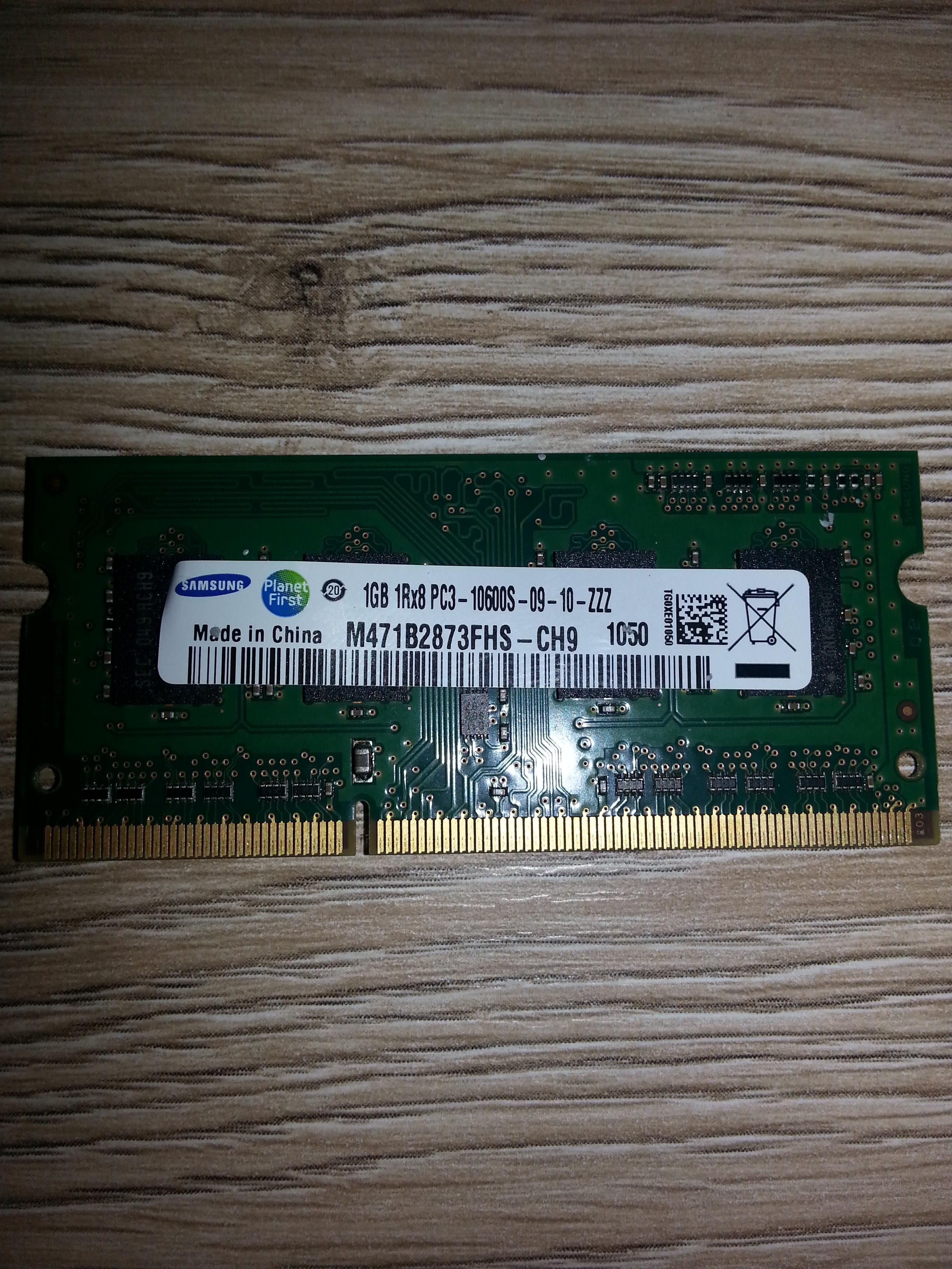

    Take them to the site, let them check
    It's RAM from
    M471B2873FHS-CH9
    Samsung 1GB PC3-10600 DDR3-1333MHz
    * non-ECC Unbuffered CL9 204-Pin

    From the last description> rather something on the disc.

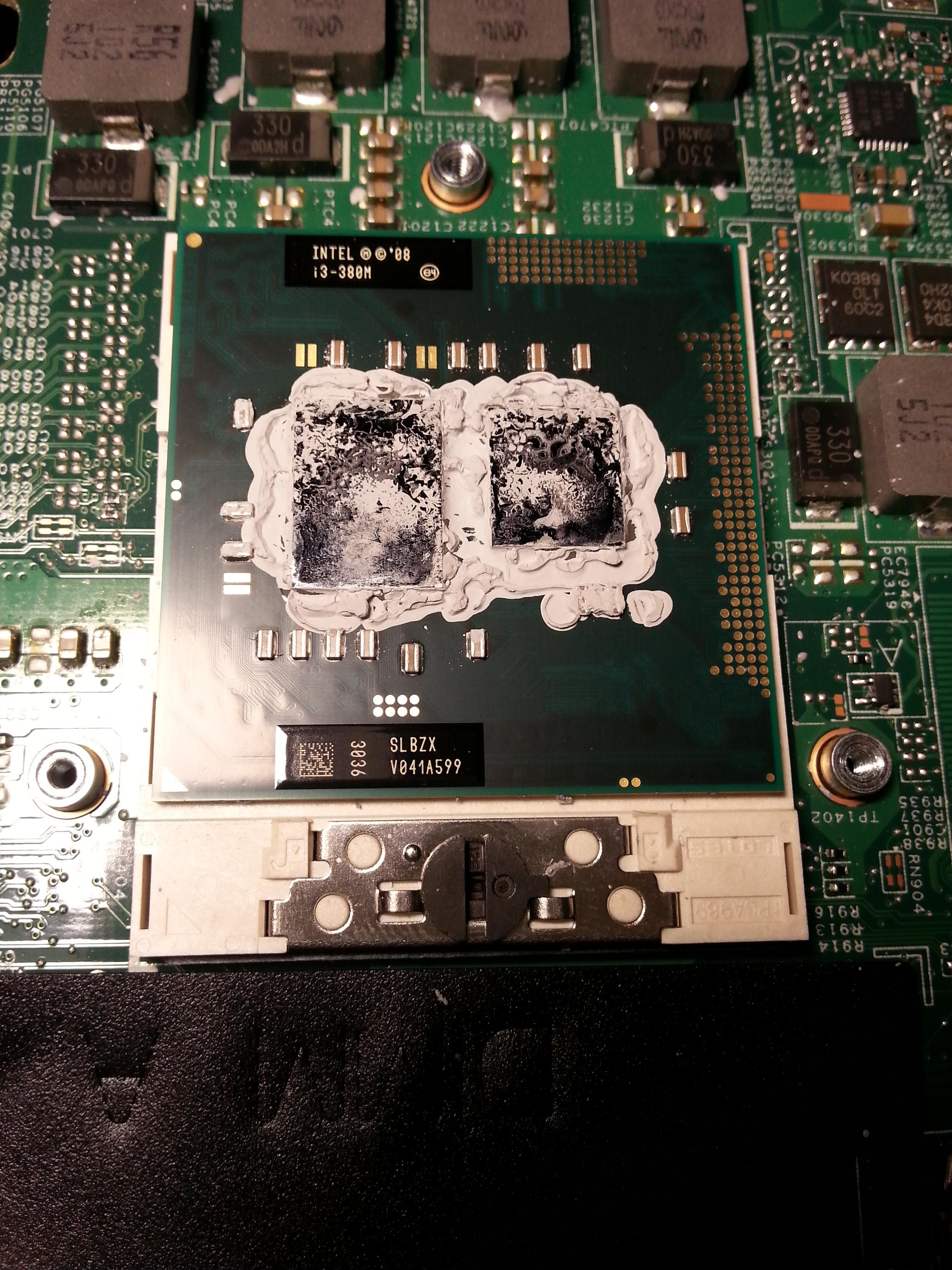

    Looking at photos from the beginning. topic, you have col .:
    - ver. UMA> without additional graphics
    - Core i3-380M (SLBZX) cpu
    - HM57 chipset

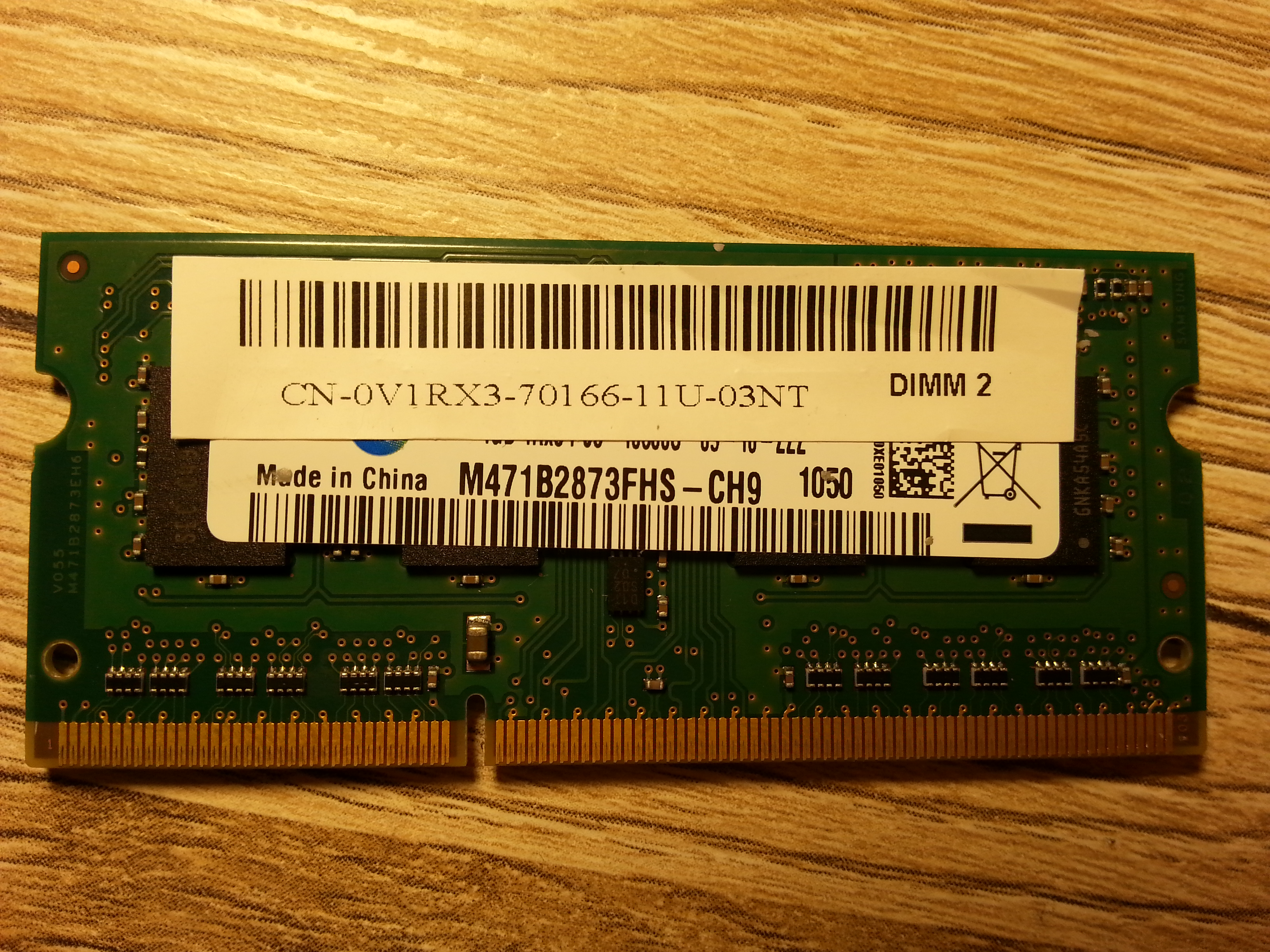

    I had another laptop today. In this other laptop there was one RAM chip it had 4 GB
    I pulled out this RAM chip and put it in a Dell laptop (described in this topic).
    I put the bone from another laptop (4 GB) into the Dell laptop (described in this topic) in slot 1 then 2.
    If the RAM from another laptop (4 GB) was in:
    -Slot # 1- Black image and 4 beeps
    -Slot No. 2- Black image and 4 beeps
    RAM memory chips from a Dell laptop (described in this topic) I put into that other laptop to check if they were damaged. RAM bones from a Dell laptop (described in this topic) are working properly. Another laptop on RAM dice from a Dell laptop (described in this topic) starts normally.

    M471B2873FHS-CH9
    From the last description of the "RAM swap" it appears that your memories are functional.
    It turns out that the damage on the disc,
    - check the voltage on the RAM slot
    - either graphics / or VRAM memories
    Swap cpu for the cheapest of the series ... link
