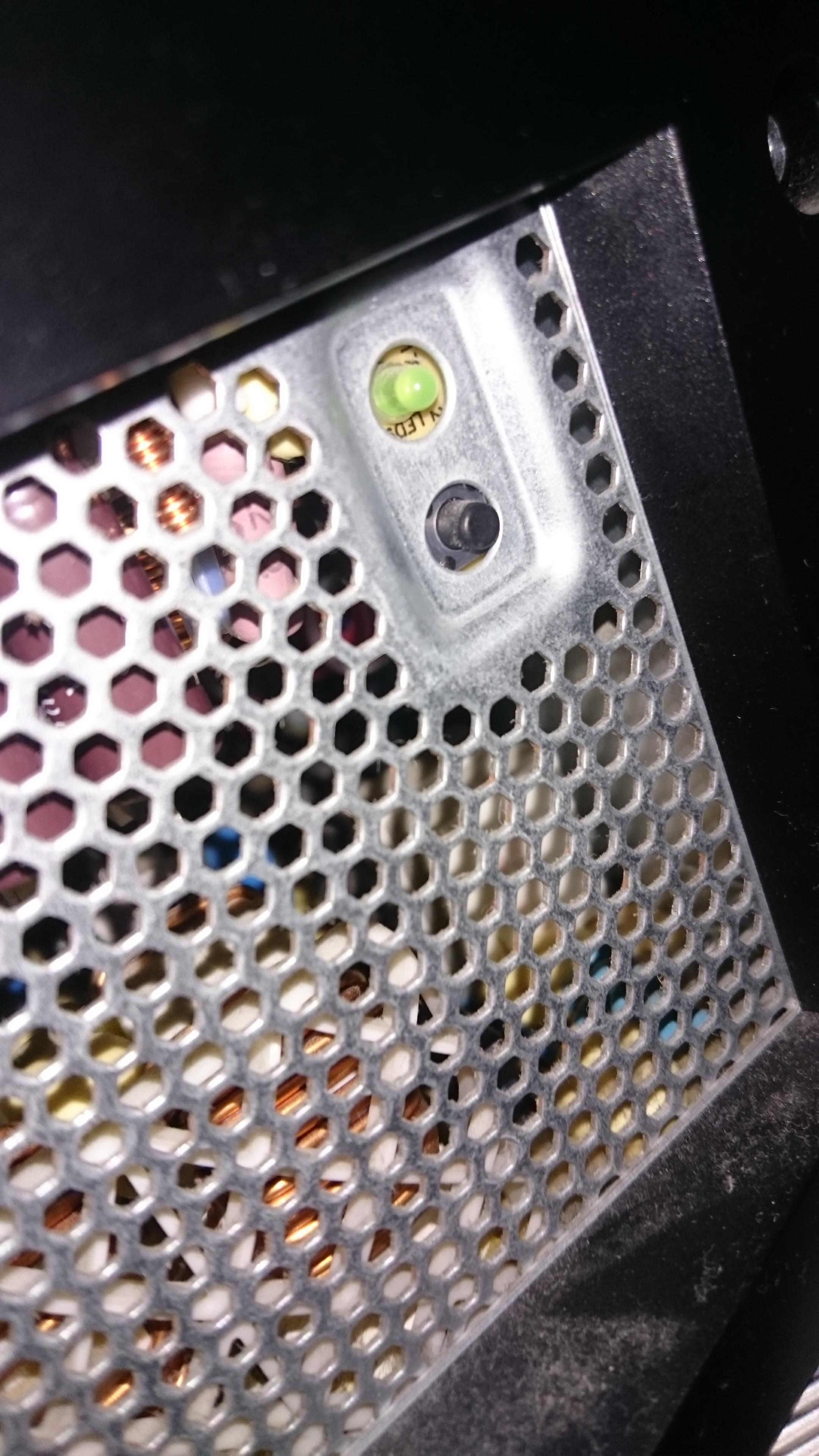

    Level 4  
    Posts: 130
    Hello ,
    I found 2 small buttons on the back.
    I have a problem because my computer has 7 x beep (fail CPU) and I clicked the black one. The computer turned on once and suddenly shut down. What is it for?
    I am begging you, help me, I am fed up with pc from Allegro
    Alienware Aurora R2
    The biggest mistake of my life
    Moderated By RADU23:
    I have merged the topics into one as they relate to the same hardware. Please do not create new ones, but continue with the current one.
    • 4 Short BIOS Beeps on Alienware Aurora R2 (A04) - Battery Issue, Replacement & Service Costs DSC_0172.JPG (661.15 KB) You must be logged in to download this attachment.
  • #28 17534322
    Pedros050
    Posts: 17915
    Help: 2471
    Rate: 3927
    Hello. And this is not a power supply, sometimes with a button and a diode? Give the specifications of this DELLA?
  • #29 17534339
    Ajuklelegendary
    Level 4  
    Posts: 130
    PITERRR wrote:
    Hello. And not for reset. Give the specifications of this invention?
    Can I turn it on? Nothing will happen?
    Sorry, but I'm really pissed, I bought it a year ago for PLN 1200, and it doesn't work, not to mention that they cheated me with a gpu ..
    I5 650
    AMD 5700
    Water cooling
    HDD 750 GB
    850 watts
  • #30 17534353
    Pedros050
    Posts: 17915
    Help: 2471
    Rate: 3927
    Does the buzzer squeal 7 times?
