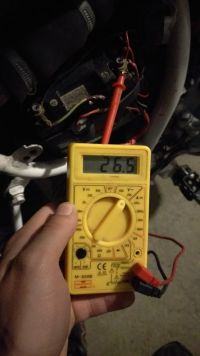

    Hello. I had a small problem with electronics that I managed to solve, but in the meantime I talked to the gentleman from the electronics store and told me to check on a fired motorcycle there is sometimes no AC current, it should show 0volt. I solved the problem, but I checked it out of curiosity and the meter showed around 26 volts, is everything okay, should there be something like that?
    the motorcycle is a yamaha dt125

  • #9 16485887
    arkosw
    Posts: 341
    Rate: 37
    Yamaha DT125: Checking & Understanding AC Current Levels in Motorcycle Battery Charging
    Hello. You do not believe so I am sending the photo. Direct current when the motor is lit 12.2-13.5 (depending on the engine speed) and alternating current from 26 to 28/29 volts
    the installation looks like that from the magnet goes to the regulator and from the regulator to the battery.
    And unfortunately this is not nonsense: /
    And I would like to add that I already have a 3 ignition module installed, is it possible that these modules are burning? (the battery cable is connected to the module)
    What's happening? Broken regulator?
    Ps. dtr version, and the lighting has a separate coil and "installations"
  • #10 16485896
    Krzysztof Kamienski
    Posts: 21895
    Help: 2033
    Rate: 5167
    No, no idea about electrical metrology, and "cabbage" :cry: multimeter. This is happening.
  • #11 16486144
    BANANvanDYK
    Posts: 7818
    Help: 1167
    Rate: 2602
    Cheap Unit meters and counterfeit Unit meters are exactly 2x the result when testing DC voltage in the AC voltage range.
