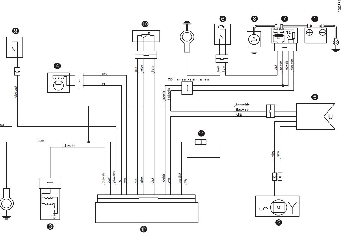

    Hello. Motor like the topic. No charging. Replaced stator and voltage regulator. Regulators tested in another motor are working properly (charging 14V). AC voltage on connected stator cables (yellow) 17,8V. Battery voltage (motorcycle fired) 11.8V. All cables and grounds checked. What else can cause a failure to charge? What is the fifth wire (white) coming out of the controller and going to the CDI module for? I enclose the installation diagram and photo of the regulator.
    I will add that after disconnecting the black and white wire (responsible for charging) from the regulator and connecting the light bulb, the bulb shines lightly, voltage about 6V and drops to 4.5V after increasing the speed.

    White is definitely a CDI power supply (when working without a battery). The battery is definitely functional? 11.8V indicates its discharge, in which case the voltage will not rise quickly to 14.4V. Measure the charging current by plugging an ammeter into the red wire of the regulator.

    So, as I thought, CDI power on an additional wire from the regulator. Check the voltage on it, alternating or rectified, regulated 12V or unregulated or high voltage. Also measure the current consumption of the module on this cable by connecting in series with an ammeter. This way we will check whether the module accidentally gets all the power from the alternator.

    1.6 mA DC current consumption on the white wire from the regulator, regardless of RPM. Voltage from 18mV to 40mV at revs. The motor goes out after disconnecting this cable. On the yellow wire measured with clamp meter 1.2A on idle, 4A on the highest. Power consumption in red and white 230mA to 400mA at revs. After disconnecting the battery, the motorcycle continues to operate. The voltage is 5-6V and drops after turning up the revolutions.

    It is interesting. Neither DC nor AC current on this cable? Maybe impulses with e.g. engine speed (though that would be stupid)? Maybe all you need to do is give ground to the CDI input for ignition to work?
    One more thing. According to the instructions, the alternator has a power of just 42W. The current on the alternator's phase conductors would be correct, while the battery charging current will not be too high, but of what you give is half the amount.
