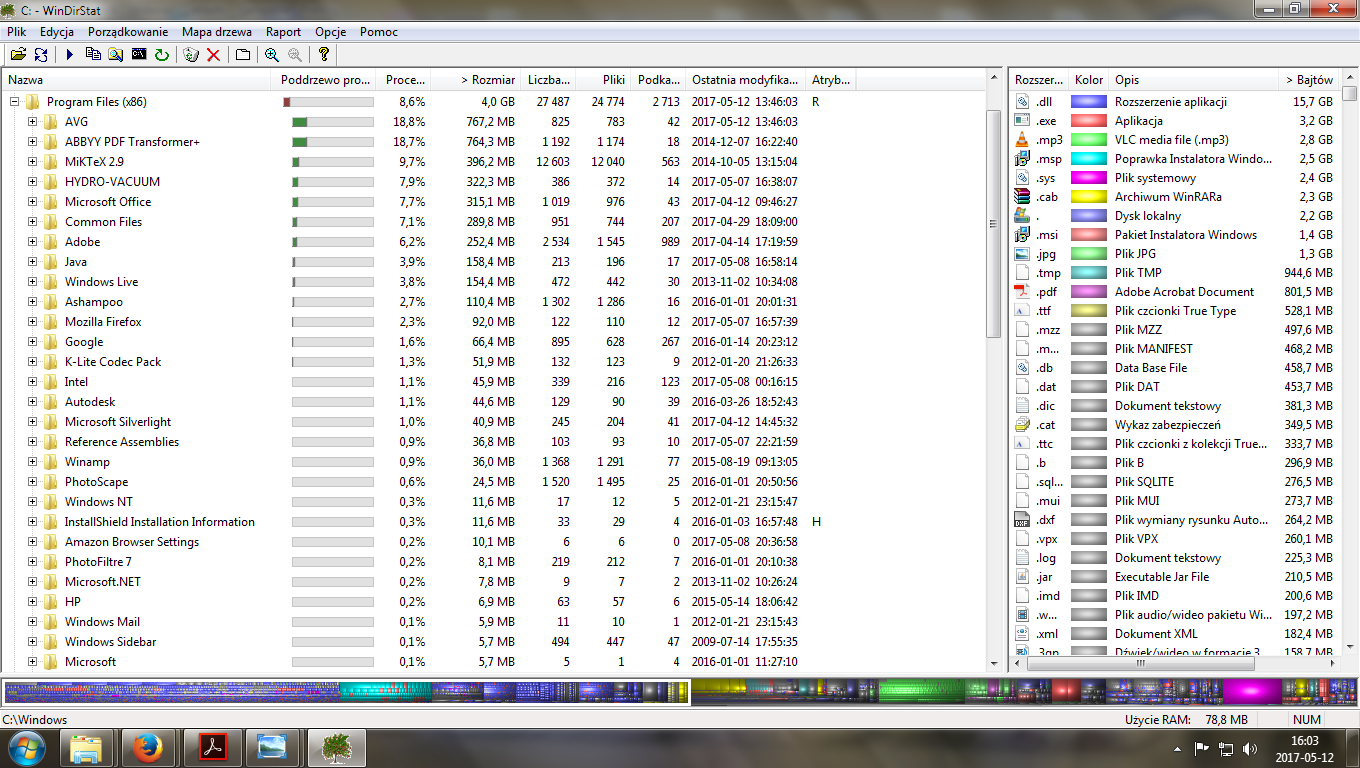

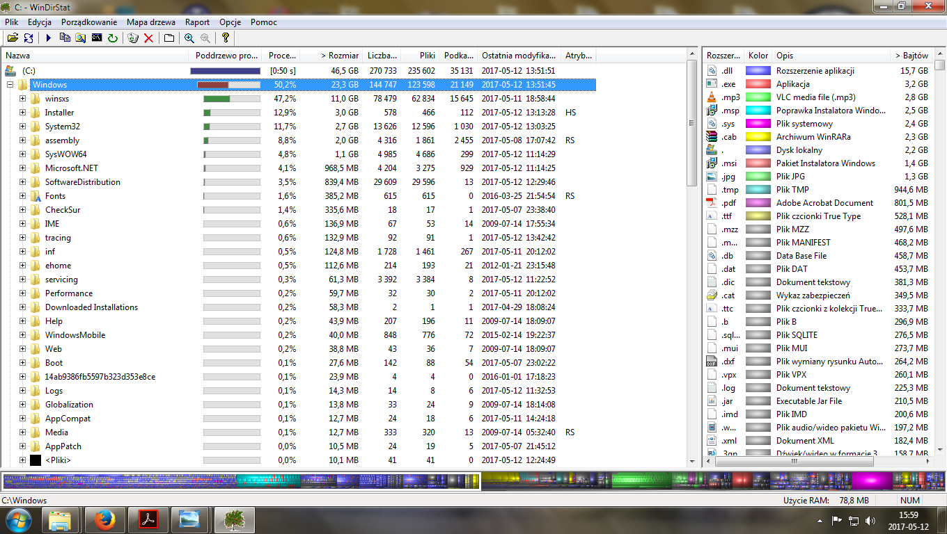

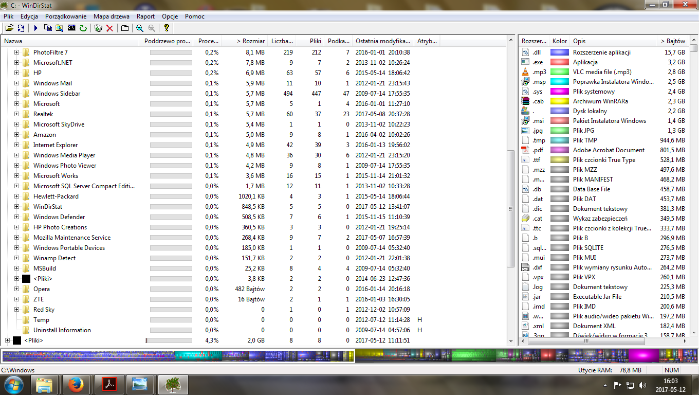

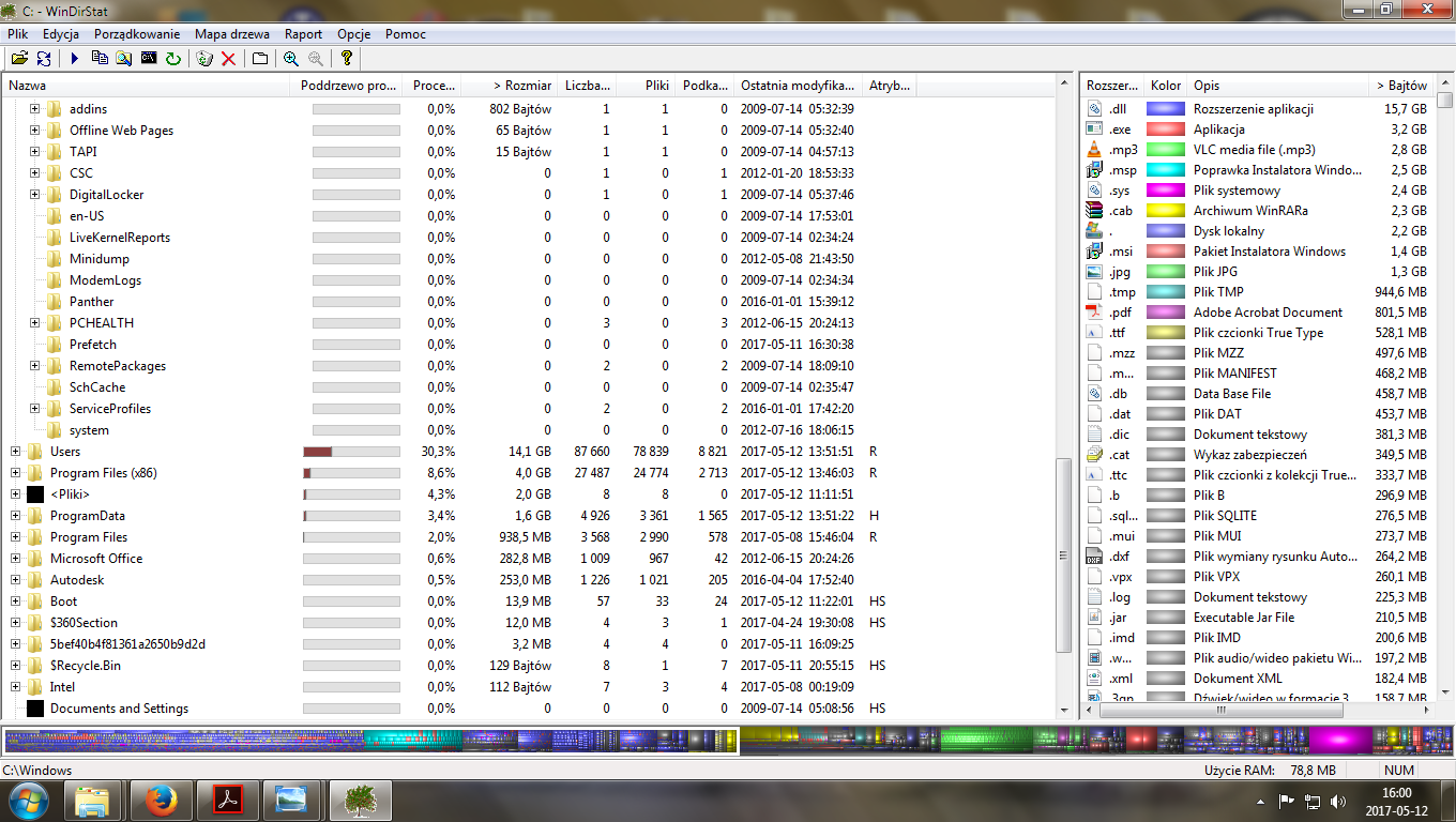

    Clear the recycle garbage can

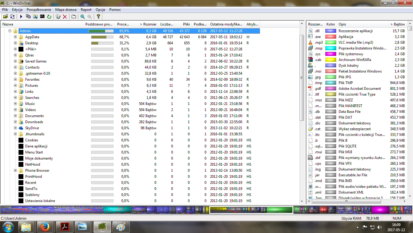

    What in the Users directory is taking up so much space? Post a screen shot of the program.
  • #19 16471954
    alik321
    Posts: 114
    Rate: 31
    Cleaning Unnecessary Files on C Drive - Windows 7 with 4GB Free Space Cleaning Unnecessary Files on C Drive - Windows 7 with 4GB Free Space Cleaning Unnecessary Files on C Drive - Windows 7 with 4GB Free Space
    This is from the Windows folder
    Added after 3 [minutes]:
    Program files

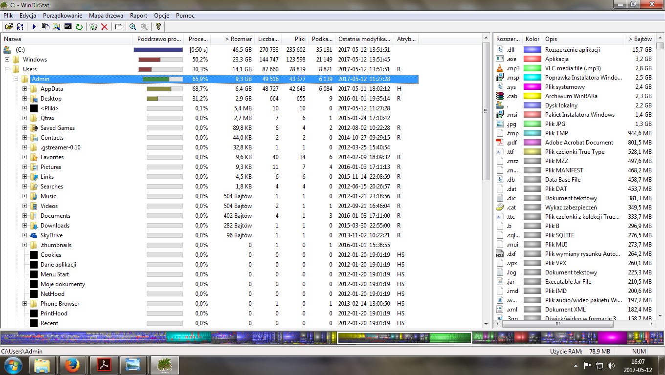

    Rate: 3547
    Post the contents of the Users directory yet.
  • #21 16471973
    alik321
    Posts: 114
    Rate: 31
    In Users this file takes up the most space
