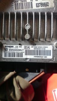

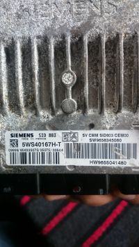

    Hello everyone I have a question is it possible to replace the drivers in the Peugeot 307 2.0 HDI car pictures below
    the original driver (photo 1) is damaged and I was able to get a second one (photo 2) from 2.0 hdi
    I tried to assign the driver PP2000 but no option because the driver was already paired
    on another post I read that it is possible to change the memory 95320 but in my case it did not give the result the second driver does not communicate with BSI
    I would like a hint

    You have to lose the flash

    You do eprom on virgin, pull the pin from bsi and train

    Exactly, it's best to do it after BDM.
    Or as the predecessor wrote virgin but it's much more fun.

    Eeprom has already translated but it is not enough
  • #7 16472987
    Faza952
    Posts: 60
    Rate: 26
    PIN from driver memory I already have only PP2000 I do not want to teach me the driver
    And what program can I "clean" the driver to teach

    As for communication, it's best to clone through full BDM .. then we have flash, eep and mpc

    As a colleague above wrote after a full copy of the driver or eeprom flash and mpc the car fired
    only with the copying of the whole on the new driver appeared the same fault
    and more precisely the old original controller when it is cold, usually after a night it resets cyclically every 3.4 seconds, thus the car after firing up immediately goes off and on and on until you hear the heat until BSM click relays switching on the engine power
    but all you need to do is slightly heat the processor in the engine controller and the problem passes by hand, the car lights up and never goes off even though it is after night and previously not fired
    that's why I decided to replace the driver only after cloning the content the same problem and heating no longer seems to result in whether a cold or warm continuous cyclic reset
    is the mpc content corrupted?
    I will add that the process has already been heated at the BGA station to a "liquid" state with no result

    Hello, the problem apparently lay on the flash memory side, I copied a batch dug on the net from another controller with the same numbers and the problem with the reset ended, the car fires up the first time and does not go out
    all that is left are the errors of the damaged driver and processor that cannot be deleted
    P1621 and P0606
    Is it possible that it is the fault of checksums?

    If you did virgin it would be done.
