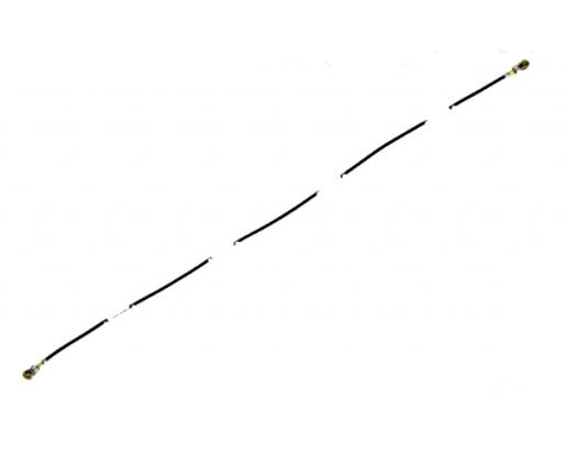

    So I am the owner of iphone6 and for some time stopped to catch my range (Orange type of telephone) unless GSM, so I got it started and pressed everything to myself and I got a range for an hour of time. I reset all settings, Ios etc. etc. So what part is to be replaced and what the GSM antenna looks like. Thank you in advance for your help. Or at least I could get a photo of this antenna?

    Hello, if the phone is not blocked, it is not a soft issue, please take on the hardware.
    To check the systems:
    - Skyworks 77802-23 Low Band LTE PAD (yellow)
    - Skyworks 77803-20 Mid Band LTE PAD (purple)
    - Qualcomm MDM9625M LTE Modem (orange)
    iPhone 6 Loses Orange Network Connection: GSM Antenna Replacement & iOS Reset Solutions
    Check if you have a well-connected antenna, if you take out the CD, it's underneath.
    Greetings

    The first owner and bought in a store on a similar markt media and possible to fall several times, in the settings I have visible and after entering * # 06 # box * Removes * Is the antenna which is at the bottom of the iphone has something with eiem? Because it seems to me that the conductor is slightly interrupted

    Antenna is well connected, only one that is connected next to the battery input is probably damaged, is this antenna something to Eiem? because in the settings I have and after entering * # 06 # the field resets. Can we somehow measure the voltage or transition without gauging them? And it's about replacing whether reball / reflow / reheat (It seems to me that the orange can not be replaced because it's paired with the motherboard)
