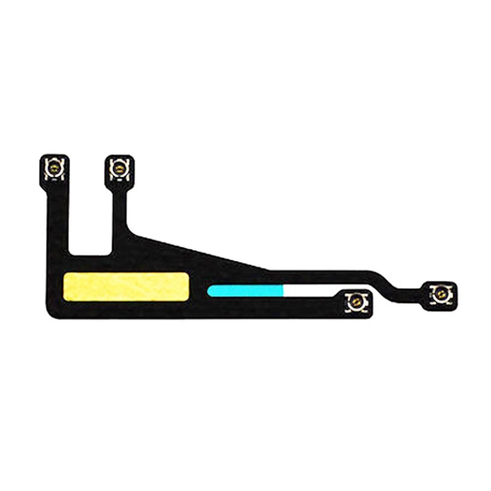

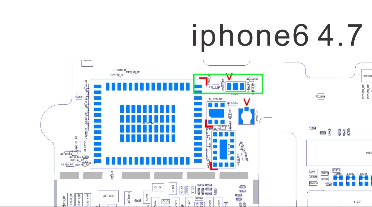

    I have 2 pcs iphone 6 with poor wifi / bt coverage. I warmed up the U5201 and components in about but it did not work, I plugged in and plugged in the antenna and nothing. Wifi is all the time but 1 dash, sometimes two, and so it jumps. Any ideas? without replacing the layout will not work?

    or rather, just a guilty arrangement? quite a popular problem. What could be wrong with the layout? damages yourself? some micro break in "him"?

    hmmm on YT there are videos, where they exchange the antenna itself and the range is all ... wonders how the antenna can break down? after all, the antenna is nothing more than a piece of wire flooded in plastic ...

    Dear colleagues, if WiFi is not gray and it works, that is, the guilty antenna that he removes.
    As for this, it can break down and we replace it and bend it so that the entire copper surface touches the casing, before replacing try to simply turn it up to firmly adhere to the housing.

    The second popular problem, behind this connector are the elements in the "power" track of the wifi antenna.
    Replacing them or exchanging them should solve the problem.

    I heated all the elements (up to my pen) I could move. Nothing could. Well, maybe something is better there, like 2 out of 3 lines but it's hard to work ... I exchanged antennas for 3 different ones and no effect. Is there anyone who fixed it? apparently the mass of iphone 6 is so ... The system doubts that it would be banged, because what does it have to do with it? as if the wifi was gray it means that the system does not respond but here is evidently somewhere a break in the antenna.

    I recommend replacing the WiFi / BT system, but especially small things, because playing in reball is a waste of time from my point of view, a lot of time goes down to clean the glue, and the systems do not have MACs saved.
