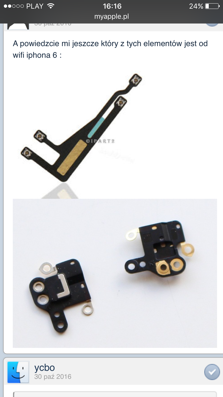

    Hello, in my iPhone 6 wifi works only at a distance of about 1m from the router. The test on other routers is the same So surely ip fault. And from what I read, probably the wifi antenna.
    And now I have a question because I don't know what to mention.
    Should I replace this first antenna tape? Is the other one with holes?
    • iPhone 6 Poor WiFi Range: Troubleshooting & Replacing WiFi Antenna (Tape or Holes Version) IMG_4124.PNG (570.48 KB) You must be logged in to download this attachment.

    Replace the first antenna from the top in the photo, and if you do not check the u5201 chip
