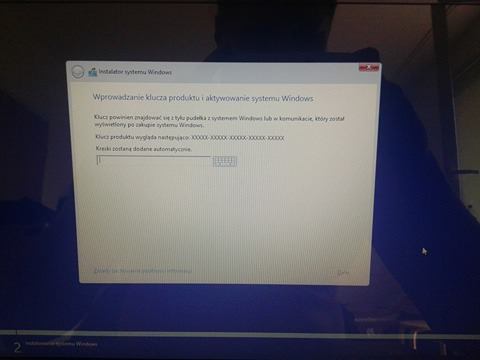

    Okay, now it's a question from a different barrel because I tried to reinstall the system without data loss and data loss and I can't see any partition at all. My question is as follows, I have another disk but it is from the hp computer and there is recovery from the hp computer, will it be possible to remove it? will it be possible to do recover from my computer, ie lenovo on this hp drive?
    Added after 11 [minutes]:
    I moved the disks and now the installer requires the product key from me, how should I give it to him if I do not have it?
    Skip it and then activate it from the system level.

    You can't skip it, I only have the next button and if I don't enter the key, I can only turn off the installer. this is not because there is recovery from hp from another system? I can somehow remove recovery, format the entire disk to zero?
  • #18 16481019
    You can, it would be best to format it by a program run from a usb flash drive, it could be mhdd. Do you install the entire system with a pendrive?

    Yes, I used this program as you recommended, and at a friend's computer I downloaded it to a pen drive.
    edit: Lenovo G50-30 Laptop: Checking Media, EFI Network Boot Failed, Default Boot Device Missing
    This is what the image in which I am stuck looks like and I don't see any way to skip what you say

    The first time I see something like this and I used this tool several times, the key was always taken from the CD, try the newer version of the media creation tool.
    Have you downloaded win 8.1 on this flash drive or windows 8?

    In what you sent me mediacreationtool there is a choice of wines 8.1, wines 8.1 n, wines 8.1 pro and wines 8.1 pro n. I have probably downloaded the wrong version, so I cannot see the key. there is no windows 8 to choose from.

    Ok, the question is just what version did you have ;) exactly the same must be downloaded.

    I bought my laptop in 2014. I don't know if it had 8.1 or 8 but it comes out unless 8. is there any way to find out what my system was installed at the beginning? e.g. on a box?
    Added after 2 [hours] 56 [minutes]:
    I was with the disc in the service, over 300 sectors destroyed, no longer good for anything. And with this installer the idea was that I downloaded windows 8 and I need to download windows 10 and then the key downloads itself. thanks for the help!
