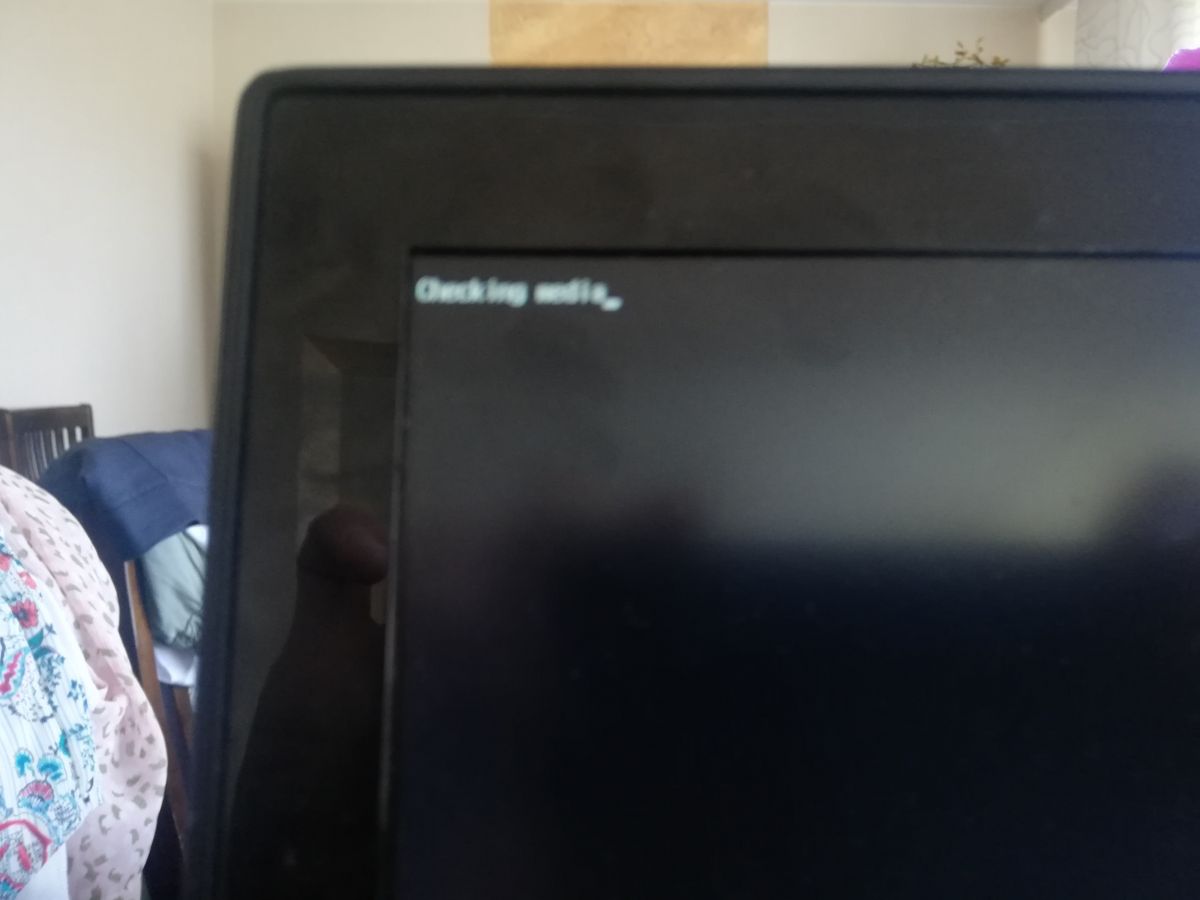

    Checking media... (it`s like this for about 5 seconds in the upper left corner)

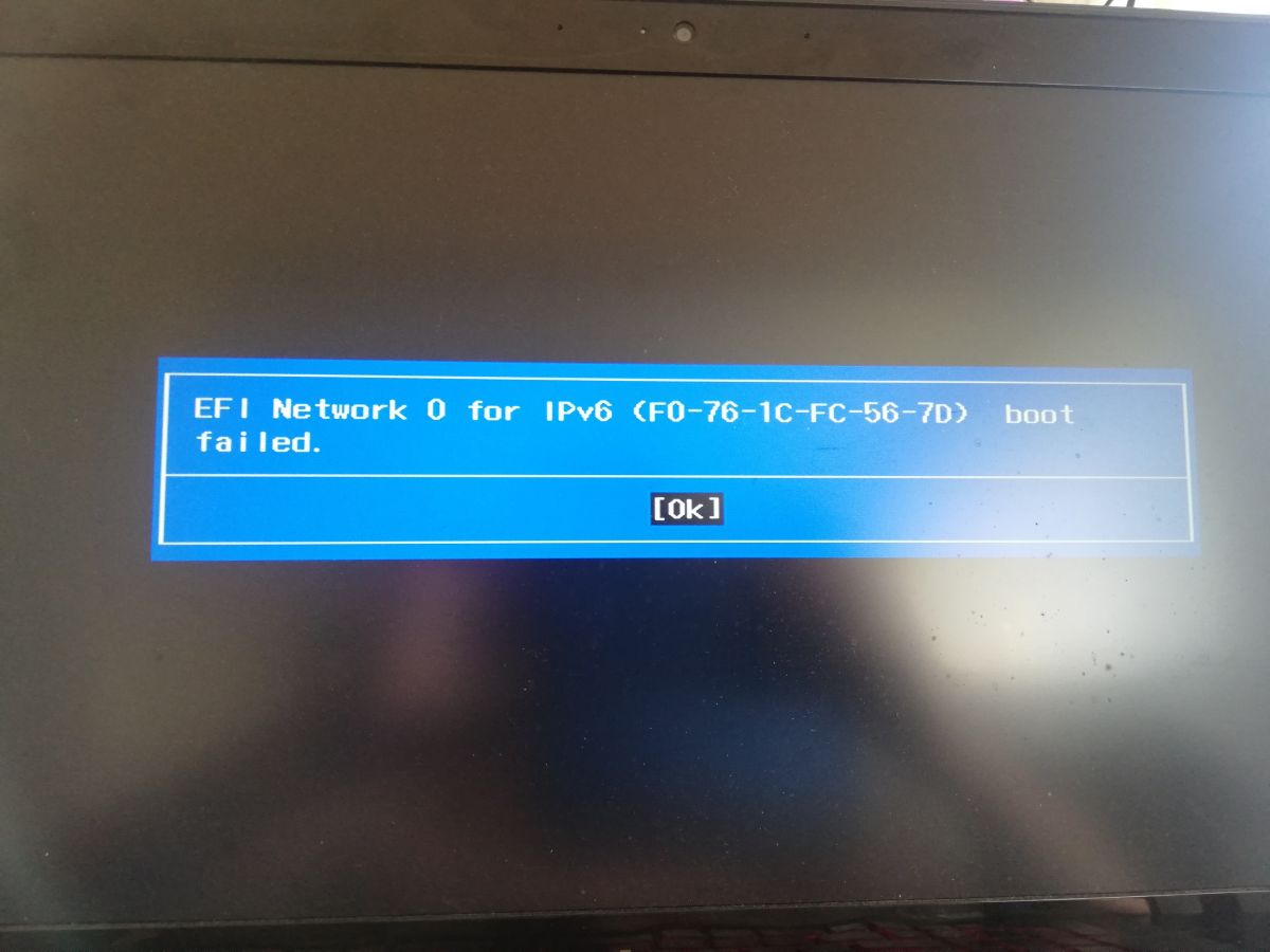

    EFI Network 0 for IPv6 (F0-76-1C-FC-56-7D) boot failed.
    I click [OK] again and the following window appears:

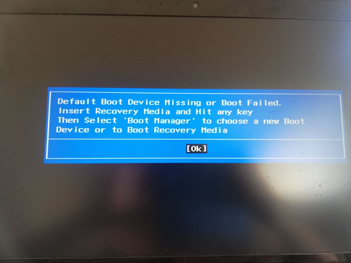

    Default Boot Device Missing or Boot Failed.
    Insert Recovery Media and Hit any key
    Then Select `Boot Manager` to choose a new Boot
    Device or to Boot Recovery Media
    I click [OK] again

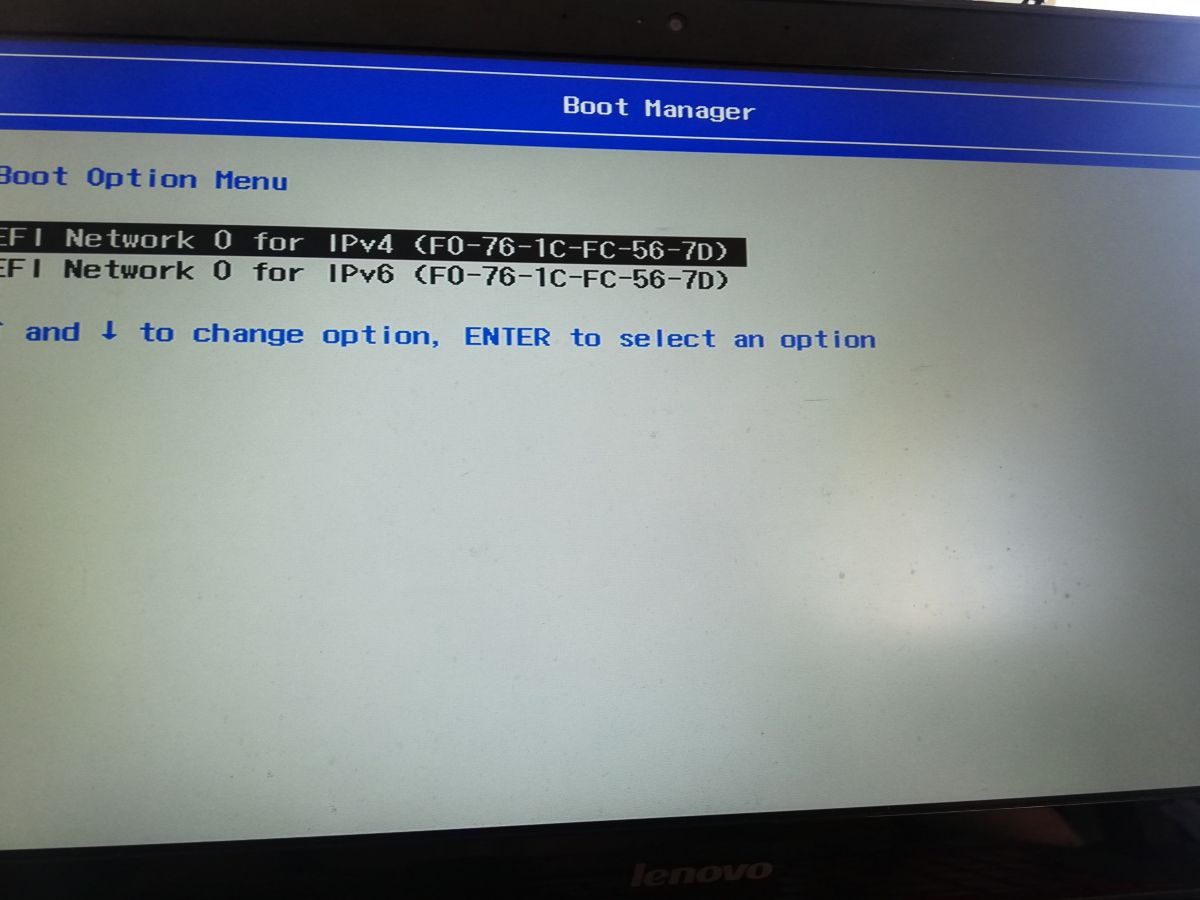

    and the Boot Manager window pops up, where I can choose,
    EFI Network for IPv4....
    and
    EFI Network for IPv6
    I click on one of them and it still shows the same thing

    Is the SSD functional? I had the same experience as you did with the disk that had errors/bad sectors on the disk.
    Is Secure Boot disabled in the BIOS?

  • #4 18844430
    marcinek19992
    Posts: 357
    Rate: 34
    Please disable Secure Boot and try again.
    Legacy Support - I only enabled it when installing Windows 7. Please restore the BIOS to factory settings and uncheck/disable the Secure Boot option and see if it helps.
