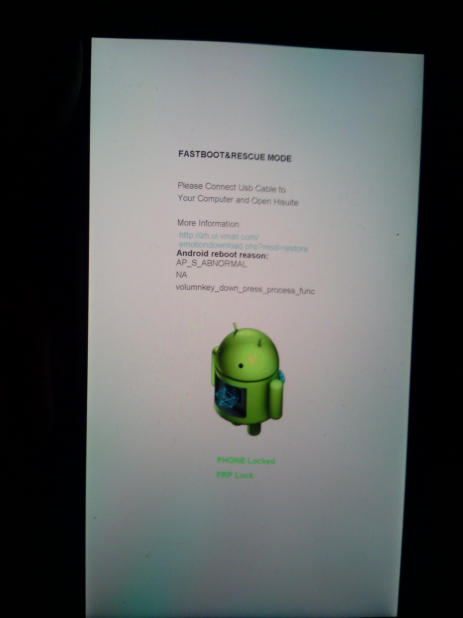

    Hello, recently updated the above phone to your girlfriend for android 7.0, but she did not like his appearance and wanted to return to the previous one. The return went, but the first time she was turned on, she was asked to enter the previous Google account, unfortunately, like the blonde (hard to remember ...) she forgot what was the password and typed it incorrectly many times. After a while, the phone turned off and stops on the "Huawei" log, I tried to restore the system through the "HiSuite" program but there you can not do it, I read on various xda forums and all attempts to fix it failed when I enter "FastBoot" on bottom I have "Phone Locked Frp Lock" written. I am asking for quick help, I promised to repair it :P greetings

  • #8 16480343
    Slajner
    Posts: 184
    Rate: 16
    Unfortunately, I can not do anything about these instructions and the only modes in which I can run it can be seen on the pictures Huawei P9 Lite: Stuck on Logo after Android 7.0 Update, Google Account & FRP Locked

  • #10 16480904
    Slajner
    Posts: 184
    Rate: 16
    Unfortunately, the phone can not be turned off, rebooting immediately when I press the switch.
  • #11 16481069
    nutergsm
    Posts: 8429
    Help: 1034
    Rate: 1665
    c_4 wrote:
    select wipe data / factory reset and you have a tel once removed from the box (all user data and settings are erased)
    Stop writing fairy tales, blocking frp and stay that way.
    Now it's only a good service to deal with it.

  • Service needed; bootloader unlock blocked by FRP lock
    #15 16482710
    FIsiu_
    Level 28  
    Posts: 1139
    Help: 128
    Rate: 295
    c_4 wrote:
    This post has something to contribute? P9 Lite has newer security features and these tricks do not work. Another thing that the author of the subject phone does not start so it will not help much.
    In this case, only the service will help, you could try to unlock the bootloader and upload soft, but with the google lock enabled you will not even unlock the boote ...
