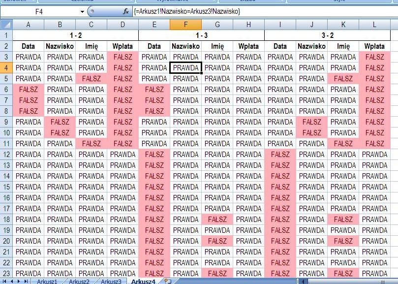

  • #5 16482895
    luka_brazi
    Posts: 14
    ok, something's starting to happen :)
    and to do something like the picture, i.e. arrange the columns so that they are in the expected order - only that the columns from the source table are always in different places, but with the same headings Creating Excel VBA Macro to Compare Columns with Same Headers in Different Order
  • #6 16485950
    lanzul
    Level 30  
    Posts: 1023
    Help: 199
    Rate: 123
    luka_brazi wrote:
    ... and to do something like the picture, i.e. arrange the columns so that they are in the expected order - only that the columns from the source table are always in different places, but with the same headings ...
    ... manually?, functions?, macros? ...
    manually - provide appropriate headings with an entry " 1_ "for the first column of interest to us," 2_ "for the second, etc., and then - Sorting-> Sorting options -> Sort from left to right -> OK -> Sort by: row_num -> ascending
    functions - for a given table, for example: ' A1: N5 'enter in any range of the sheet, e.g. in' L20 ' functions:
    ' = CHOOSE (COLUMN (A1); "No."; "Company name"; "Contract date"; "Contract number"; "Employee"; "Product") '-> w' L21 ' functions: ' = HLOOKUP (L $ 20, $ A $ 1: $ N $ 5, ROW (A2), 0) '-> and drag it to the appropriate data range - if it is in another sheet, include references to the sheet with the table
    with macros - just like manually, only with the vba code, you can record it with a macro recorder and put it in a loop that will spin the procedure, you can use, for example: search or text comparison function, for example:

  • #7 16486440
    luka_brazi
    Posts: 14
    I meant the macro. Thanks a lot. I have succeeded with the more "complicated and confusing" method in VBA, but it works :) :)
