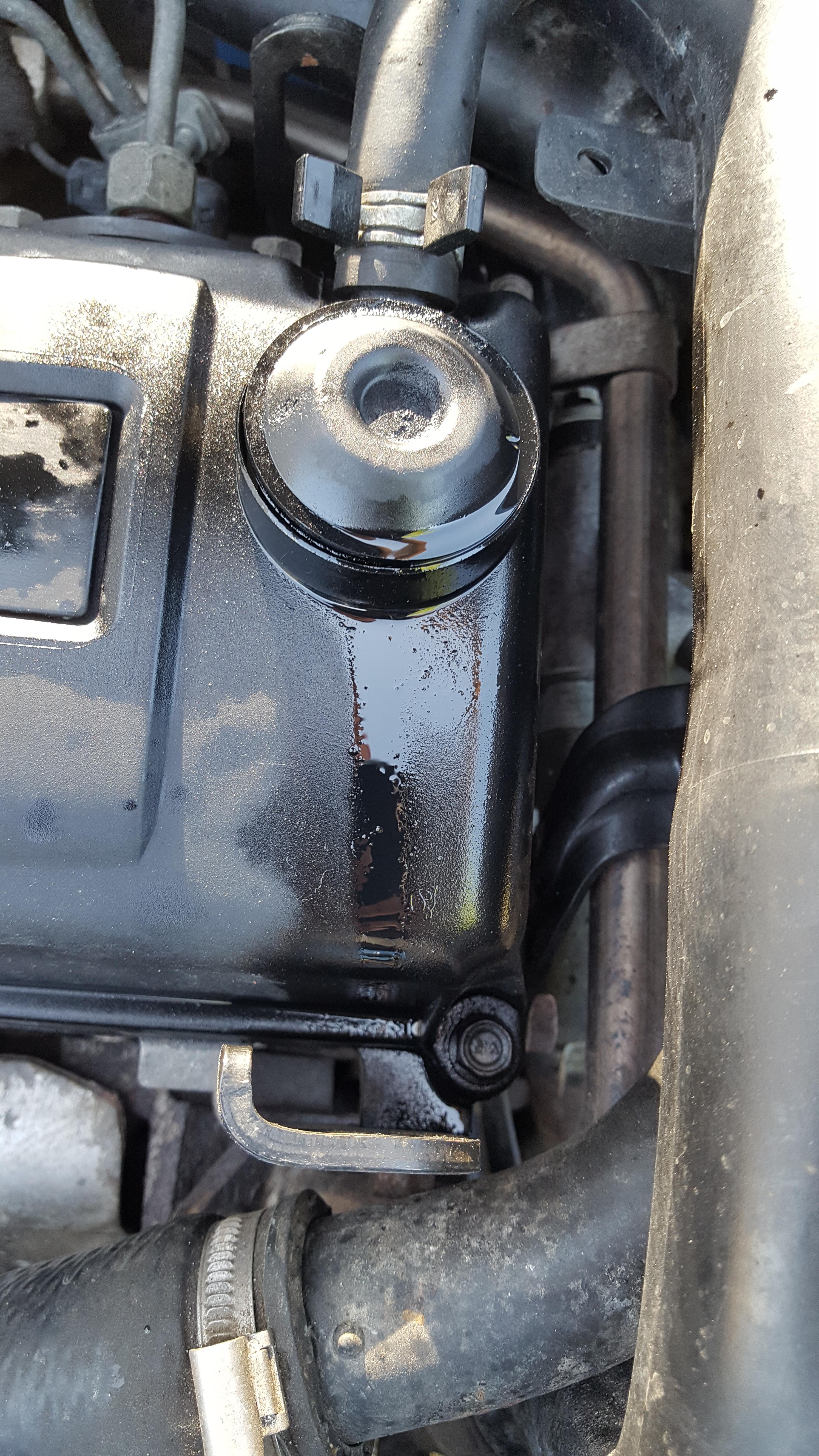

    from what could she sneeze with oil or is it some serious matter?
    • opel corsa 1.7 Di isuzu emphysema and - oil flies from emphysema 20170517_093732.jpg (2.16 MB) You must be logged in to download this attachment.

    Little data about the car. Oil in a change is normal. And the fact that it has come out is probably a leak. There is no way to "sneeze"

    and is it possible that it is injection oil?
    fuel? where to look for leaks?

    Oil is clean oil will be black if it is diesel. The leak is where the oil stands. What exactly is this car?

    corsa van 1.7 Di 2002r

    The element from which the oil is leaking is the odor filter. Comes with a cover. You can clean it. The leak is rather harmless.

    it was enough to stick the cannon together until today.
