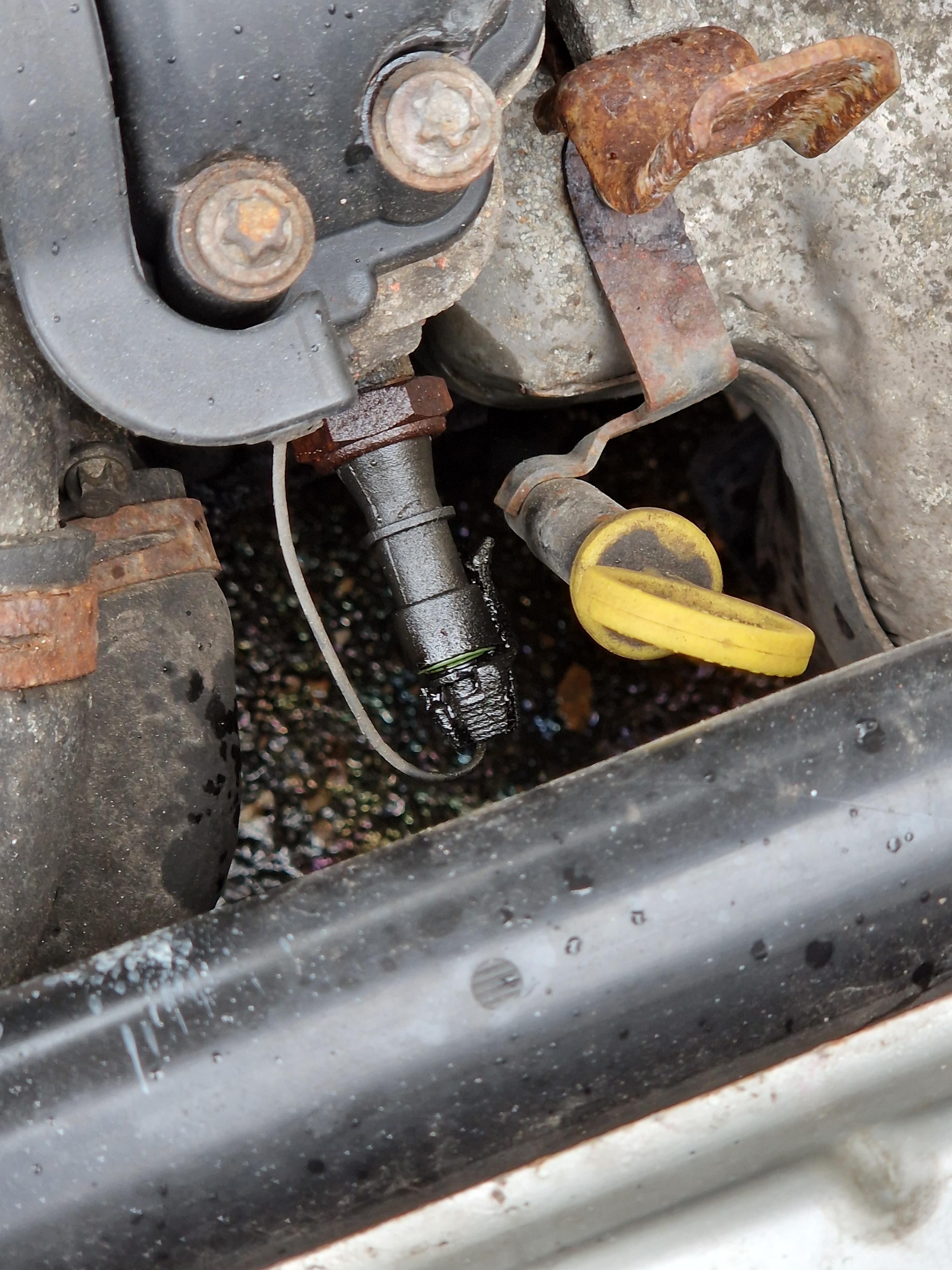

  • Longer coolant temperature sensor may be incorrect part
    #17 20512907
    deadpoolredsuit
    Hi,
    Oil dripping from what I believe is the coolant temperature sensor (front of the engine - top left)
    My Corsa details: I believe it is a CORSA-C Hatchback
    Date of registration: 2005
    Variant: AG11
    D.3 Model: CORSA LIFE TWINPORT
    D.5 Body Type: 3 DOOR HATCHBACK
    PETROL
    998 CC
    Looking on eBay, are there variations / models of sensor? ..or did VAUXHALL stick to one type for CORSA's?
    Here is a photo. The sensors I have seen on eBay appear to look shorter.
    The sensor on my CORSA looks longer, could be incorrect part on car?
    The wire situation looks knackered.

  • #18 20513529
    thomas48
    Level 21  
    Posts: 359
    Help: 44
    Rate: 83
    Did you read the whole thread? This is oil pressure sensor!!! Buy a new one and problem solved. Any auto shop will find the right one.
