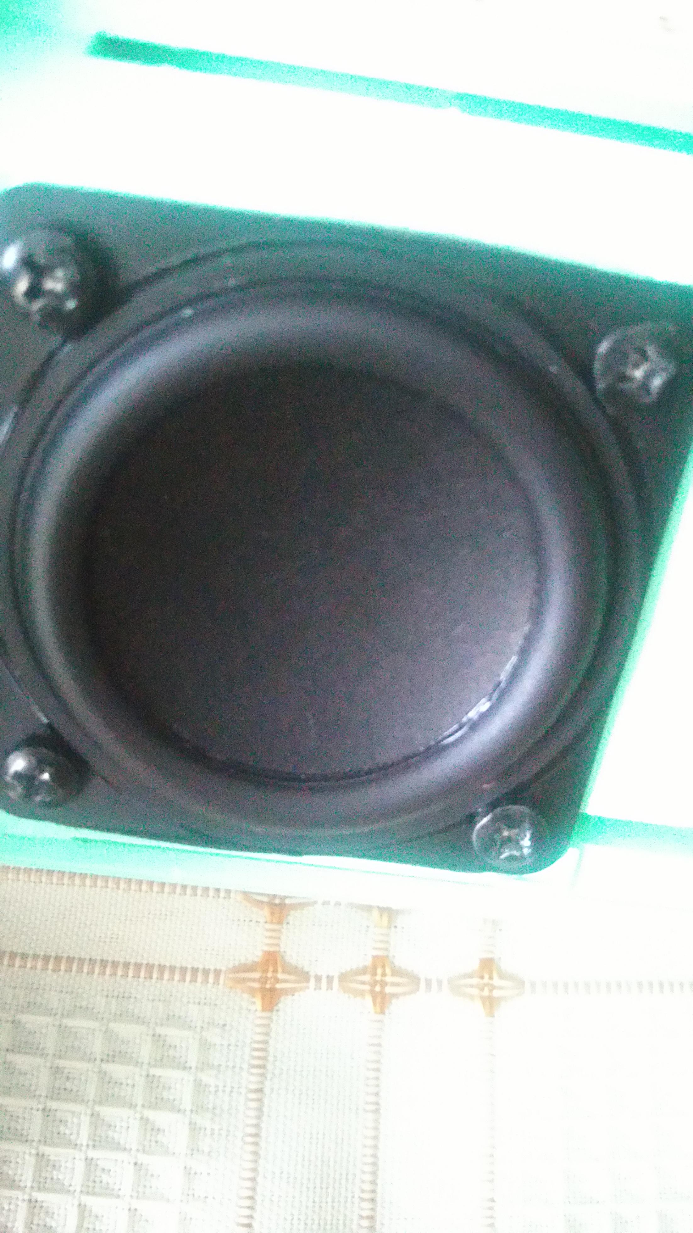

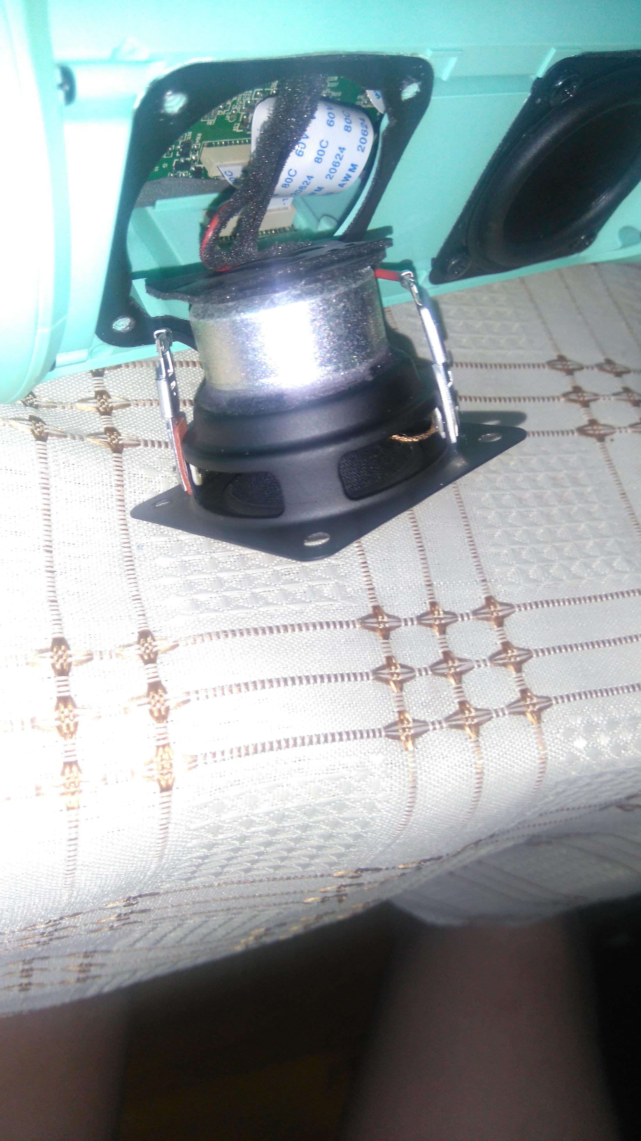

    I will ask for a detailed photograph of the left speaker's diaphragm.
    Probable damage to the spring of the diaphragm.
  • #3 16499213
    Artur k.
    Posts: 25889
    Help: 1279
    Rate: 1700
    The second is probably a passive membrane. :)
    The loudspeaker can not be bought in the store, you have to look for the same set for parts, or you can turn to the service though and the service may not be able to bring such a loudspeaker.

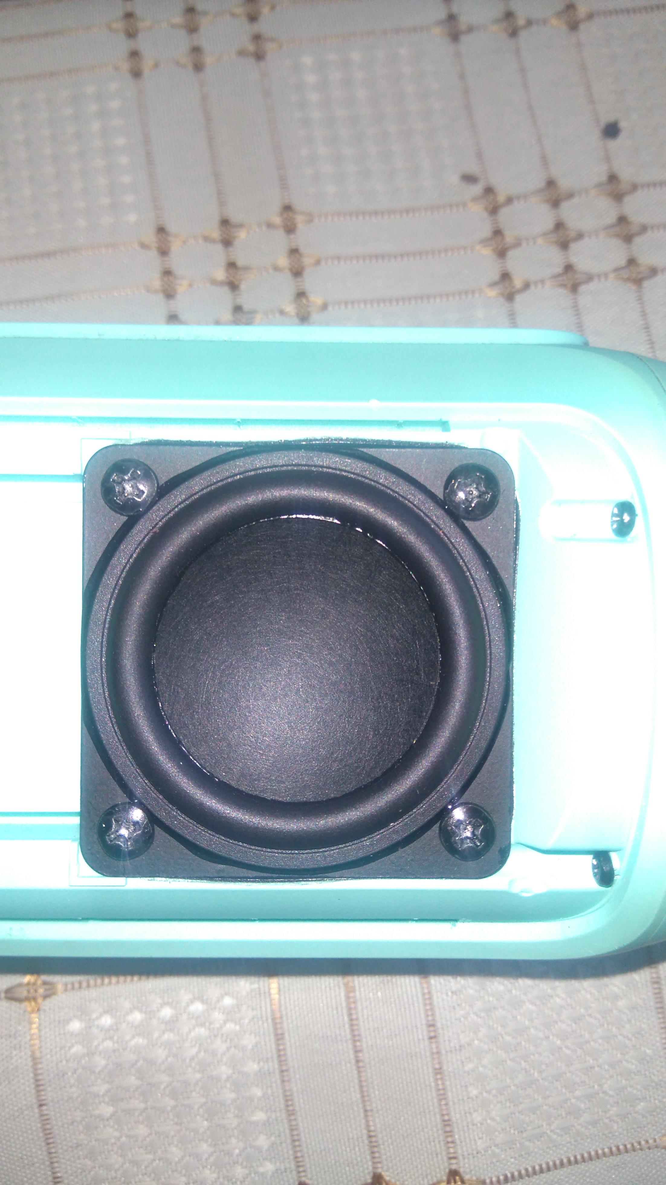

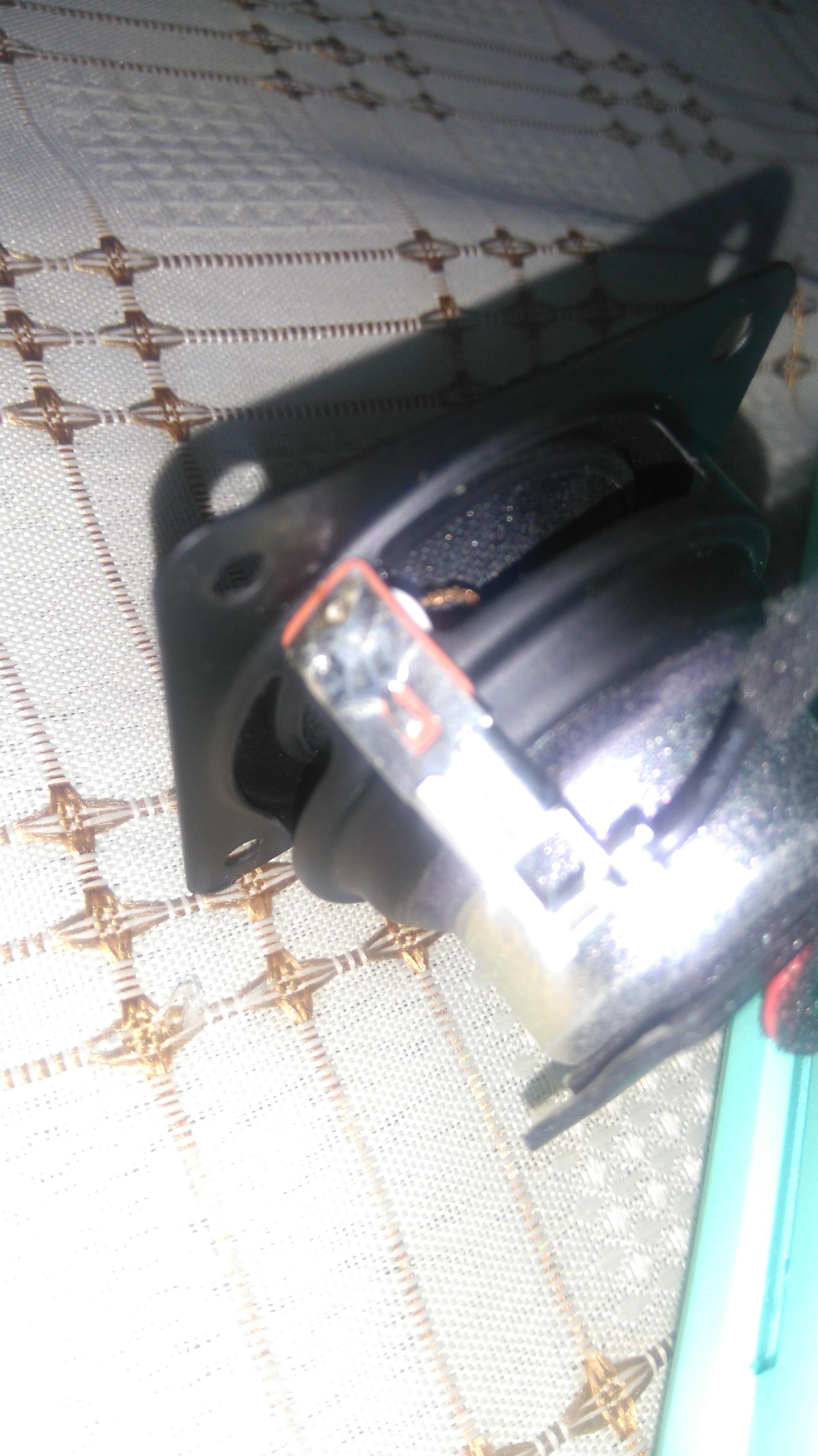

    And what do we have to deduce from these photos? Somehow I do not really understand why you put them in.

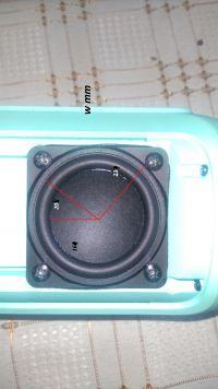

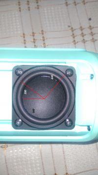

    Provide the dimensions of these springs, maybe something will be selected.

    And these dimensions are in what units are they? 200mm it is 20cm and there are 45mm speakers ...

    Kolego Slovicker is your size? These are diameters or rays ( such a small difference )?

    And what is it 16?
    I understand that the diameter of the membrane is 40mm, the membrane has a suspension of 46mm, so the suspension is 3mm. And what is the height?
    I'm afraid that it will be difficult to adjust something.
