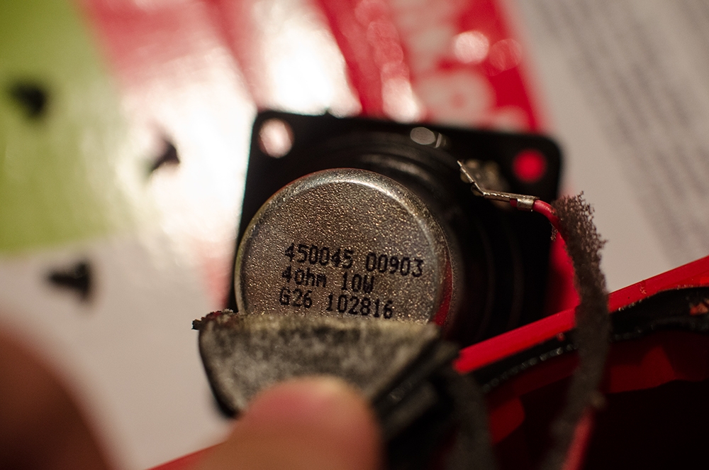

    I have a problem with the original Charge 2+, namely the speakers do not work, they start to play only after slightly pressing the diaphragm. The coil fell off maybe?

    Probably the coil is broken somewhere. Twist and try to measure if there is any resistance. If missing, it is known to be aborted. In the latter case, the core might be too high and not working in the coil.

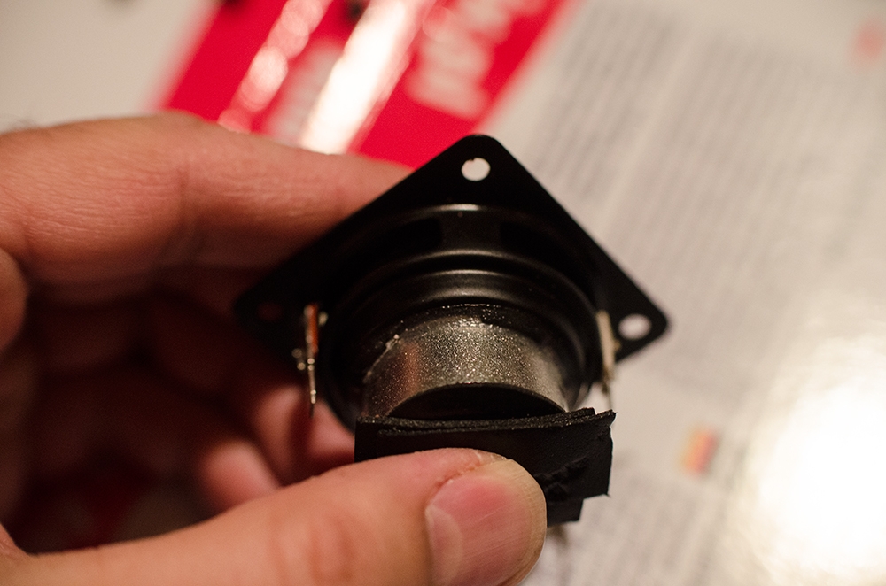

    and no resistance. Only appears after pressing. Is there any way to get to the coil as smoothly as possible? Below are photos of the speaker. He can somehow take off this magnet that looks stuck to the housing (or whatever it is called):

  • #4 17162758

    You can try something on your own, but in fact with such small elements it will be difficult to rewind it if you have no experience. I would rather advise you to look for a replacement (speaker).

    Oh, I thought that there was nothing to connect there, because so far I had thrown paper balls pressing the diaphragms under the speaker cover and so far it sounds somehow, although there is not too much bass.

    Check Aliexpres to see if you won't find such speakers. For a few dollars, you can exchange it and forget about the problem.
    Playing as you wrote can lead to a short circuit in the coil (because it probably sticks in a decentralized gap and rubs against it) and in a short time lead to serious damage in the amplifier itself.

    I was looking for and the cost of one speaker with shipping is about PLN 80, so it's probably better to recondition it. Only does anyone know someone on the forum who deals with it?

    I suppose something is wrong with the cables connecting the coil to the terminals. You can try to detach the suspension from the basket, but it may damage it irreparably and it can be difficult to get new ones.
    Such speakers are rather not repaired, but replaced.
    It will be difficult to find someone who will want to fix it, and when it comes to it, it does not have to be cheaper than buying a new one.
    Look for, maybe you will find somewhere such or similar speaker.
    Maybe one will match: https://www.tme.eu/pl/katalog/zrodla-dzwieku_...s=2%2C591%2C2560%2C36%2C122%2C564%2C601%2%217 % 2C575 & used_params = 122% 3A24824% 3B591% 3A2336% 3B & page = 1 & limit = 50
    Best regards.

    I wrote:
    So you would have to either soften the glue with some solvent, or try to detach the suspension mechanically, without the use of chemicals.
    It's just that in both cases the suspension may be destroyed (dissolving, tearing), that's why I wrote:
    DjMapet wrote:
    but it may damage it irreparably and it can be hard to get new ones.
    Therefore, it would be advisable to see if there is a suspension closest to the original one.
    Is the suspension foam or rubber?
    Best regards.

    Rubber suspension. And you can't get to the sides of the magnet? There you can see the glue, maybe it could be dissolved. Unless I look for the characteristics of these speakers and choose another brand, similar or better. From what I could find they have 75 Hz - 20 kHz and I think somewhere I have encountered that someone measured and went down to 60Hz. Overall good bass is a strong point of these Jbls.
