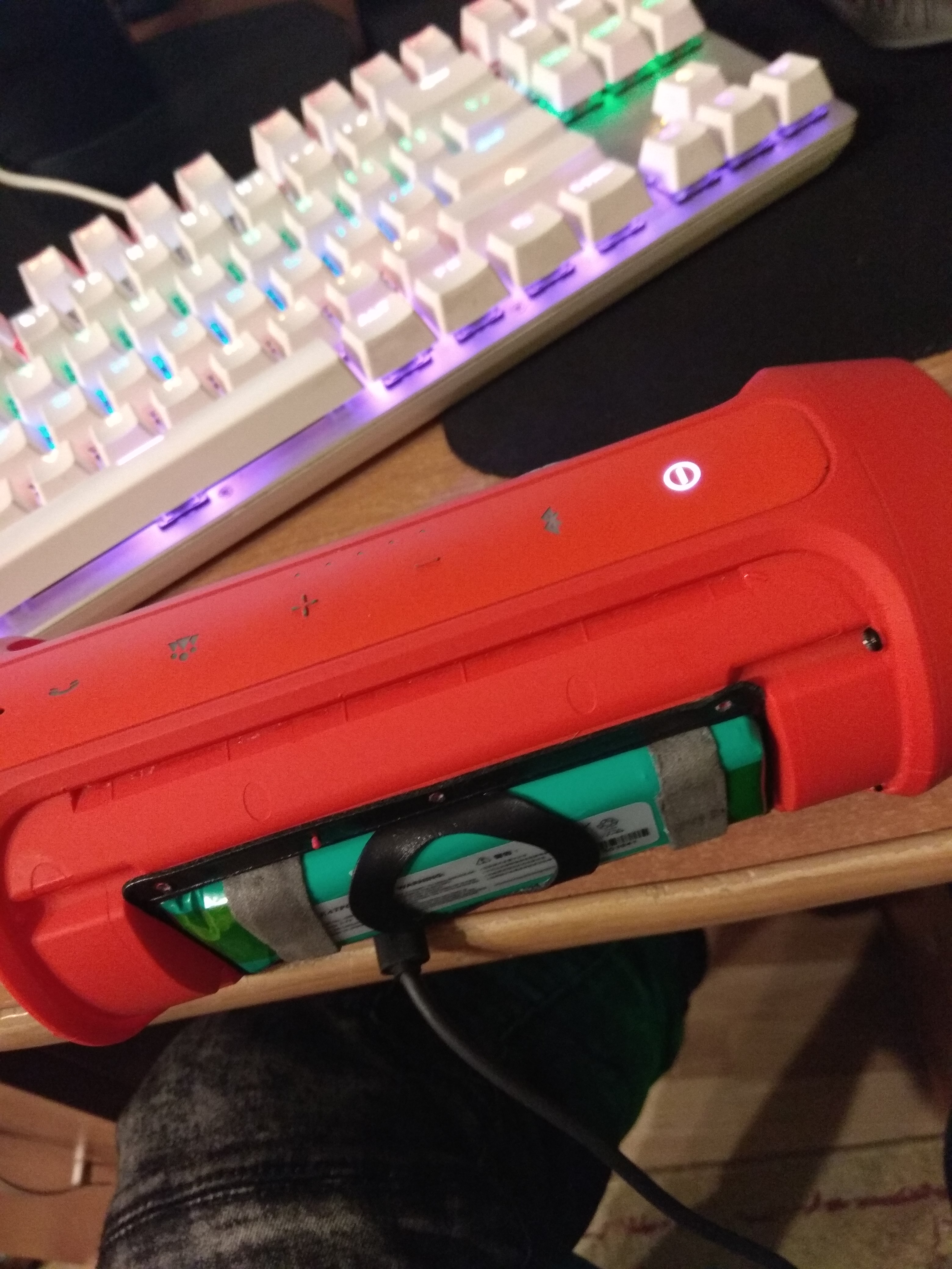

    Overall, I have this problem:
    The colleague discharged it to 0% and then when the attempt to charge stopped working and I do not know what to do the speaker does not turn on just a moment after pressing the button lights up power and while trying to charge it lights up all the time. Does anyone know how to fix this vulnerability? Thanks in advance for any help. The loudspeaker is not under warranty. You have everything on a zd and a movie
    • VID_20180311_214358.mp4 (16.5 MB) You must be logged in to download this attachment.
    • JBL Charge 2+ Won't Turn On or Charge after 0% Battery Drain: Power Button & Charging Light Issues IMG_20180311_214332.jpg (1.77 MB) You must be logged in to download this attachment.

    I would try to charge from another source or replace the battery.

    And I still have a question about the battery what is the white wire for because it is black -, red + and still white?
  • #4 17096873
    Artur006
    Posts: 9
    As a colleague at the top I would feed him with another source, if this does not help, you have to look inside and check whether something is not burnt. Starting check from the power supply or battery

    I have probably charged a good battery even with an external 4V ma and 3.5 A charger
    Added after 6 [minutes]:
    one test battery 18650 ashes and this is the same, i.e. it is not the fault of power supply

    Did you reset this speaker?
  • #8 17096967
    LimaXson
    Posts: 26
    In the sense that the volume button with the power button does not respond to anything
  • #9 17096974
    Radiokiller
    Level 30  
    Posts: 1299
    Help: 156
    Rate: 236
    Plus and blutooth button

    @LimaXson maybe you could specify the parameters of this battery from the label (preferably a clear photo) and do not load the accidental charger.
    greetings
  • #11 17098829
    LimaXson
    Posts: 26
    does not charge by accidental charger.
    And on the label you have:
    GSP1029102
    22.2 Wh
    6000mAh
    3.7V
    15k04
    CB
    and as for the reset, nothing happens
    Forgive me probably not so understand:
    As much as 3.5A and only 4V.
    Since:
    LimaXson wrote:
    The colleague unloaded him to 0% and then when he tried to charge it stopped working and I do not know what to do
    To connect the charger, for example from a phone (5V / 1.0A) or tablet, they have a higher current efficiency and leave this set for at least 10 hours.
    Do you have a multimeter?
    If so, measure the voltage of the battery.
    greetings

    Charged up to full multimeter and charging current has decreased to 0 otherwise I go to technical school about the direction of an electrician so I embrace everything

    I had the same symptoms. The bluetooth system was guilty. After pressing with your finger, the speaker should work for a moment. Baking him does the trick - the picture is marked, best regards!

    Fortunately, I started to undress from the right side: I heated the igniter with p :roll: And it works. Thanks.

    For me, there is a problem that the speaker turns on, the power light blinks and from Bluetooth, the phone connects normally to the speaker, but there are no sounds.
    On the battery alone, without connecting the speaker speaker can not be turned on. After connecting the charger the situation as above and can not be charged. After disconnecting the battery from the disc and leaving it on the charger, the lights are lit the speaker connects to the phone and there is still no sound.
    I tried a hair dryer to heat this module and it still doesn't work. Any ideas?

    Speaker repaired in a company from Rabka-Zdrój. The charging connector was damaged, causing a short circuit. The cost of repair is PLN 80. If someone wanted a bearing, I will give it to the pw.
